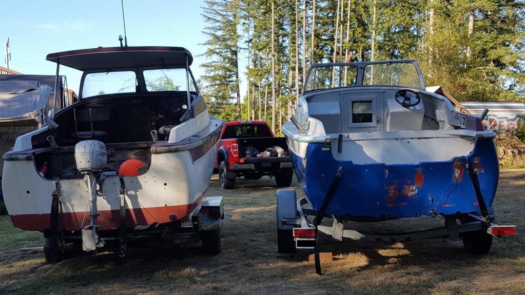

    Hey Bruce! It's an Express, same cabin size and same layout. I forgot to snap some pics of the interior after I spent the day cleaning it. The wood is definitely not as solid as the blue one, so the hardtop will get the restoration attention first.
    Good to know info on the hatches. I looked at a ton of pics before posting that to make sure I was on the right track with regards to early vs. late 58.
    Look at the difference in the transoms as well. While I know they can be modified at any time, I don't see where the blue one has been changed, at least in the width. <disregard that outboard that's on the hardtop...it's a 10hp Johnson>

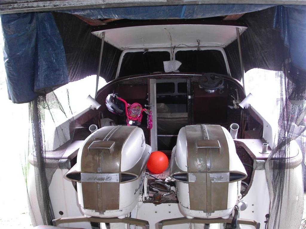

      The blue boat has a more normal transom width in my just completed viewing of numerous 1957-58 20 footers. However, the notch downs are not factory, meaning done by marinas/previous owners. The hardtop boat transom is different, don't know if I've seen one that narrow, but had to come from the factory like that. As a general set-up, these were powered by the twin longshaft versions of OMC motors which were 22 inches. Your hardtop had the twin Johnson Golden Jubilee 35s, like 17"shafts. Tim Jones is more of an expert on these motors. I'll attach pic of your boat, about 8 years ago.
      Our transom was cut down by the dealer to fit a 20" longshaft single 50hp Johnson(fat fifty). Many times this dealer "notch down" alteration was less than factory in quality of sealing and sped up the deterioration of the transom.....

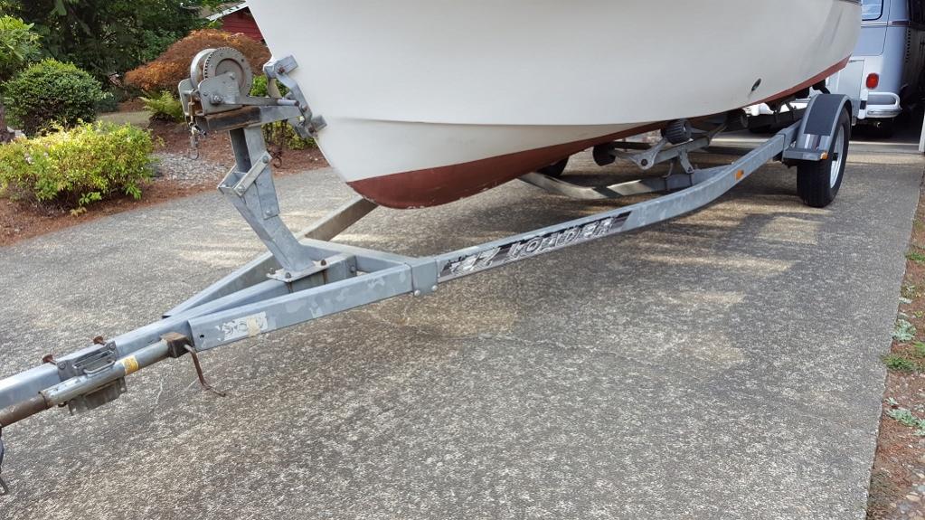

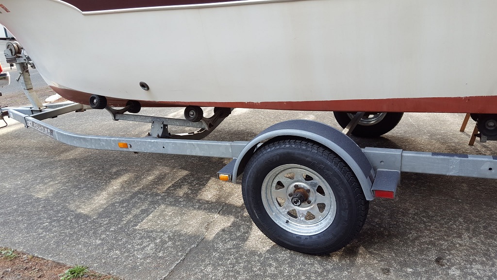

                              Been busy the past few days/weeks trying to get things in order on this boat. It started with getting another boat to get the trailer it was sitting on which means at one point I had 4 boats!!??!! I'm certifiably insane. The good thing is I'm an optimist for the most part and knew I could get rid of the other boat via CL. My father-in-law and I towed the other boat and this boat to the lake to do the trailer swap (that's a whole other story!) and was for the most part successful.
                              I'd say the cool part about the whole trailer bit is the person I was buying it from told me to just take it. Take it? The whole boat and galvanized trailer? I couldn't do that as she was a recently divorced school teacher, so I gave her some cash and told her I would return the next day to retrieve it.
                              So after a little elbow grease and some new wheels/tires and bearings/bearing buddys here's my nearly free trailer:

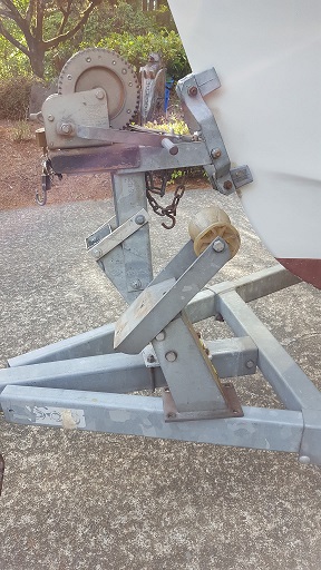

                              oh and I swapped out the winch stand. I picked one up on CL for $20 that was the exact height I wanted as the one that came with the trailer was way too low for my liking. I'll clean it up some more, I just wanted to make sure it all lined up how I wanted it to.
                              Eventually I'll convert this trailer into a bunk trailer as I most definitely dislike roller trailers.
