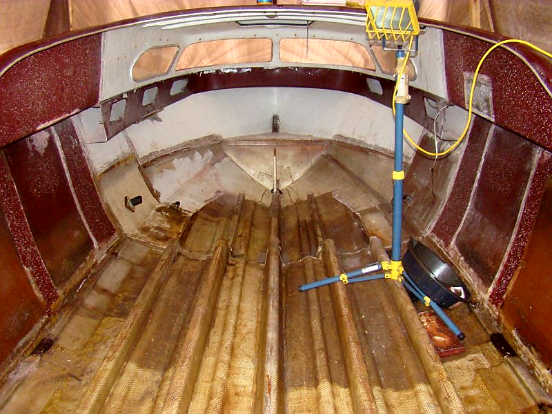

          An empty shell. I'm fairly certain a lot of boat projects end up stopping here and fade away from existence. Not this one! There's still a pulse which means she's still sea worthy!

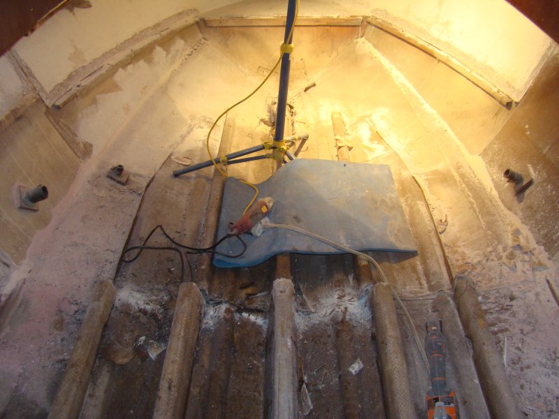

            Wow. Looks like the 404 waay back in the day. Replace those through hulls while you can get to them. Or do like I did, and glass them over....
            • #96
              Good idea John, maybe glassing over the toilet one is best.

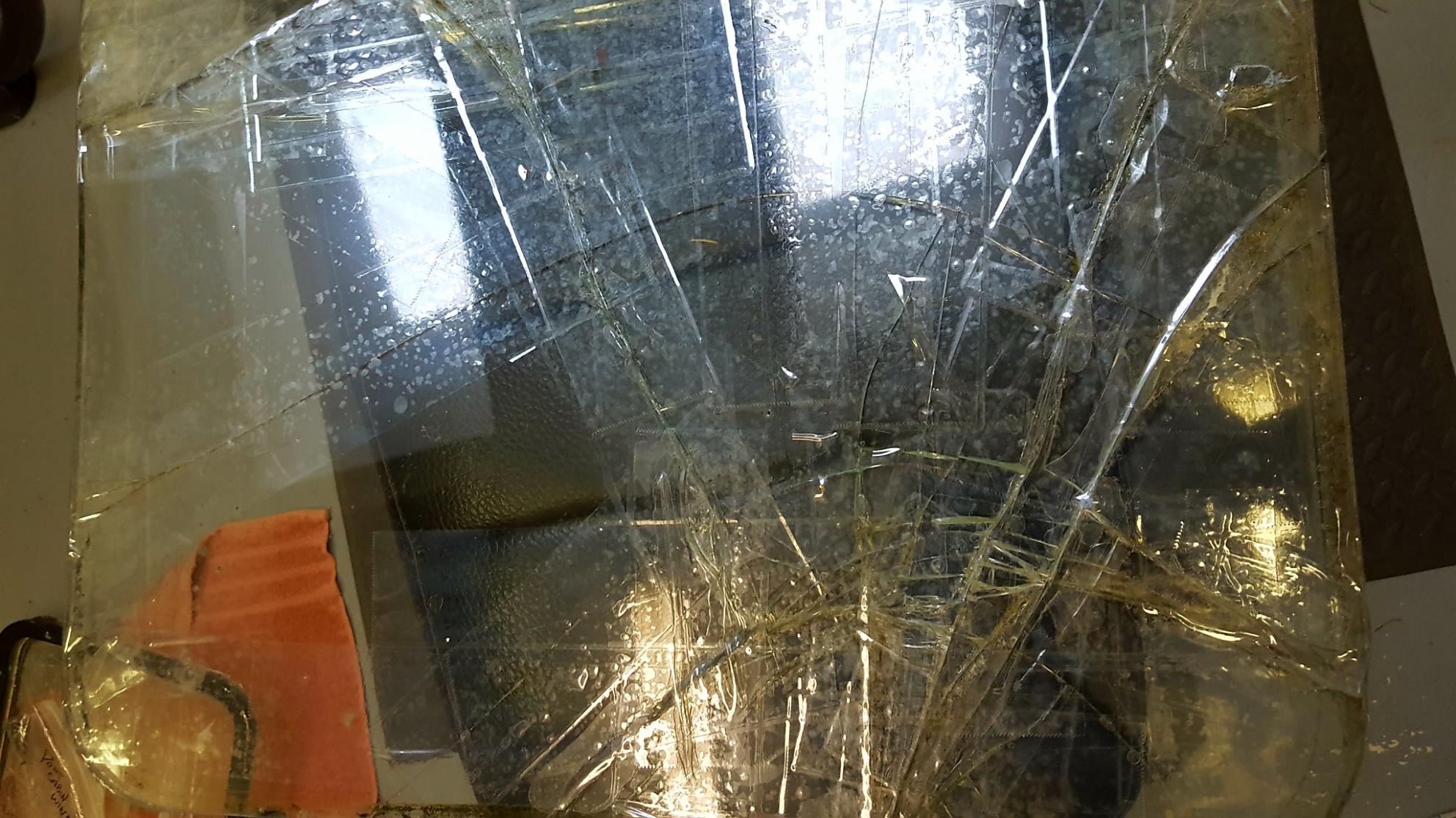

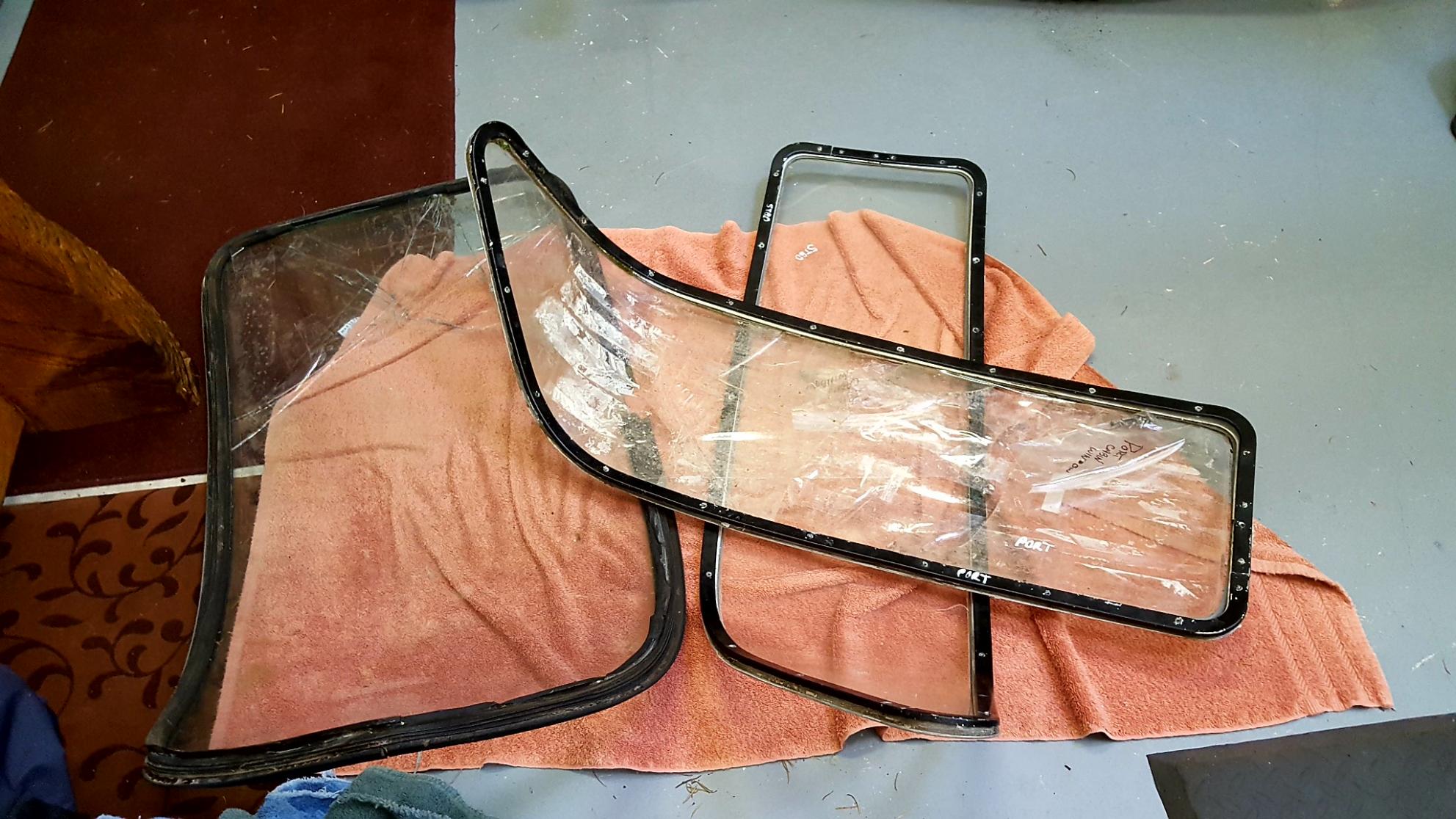

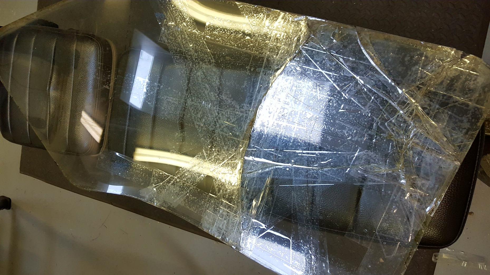

                Well it's time to take the windows to Skip. I had to put them back together and one of them took some work and a roll of tape to make it look like a window again. Take a look...
                • #98
                  Yikes! What a mess! I hope they can be replaced without too much trouble.
                  Kelly, a tip. When I had the 404 down to the stringers, walking in the boat was tricky. I ended up putting some small plywood boards in that I could walk on. Keep em small so they can be moved about and you'll have at least a bit of safe walking space until you get the new wood in.
                  When does the new wood go in?

                    Skip is on the verge of retirement and remaking my windshield (under warranty) might just push him over the edge... While working the boat show this past weekend I met some folks from Tacoma who are also making custom lexan and plexi windows!
                    http://keltech-imagine.com/
                    They have apparently been competing with Middy (Skip) and Taylor Made for decades! Might be worth looking into.
                    • Brian I've been talking with Skip since you gave me his info. Today I took the windows to him and 1 1/2 hrs later I left with the windows faithfully in his hands. I got a quote from keltech back in November and they wanted nearly $400 more than Skip. Once he retires though, keltech is the next best option for sure.

                        • Got it. I remember those days. Laying in the floor was going to be the hard part...Years later and I'm still provisioning the interior! haha.
