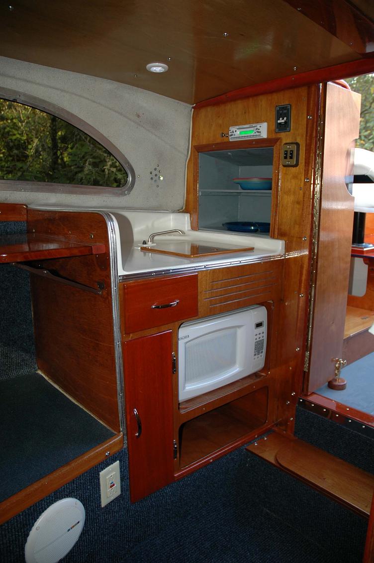

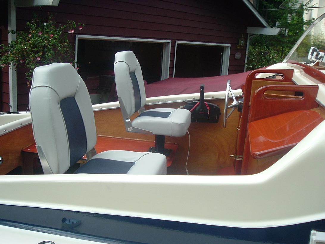

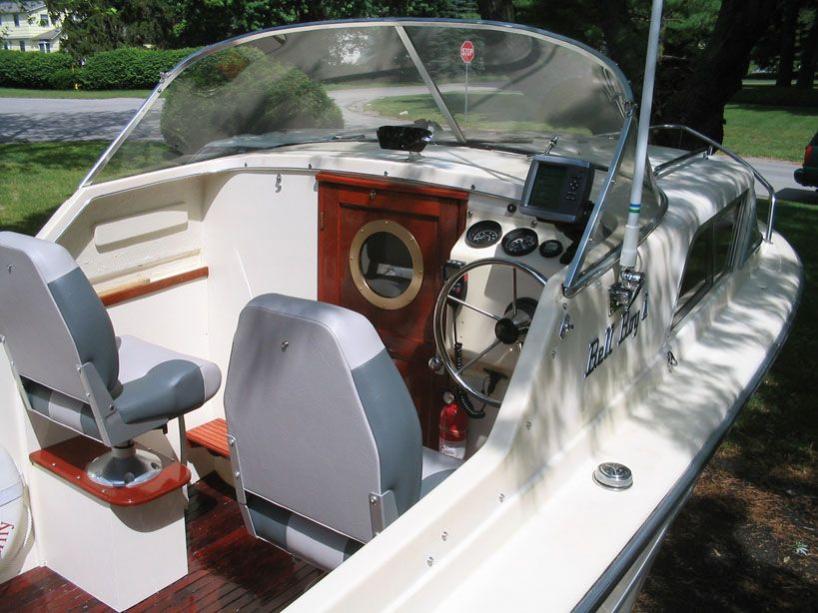

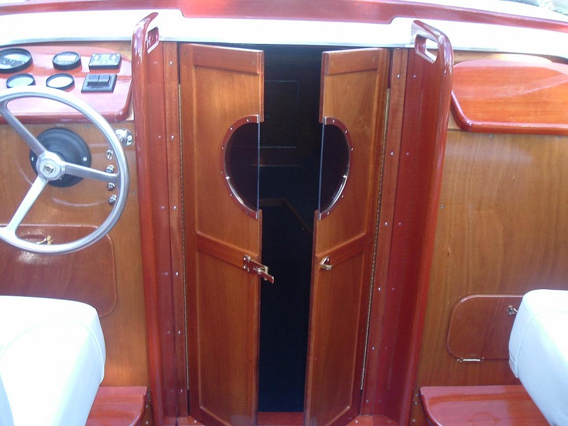

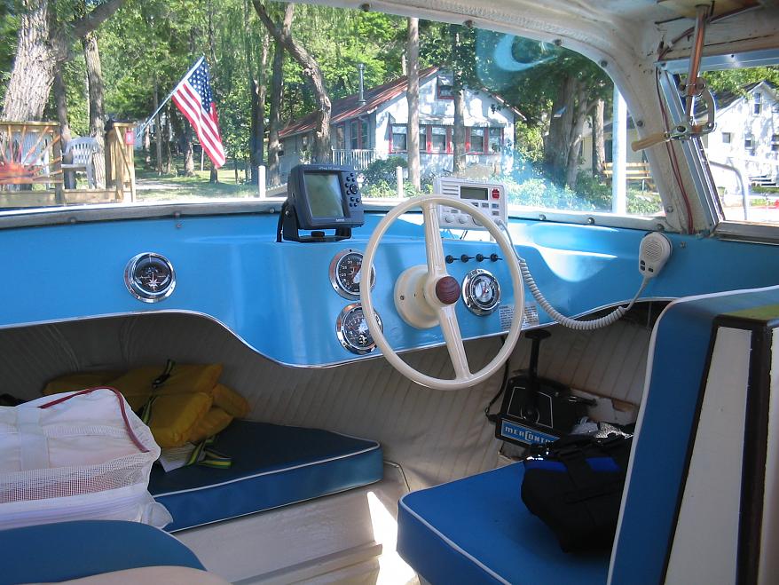

    Since I was able to salvage John's 404 sedan floor and cabin bulkhead, I never had to rip everything out as you are doing. When the bulkhead was exposed after the floor was removed, did the bulkhead sit atop the stringers or was it notched for them and slip all the way down to the hull bottom? How are you planning to replace the bulkhead? In two pieces, left and right? Did you decide on the new cabin configuration? I am thinking of building a helm and companion consul for the outer cockpit of my BellBoy. I will attach a picture of Chuck's Farallon cockpit here. I would follow this idea and then split the cabin door down the middle as he did to open the halves against the consul sides. This would give me more room to flush mount the GPS and radio, plus give me some bulkhead depth to mount a marine radio and speakers.

      The bulkhead was fitted right down to the hull. I haven't made the final decision on the door yet but am leaning towards possibly splitting it horizontally and still using the "pocket door" concept. That would allow me to open only the top half for circulation while keeping the little people contained when my attention is on piloting the boat. I'm just at the point of having to make that decision and figuring out door opening size and placement. I will do the bulkhead in two pieces to keep it simple to install.

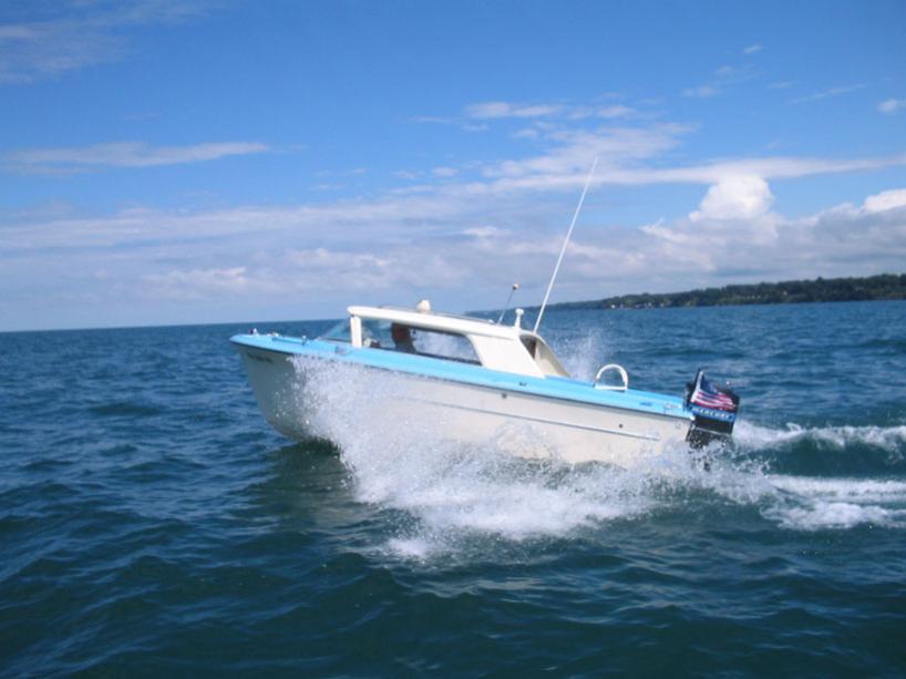

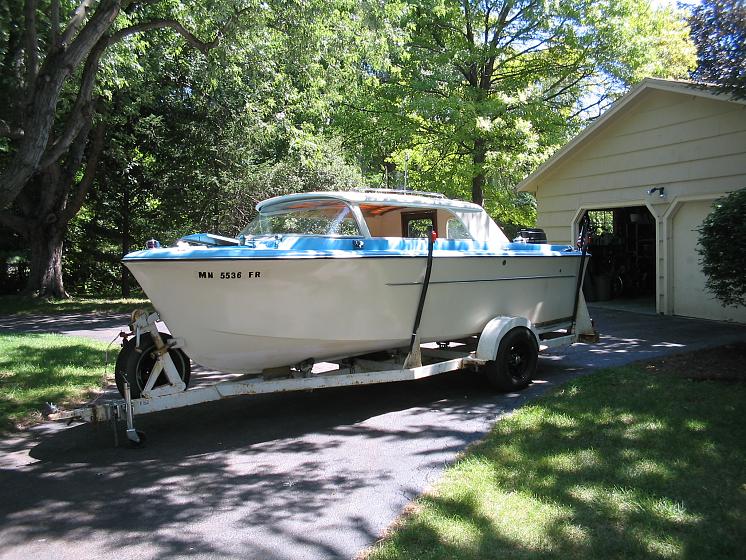

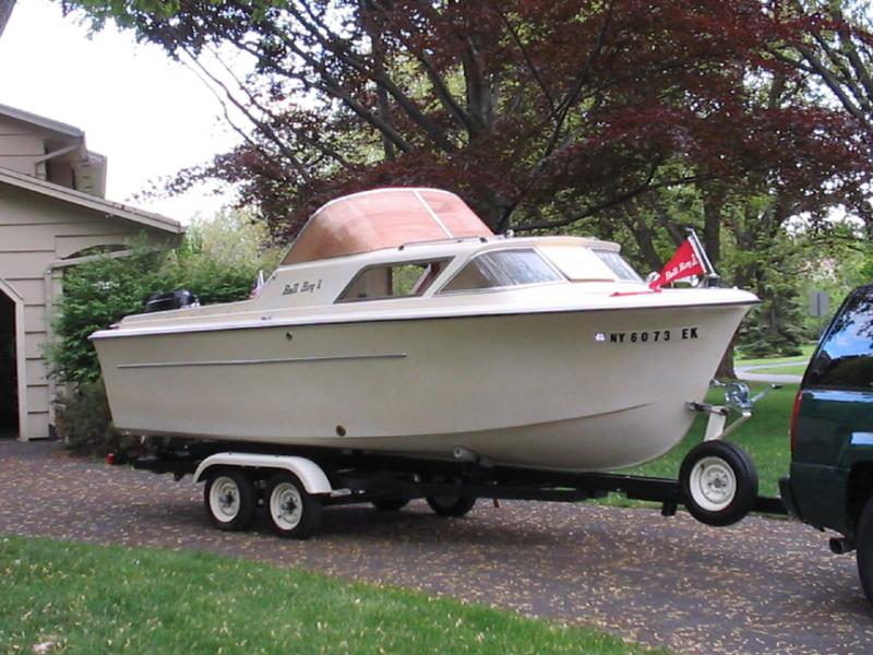

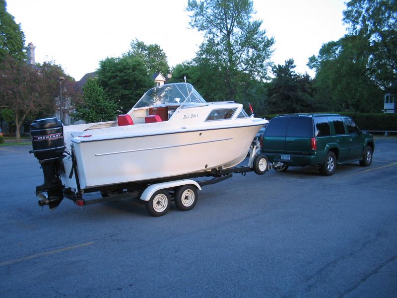

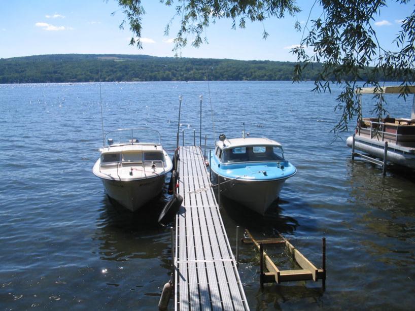

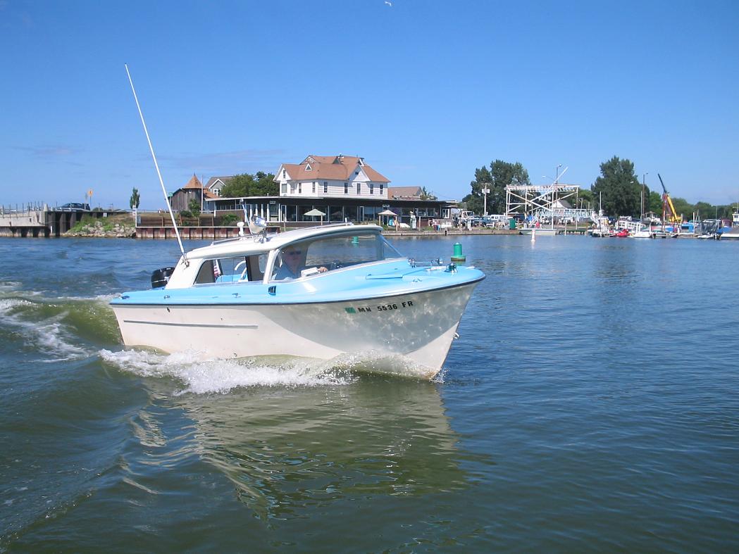

        Thanks for the info. Always good to have as much of that as possible when embarking on a rip out!! I found more pics of the two 404's. Thought you might enjoy...

          Love the pictures. Can you email me the second one (115_1574) so I can print it out and hang it on the wall by my desk to remind myself how great it's going to be once the work is done? LOL Thanks Barry

                  Yes, the BB balanced on a single axle trailer is a joy to manuever around the driveway UNLIKE the tandem design shown here. The tires really scrub when you try to turn it by hand. BBJohn's 404 sedan is on a single and it is a dream. Can you adjust your axle back and forth to accommodate the extra engine? Anyway, just got the new Sony head unit for marine hi-fi and will have to come up with a place to mount it. Not too many areas to choose from that have 7" of depth behind them.

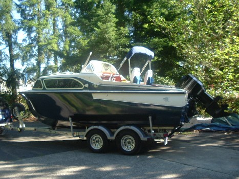

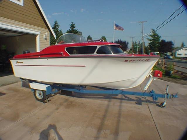

                      If sitting low on the trailer is your objective, I would avoid the Holsclaw design as my BB is perched way up on top of the frame. John's BB is slung quite low -maybe 8" or so lower than mine. Here is a shot of his on a custom designed rig that came from Lon who we met through FGNW days.

                        John's trailer is more like I have in mind only with a tandem set up closer to the stern of the boat to account for two motors. This also makes the wheel base longer and improves the handling and for me makes it easier to back up. Also I'm thinking that ground clearance is not as important if there is less trailer hanging out behind the rear axle. The only thing I have to be careful of is not dragging the skegs on the ground. LOL I am guessing John has to transport with his motor up?
                        I think I'll look into the cost of having some channel bent for my main frame rails and just build my own trailer. Channel works better than tubing for making sure all the salt water is cleaned off after use. Barry

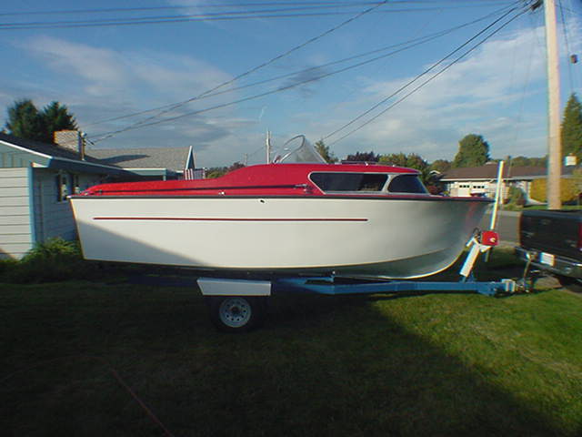

                          I am in the single wheel catagory. I moved my axel back one foot from when i bought it also i have a sway bar setup someone welded on. I to like the security of tandem wheels in case of flats but i put new skins on and will keep a close eye out. Anyway just some needless input on my part.[ATTACH]664.vB[/ATTACH]

                            John, How much does the BB weight. With the Farallon 21' i think with all of the wood that increased the weight. The 1959 brochure say's 2000 lbs. I thought i had better go with the tandem trailer. She weights 3220 lbs boat & motor only and with trailer total of 4240 lbs. Bruce Bidwell made that nice Burguee for me. What a guy ! I have a extra 2000 lbs that the Ford can pull , so i'am ok there.But i don't plan going over any mountains ! Best, Chuck
