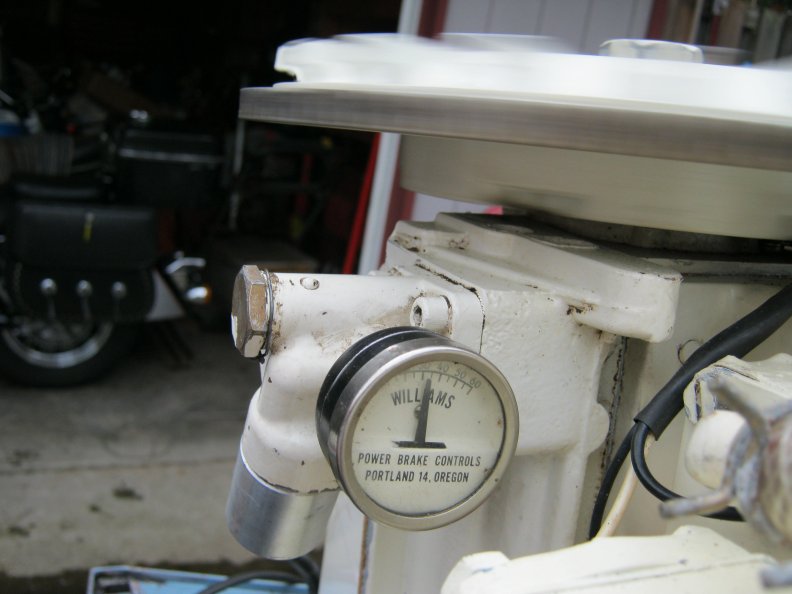

      We have oil pressure.
      Idling at 35 psi and 55 psi at higher rpm at temperature. I spent more time adjusting the valves this time and they sound much quieter that the last time. Cam on, cam off, several times, this is where the distributor got screwed up.
