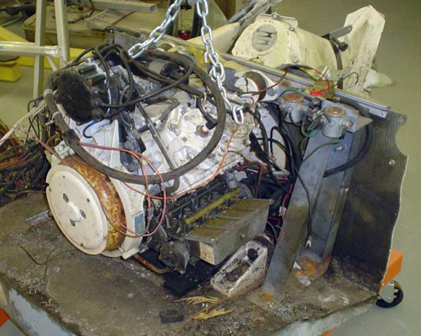

    Although I despise all outboards, I hold a particular disdain for 60's Evinrude Starflite V-4's and their polluting ways. Hours of fruitless wrenching on 4 different examples of OMC's best, in various states of neglect-left me with knowledge of their weaknesses that I swore would never/ever be utilized.

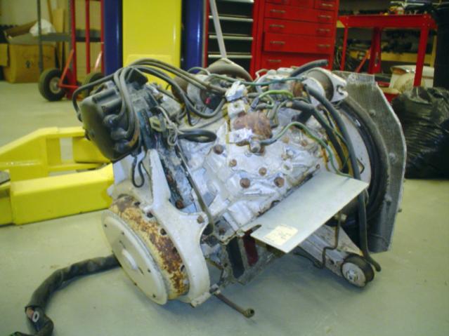

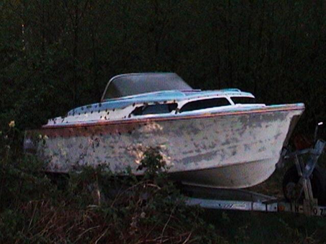

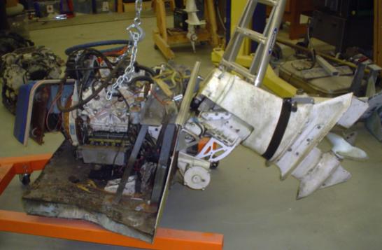

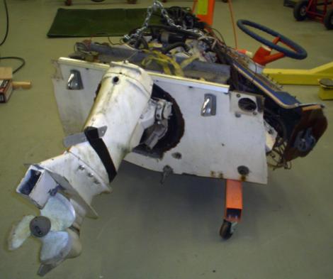

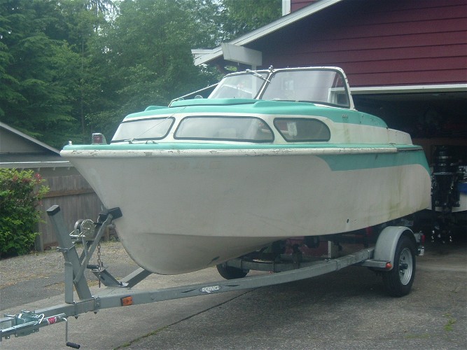

    The chop-top 1957 SkagitRod 17 that is next in line for the custom treatment, was begging for an I/O or jet, but space and weight are a big consideration. Enter the 88hp 2-stroke V-4 inboard that our Commodore excised from Ric's '65 Evinrude Reveler? he is converting to carry an outboard. It's package is very compact and easy to retrofit with the stringer mount and a very good hp/weight ratio.
    Hiding within the existing splashwell footprint would be awesome! A padded engine cover will hold down the ruckus of full throttle operation, and provide a nice place to sit or sunbath. With a little horse trading McCrain and I agreed to trade junk. In addition, another whole '65 Evinrude was located on C/L that supplied a second complete running gear, controls, tanks, and bulletproof deck hardware...CutUp1

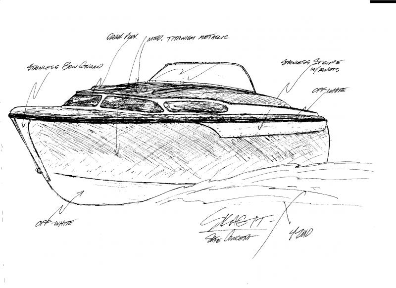

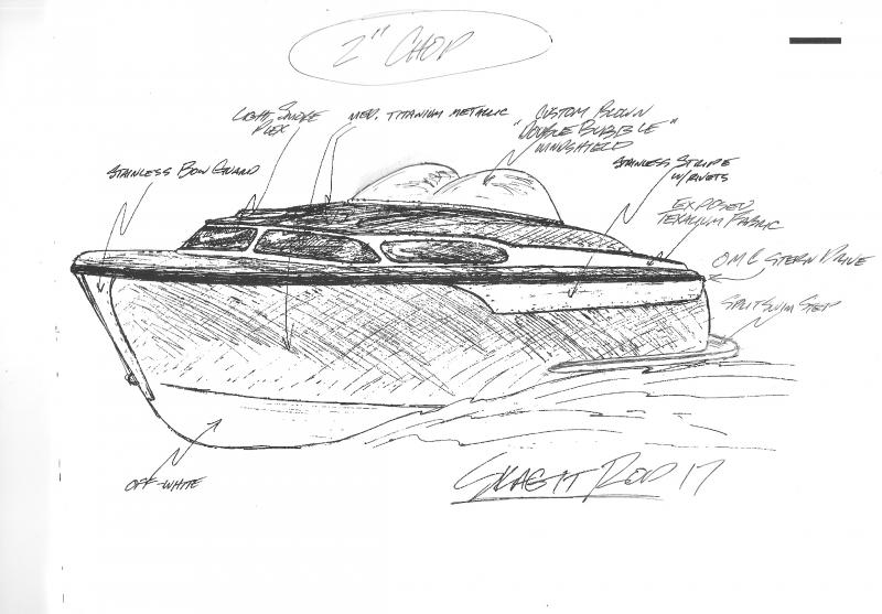

        Great drawing, Greg...and good luck with the i/o package. (The Commodore apparently did some research before swapping the OMC unit for 'junk.')

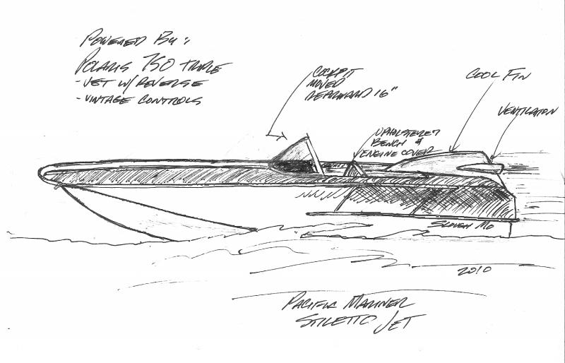

          I did consider twin V-4's for a brief moment Gordon, besides the reliability issues Marty mentioned, we would need a Boeing refueling tanker to feed those hungry carbs. If fuel costs were no concern, I would've dropped in a 460 powered jet pump with over transom headers. Have to admit that option still makes me
          Since my predilection is to modify rather than repair, Tim is going to make sure that everything is in order and ready to drop-in. While I concentrate on customizing the hull. Besides the 2" chop top, a delta pad is planned for the keel, a one-off deck hatch/brow for the cabin, dash and transom mods will keep me running this winter.

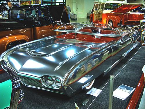

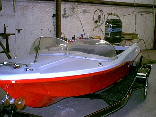

          Thanks to a link posted by StrayCat(Lon) last year, I am working on building an oven to blow a plexiglass split bubbletop like a custom show car from the early 60's. With any luck the resulting bubble will be cut to form two windshields: one for the SkagitRod and a second for the StilettoJet.

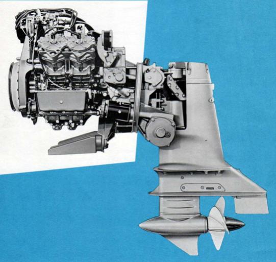

            With two nice V-4 sterndrive packages to mess with, we are choosing the best components to assemble a "bulletproof"Screwy1 powertrain. For all of the negative feedback people have regarding the 2-stroke ball-drive stringers, if used as intended, you can't beat the well engineered small package to open up some usable space lost to the splashwell. Plus, the sterndrive lift motor works great and will be very handy for a one handed gimp like me. I am planning on using Amsoil's 100-1 synthetic premix to hold down the smoke, so my conscience and sweetheart will be comfortable.

                    I ike the Evolution of the windshield.....it now has two rather distinct features that are sure to please most eyes.

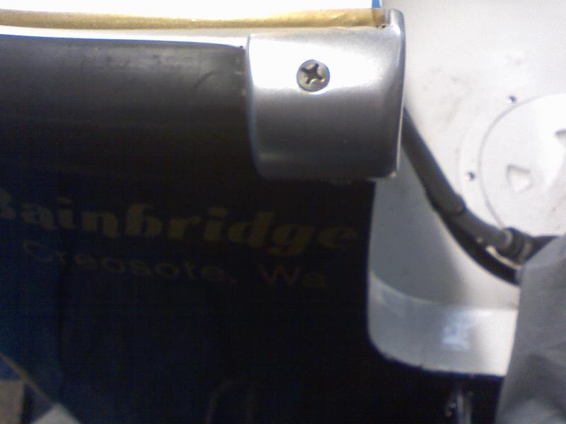

                            Slo Mo, i did notice and it's about time ! And how do you like my new camera ? Just got the rubrail end caps back from the chromer....super good price. WoW what a nice job! Speaking of Skagit-X project, there might be something coming up in about three years from now. It is just waiting to happen, but in the meantime i'am going to enjoy the Skagit 20 and G-3 until then ( not going to sell them ) and one other thing i will have to check out things as far as my age goes then, being i will be about 73 and when It's done closer to 74 or 75.....OMG ! Maybe GregJ and i will be in the REST HOME. I know he will for sure..... Chuck
                              Looking great Chuck-I heard that your homeport of Creosote, Washington is a real happening place!
                              P.S. Your new camera still has a dreamy haze, I think DaveC must be right, that uber-rich 2-stroke smoke gets on everything.
