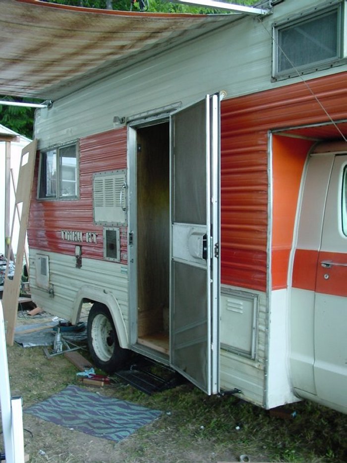

Huh,
seems that the door feels weak too. Better check into this.

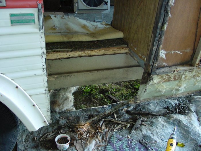

I
found that the right rear has been replaced at one time. This is good
but the front sure isn't going to last very long looking like this.

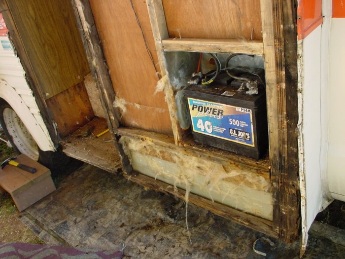

Hmm...This
sure won't work. |
Crap,
Look at this. Not looken good here, this needs fixed too. |

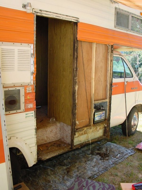

This
was not easy to get out. What did they do, build the RV around the step,
Wow. Lots of sheet metal on the back and sides of this. |

Looks
as the top part is ok, but I am here so I may as well rip it all off
and do it right.
I even rebuilt the battery box. |

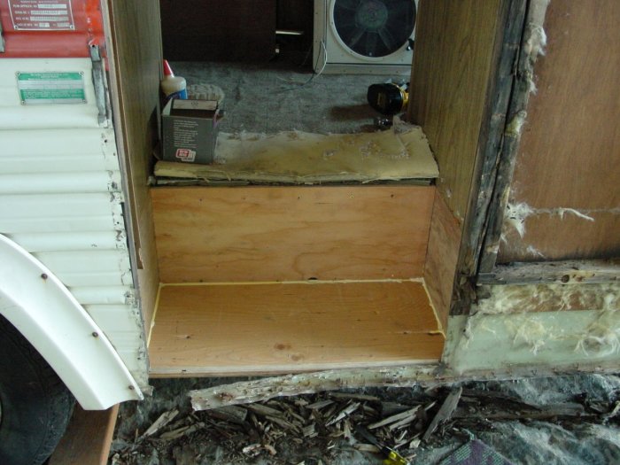

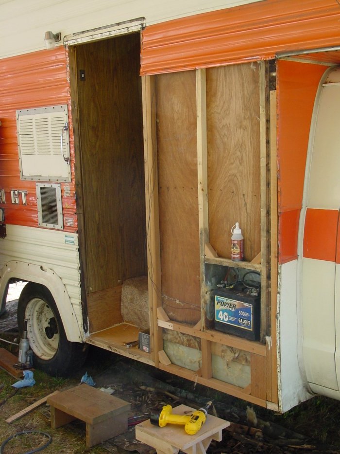

There.
That will work, Good and Solid with a new door frame too. That batter
box is sure not going anywhere soon.
Good
old Gorilla Glue. |
Now
I can Jump on this sucker, All 218 lbs and it doesn't move. I think
this will work.

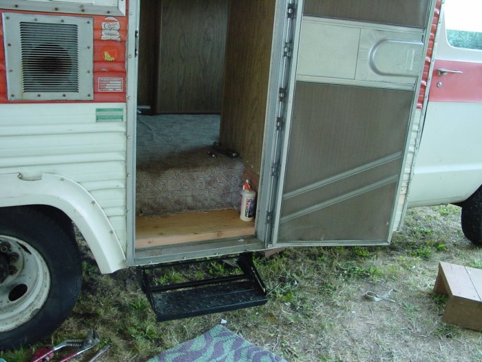

Well
now. The whole Right side is now done, solid as a rock, sealed, undercoated,
yep, I am ready to go back and work on the rear end |
Boy,
that was dumb. It seems as there is a little lip at the entrance of
the door. Just something for me to trip on it seems. Hey, I can build
a little Hidey box and put on the first step.
