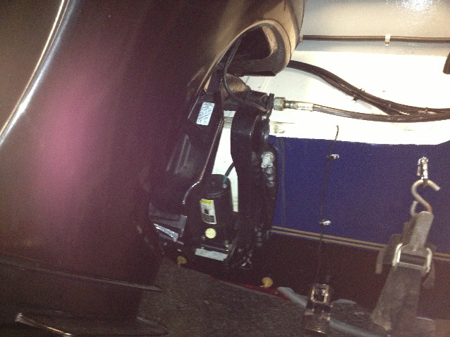

      I my Skagit 20 offshore I have a early set of electric trim boards (looks like a heavy duty automotive heater motor and works the trim boards like a screw jack) and of she is riding a little too rough, I just slow her down or use the trims to poke her nose into the water.

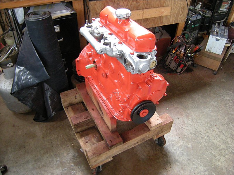

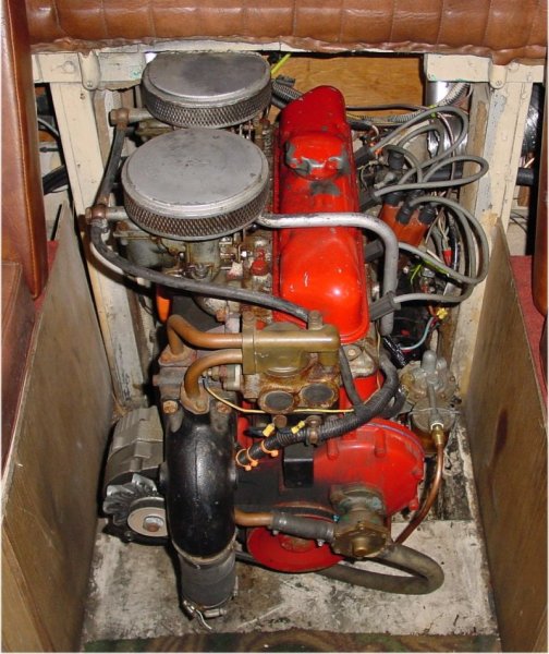

      I see were some would add weight to the bow to help keep the bow down for a better ride. She has a B-18 with dual weber carbs and is said to produce about 105hp which will push her along at about 28mph if pushing it. She has too much extra added weight to her. I will cruse with her at 15mph all day and she just sips fuel.

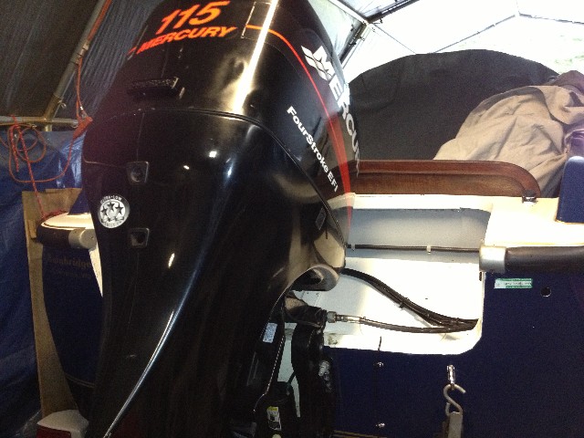

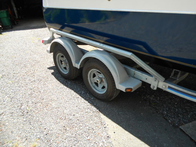

          Thanks for the in depth replies. It helps explain to me as well the challenge I'm having with balancing my Skagit 20. It came with an old Johnson 70 which amazed me because I couldn't believe that would move it. I currently have an older merc 90 2 stroke on there but with that on the back I have very little weight on the tongue of the trailer. As a matter of fAct on my first sea trial with that setup the whole thing popped off the hitch on the way to the boat ramp and gave me a scare of a lifetime (luckily I live closeby and was only doing about 15 mph at the time). Anyways I have a 90 four stroke Yamaha I want to use but am a bit worried about the weight. What do you guys power your boats with?
            Addressing only the boat tongue weight should be a high priority, unless you have handled it already. A little shifting of the trailer axle position while using a bathroom scale should take care of that.

                Like I said, my 20 offshore has a B-18 in it and I see were the 58 I had came with a B-16 with the Volvo Penta outdrive. Those would scoot right along and were 80 to 105hp.

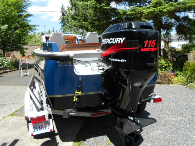

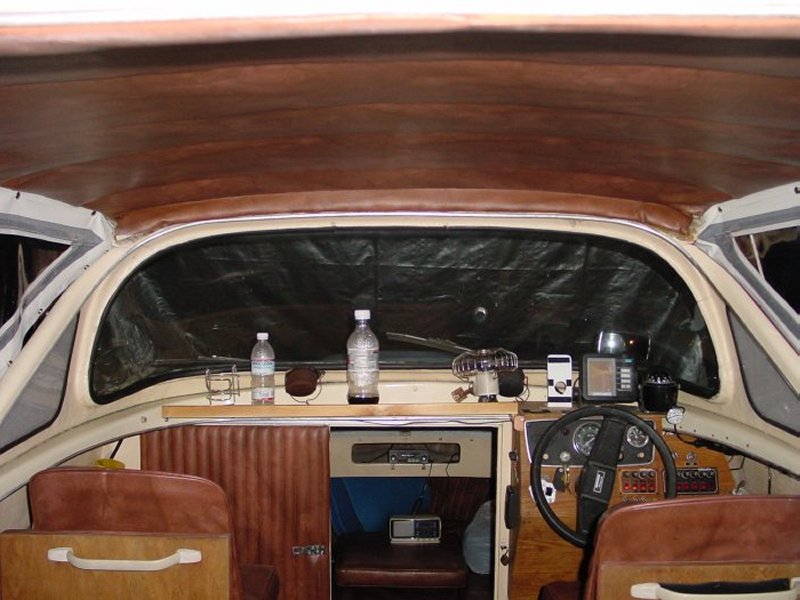

                  My Skagit 20' has a 2004 115 four stroke Mercury ( Yamaha ) with a rebuilt 2 1/4 thick transom. Never have had any problems with it porpoising at any speed. I really like the T/T as far as leveling her out as you go along and lowering the speed down and still being able to stay on a plane.The Dorsett 21' Farallon i had before the Skagit 20' with a 150 hp 2 stroke was very hard to level out even with Bennett auto tab$ at around 24-28.The only way was wide open to get the bow down so you could see ahead. On the Skagit I do have 2 -12 gal tanks up at the cabin bulkhead and a 28 gal in the stern ( i use that fuel first and then switch to the two 12's as back up, I fill them up at this time of the year as gas is cheaper and add the gas treatment and that will take me thru Spring/Summer next year when prices are higher ) and runs fine at around 35 mph but i usually run 24-32mph depending on the water conditions. As far as the trailer goes,it does a great job the way it is set up with the dual axles set back towards the stern. Luv that trailer and great to back up !

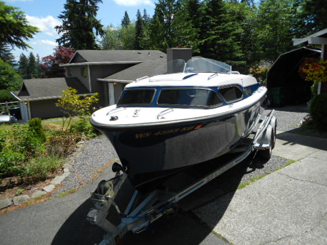

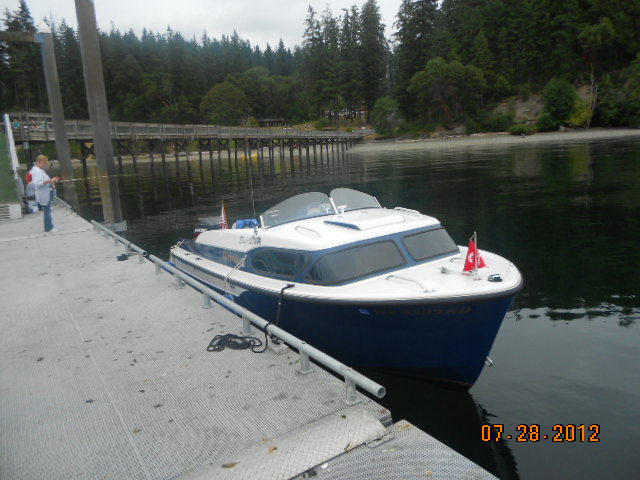

                    Thanks for the replies - its great to see the photos of your Skagit - what a looker! I'm curious about your windshield up top. It looks custom and a bit smaller than the original ones. Was this just a style choice or does it improve your ability to see? I do find that with my hardtop I feel like I'm flying blind at lower speeds. Sounds like trim tabs are one way to help counter that problem but I also wonder if removing the hardtop would help

                      On the Hard Top, mine has the same hard top. I used to ride Harleys year around (yeah, I grew up and grew old) and to be totally honest with you, Do not like the Rain or getting caught in it. I realize I am in the Pacific Northwest were if you don't like the weather, just wait a few minutes.
                      I like the idea that I can Zip her up if I happen to be out or if crabbing and the weather is crap, I am still able to get under something to help stay dry. My cabin is also heated which is a plus. Got to pamper the old guy

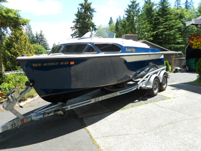

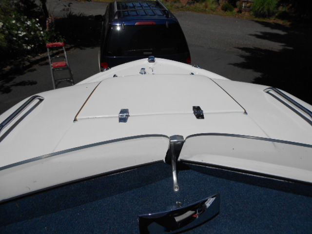

                        Chris, When i got this boat it had a windshield somewhat like it has now , but just a little bit different. I replace it with this one. Back in 2003 a friend ask me if i wanted to buy his low styled windshield for my 1957 17' Skagit that he had on his 17' Skagit. Well the price was real right compare to buying another aftermarket one for $350.00 ! Save your money on tabs ! With that 90 four stroke Yamaha you have T/T that should be enough. I have heard that your motor is about the same basic motor i have so that should be fine ,but i would beef up the transom something like 2 1/4 inches thick or whatever you call it in Canada. LOL
                        Here's the "Pro & Con's"
                        Pro's....I like the looks of this so-called sporty looking windshield ( that's just me " ) If it had come with the original i would have left it on as that can be a whole another story about the orginal being mess with like trying to put new glass in them at the tune of about $1300.00 plus. That in itself can be a nightmare ! Towing the boat down the freeway there is less draft on the windshield that the original one by far.If you want canvas over your head get a bimini like i did on my 17' Skagit. With the Bimini there is not a major problem with the rain.I like to see the wide open sky. I see you have a hardtop , so that should take care of any problems.
                        Con's..... With this style windshield you do give up a few things...You cannot snap canvas to the low windshield.If you want to inclose the cockpit with canvas more or less as you are out of luck.Once in a while you can get a lap or face full of water when the waves are about 4 ft plus high. I hope this helps. Do you have any pictures? Chuck

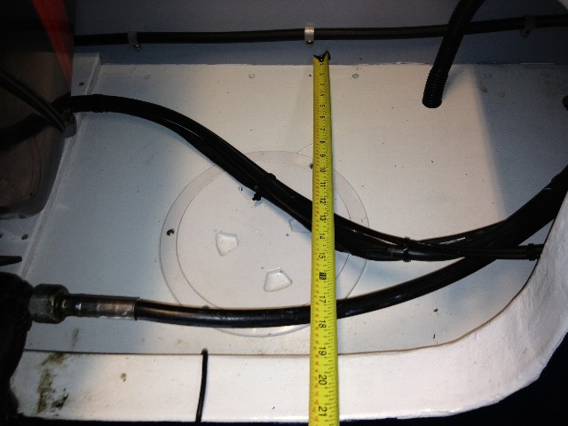

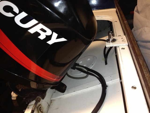

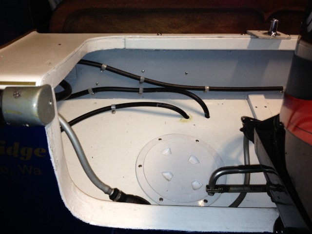

                          Love the photos. Helmar your side seating is a pretty cool layout and Chuck I am amazed at the paint on your boat (I'm assuming its paint anyway). I did build up the transom to 2 1/4" when I redid it this past winter so it should be plenty strong. Have a funny story about it though. The original splashwell is pretty narrow and I found I couldn't trim my motor all the way up so I thought I'd just raise it up a bit while I was redoing the transom. I never thought too much about what this would do to the prop because it still hung below the keel and I figured that would be enough. This summer when I took it out for its first run after that work it drove out of the Harbour just fine but as soon as I tried to build any speed the prop would come thrashing out of the water! Talk about a bonehead move. I had to go back and cut into my beautiful sanded and finished transom and notch it out to lower the motor back down. Also had to fill and drill new holes for the motor. Net result is that I rode my boat for one day this past summer and now it's back under cover. I also need to figure out how to cure the splashwell problem. Chuck it looks like yours might be a little deeper - what did you do to solve that problem?
                            Chris , First of all, i can't take credit for the structural rebuilding of this Skagit. Marty Loken at Island Boat Shop up by Port Townsend did the work for the former owner Bruce Drake. The first time i saw this boat was back in 2003, In later years ( about 2008 ? ) Marty put in new bulkheads,cabin, etc. What i did was paint ( Interlux brand with a 7 " felt roller ) ,new hardware,carpeting the complete boat , cabin door that Marty made, etc. Bruce did a lot of the wiring.The transom is 20" high. They did slant the splashwell up some i think to make it possible to fit the 28 gal gas tank under the bench seat / splashwell. Never have had any problems in tilting the motor up or down while under way or transporting on trailer. The only thing i have to look out for is when i tilt the motor up after putting back on the trailer is to stop before it gets to the flag holder bracket. Chuck
                              Thanks for the photos chuck - I'm going to go and measure up mine to see how it differs and will report back
