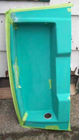

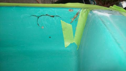

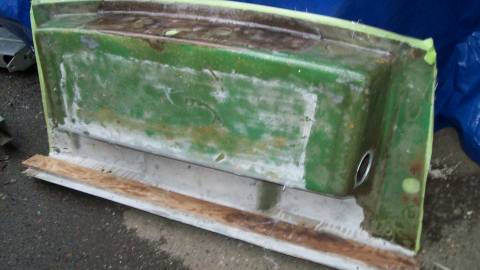

                          tim is that the glassply spalsh well? it looks just like the avalon i picked up few weeks ago we are gonna replace the transom it's pretty bad.
                          unknown year 10ft hydro
                          • #28
                            Ron ,
                            That was a "Trailorboat" that I drug home for $50.00.It was a Balsa core bottom with no stringers and had a rotten transom.I opted for the Hack method and cut out the thin splashwell out with two cuts in each corner that were later doubled up with a patch of woven roving from below.
                            The boat is now moored on Lake Union and owned by the diver,BJ, who brought my Seafair up from the depths.........
                            Without removing the top shell ,you either get serious and cut,or pc it in which is never a good thing.....
                            Glasspars all seem to have a serious curve to the rear so it takes good Hull blocking and some "Lofting" type measurements where you check numbers from X + Y lines you get to try to create from nothing.
                            You`ll also get to use thinner wood in many layers so it will even bend.
                            If you DO remove the top shell,then you get to hope you have it right as you will find the curve may have changed as you assemble the top.
                            A cross brace and template of some sort may help or just be careful all along the way.
