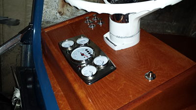

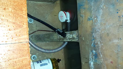

      With the boat back in the shelter, I set to work on the dash. the switch holes were drilled last weekend but the switches needed to be secured. I received 2 switch covers, bilge and spotlight, and had all I needed. I even managed to wire up the horn and bilge pump. The bilge pump was necessary, as there was probably 2-3 gallons of water in the boat after the very wet speed runs. She works great and ditched the water in short order.
      Sunday was spent doing electrical routing and wiring. It's one of those jobs that takes a LOT of time but looks like nothing happened.
      Here are some shots of the dash with everything all tidied up. I'm very pleased with the look. Also one shot of the bilge before I pumped it out. There are two chambers to port and stbd of that space that are open as well...

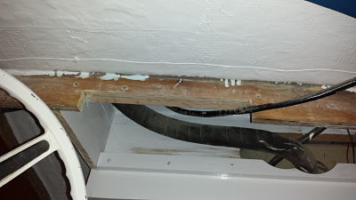

          I have been doing some wiring, though. I have the horn and stern light wired up, the secondary bus fuse, and some misc things. I've also sorted out the fuel pick up issue on the port side tank. I've since drained both tanks so I can work them easily when constructing the braces and paneling - more to come on that!
          This week I am working on re-enforcing the wood under the bow which has rotted under the light mount. Also, I've prepped and am ready to place wood on the gn'ls for my down rigger mounts. I'll be mounting all 3 pieces of wood tonight with thickened resin and then glassing them in tomorrow or Thursday.

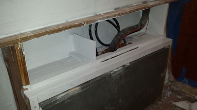

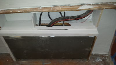

                                The last few weeks have been spent building tank braces. With the bulging that the tanks do when loaded, we had to come up with a sturdy solution to keep them in place so that the seat boxes can be positioned correctly. With the 1/2 inch ply, we've lost 1 inch of deck space; not bad!
                                During this project we were able to fill the tanks to capacity and confirm that my outer measurements were good. 20 gallons each. 40 gallons is a lot and I'll probably only run half full most of the time to save elevated weight.
                                The panels were tough since they are both (top and bottom) trapezoids. Not exactly easy to cut out! With careful measuring, overcutting by 1/8 and sanding, they are all an exact fit. Stain and varnish are complete on all 4 panels and they will go on this weekend. Pending items are positioning seat boxes and drilling for electrical (LED lights in the openings). Once that is done, they'll go in. They were designed to be removable, but in practice I think only the top ones will be accessed with any regularity.
                                In the next few weeks, the aft seats will be installed and final electrical wiring completed. Additionally, there are many little things that I will try to get done. However, with seats and electrical in place, she will be a fully functional boat and ready for the summer.
                                We are planning a launch party for the 2nd Saturday of June (14th I think). That's just 4 weeks away! Christening ceremony and generally hanging about with friends. More than likely we will be on the hook around Keyport, either opposite the tenders, or to the South towards Brownsville. If not there, then buzzing about between both of those points and Bainbridge Island. That is our favorite playground as the waters are very protected. If anyone is interested in popping by, you are MORE than welcome to hang out. There will be boats aplenty, assuming the weather is decent!
                                Pics are of panels, tank braces, and seat boxes with painted interiors. I'll post more when the seats are in.
