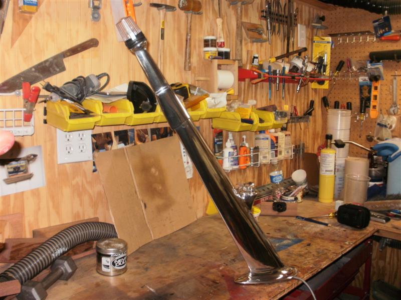

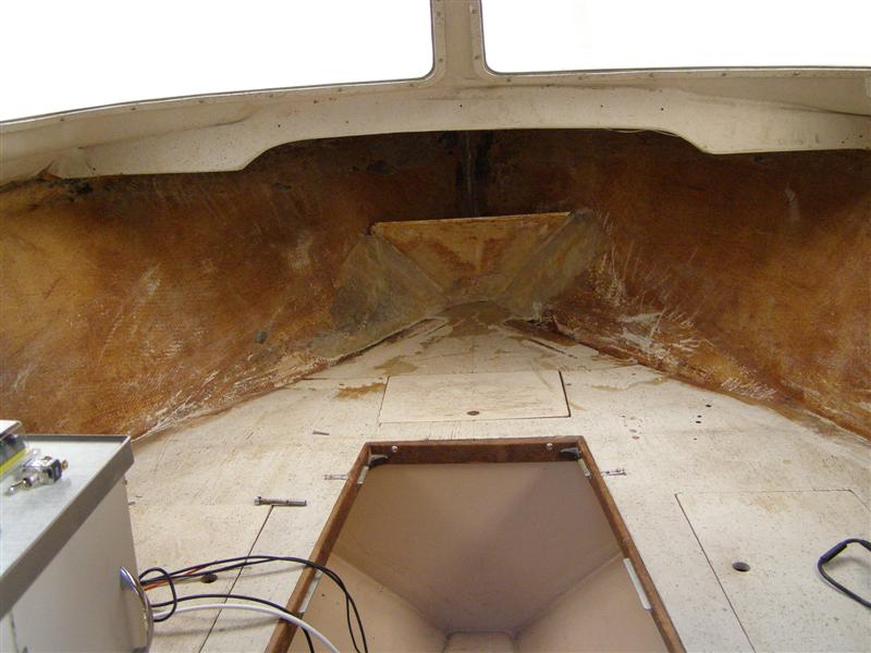

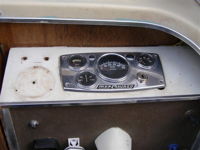

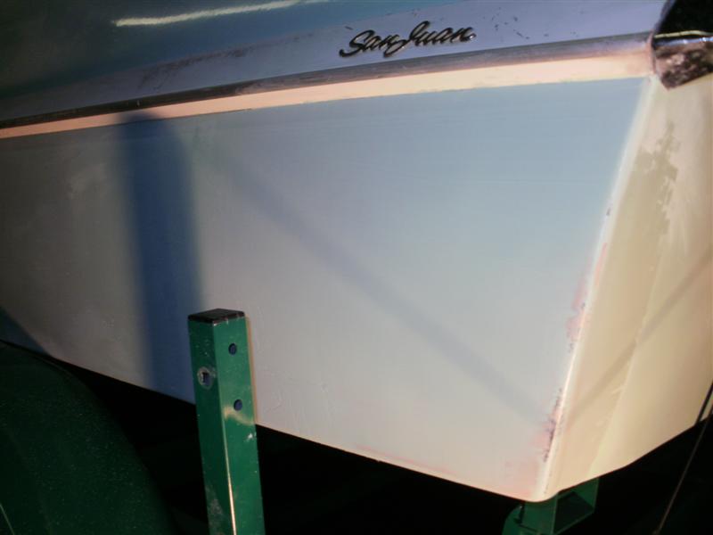

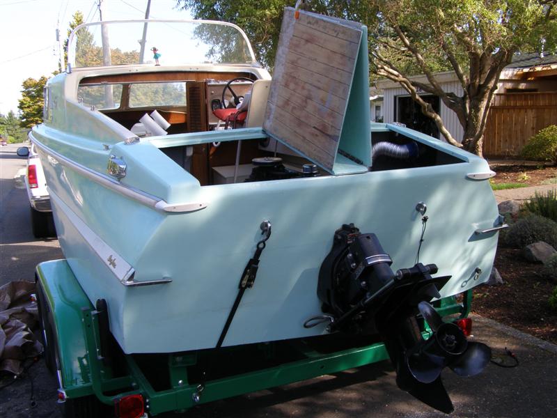

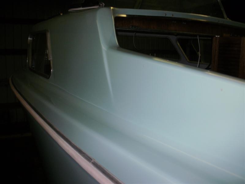

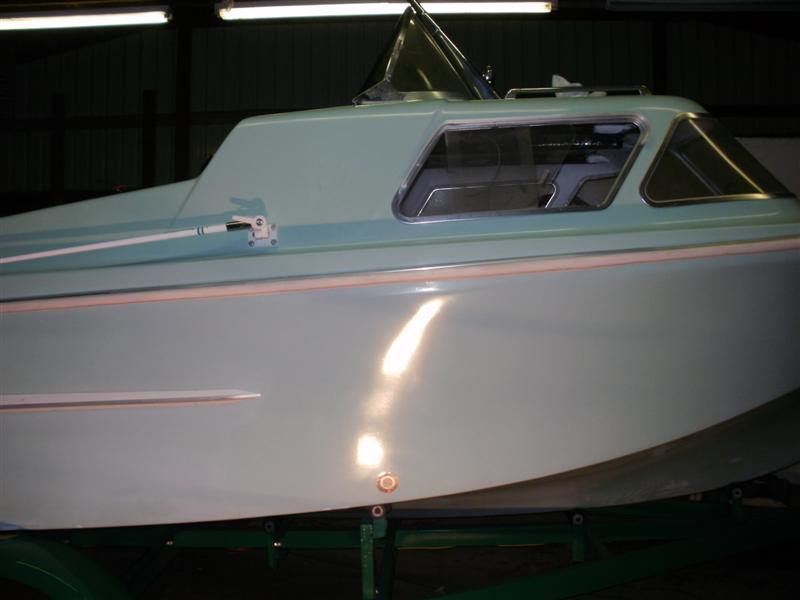

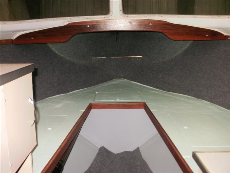

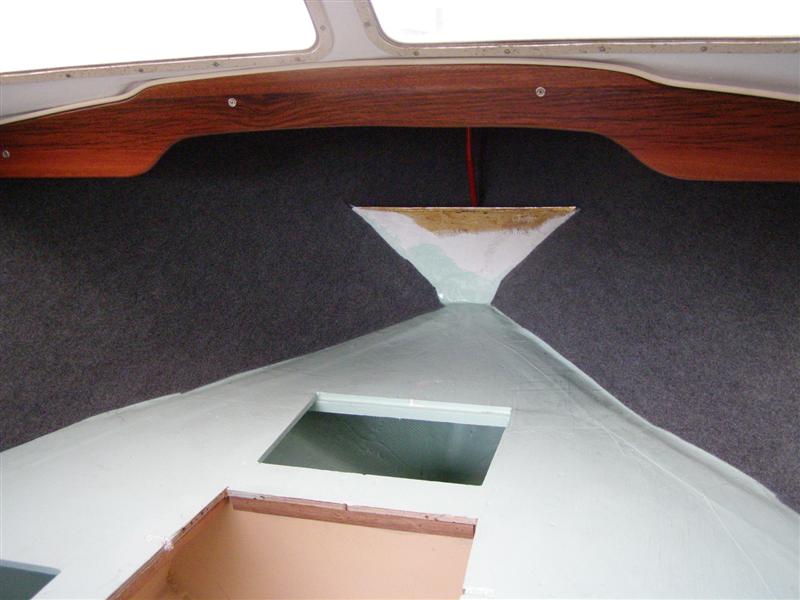

    This is what I've been spending my time on and kind of left the Falls Flyer to rest. Stripped the inside and re built the wood work and new paint , carpet , did some dash work and now I'm polishing the gel coat and filling cracks and gouges . Took most of the Chrome in to get plated and I got some color matched Gel coat from Fiber lay works real good covering up the minor imperfections. I've been making a paste of "Fumed Silica" and gel coat for filling and I'm using 3m Polishing compound and 3m Finesse for the polishing, Removed all the white paint around the cabin so the boat will be one color (For Now) had the mast polished and it looks like brand new. Should not take much longer to get her back together then its back to the Flyer. :boater1:

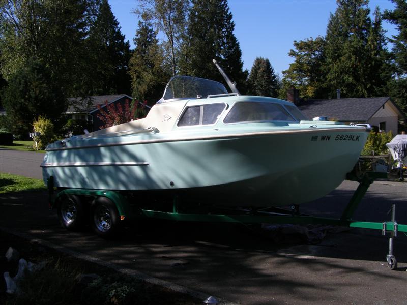

    Here is where it's at as of today

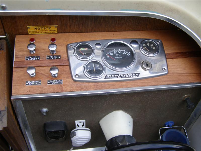

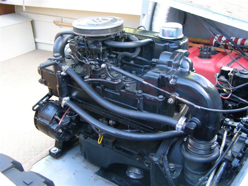

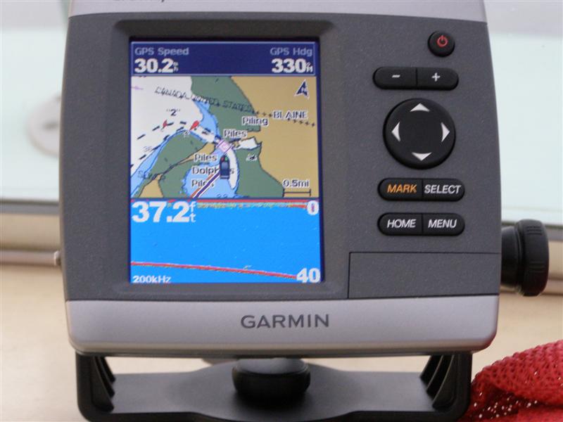

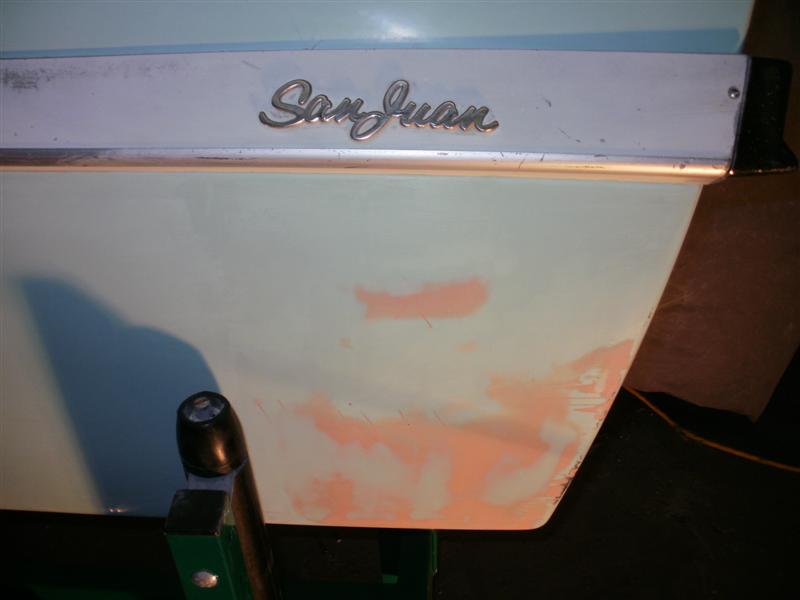

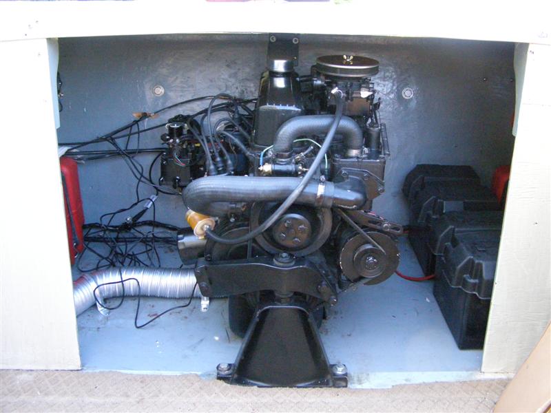

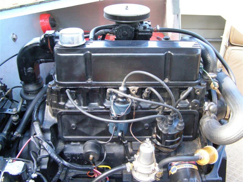

    Here are some of the photo's of the polish and the engine . Have one big repair to fix on the rear port side , just about ready to put the final coat on that. Should be all ship shape for opening day !! That G.P.S. shot is a trip out to Patos and Sucia cruises real nice at about 23-25 but get up into low 30s when needed. Nice having an inboard that just nuts and bolts and no computers. Looks real nice on Lake Whatcom

      Looks great Rick. That engine looks clean enough to eat off of! Love the woodwork on the dash too, really made a difference.

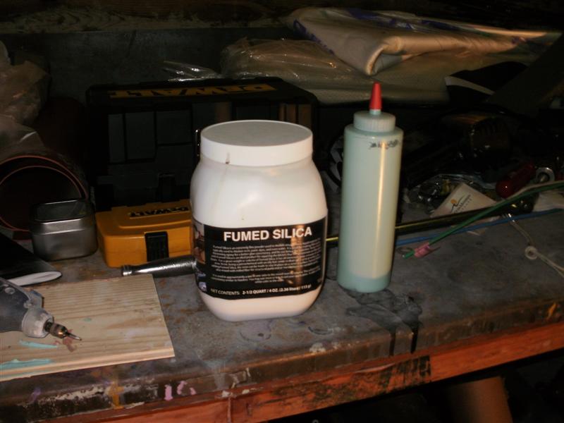

      Can you share some details on the gel coat / silica mix and how you went about getting the color-matched gel coat?
        Gel Coat

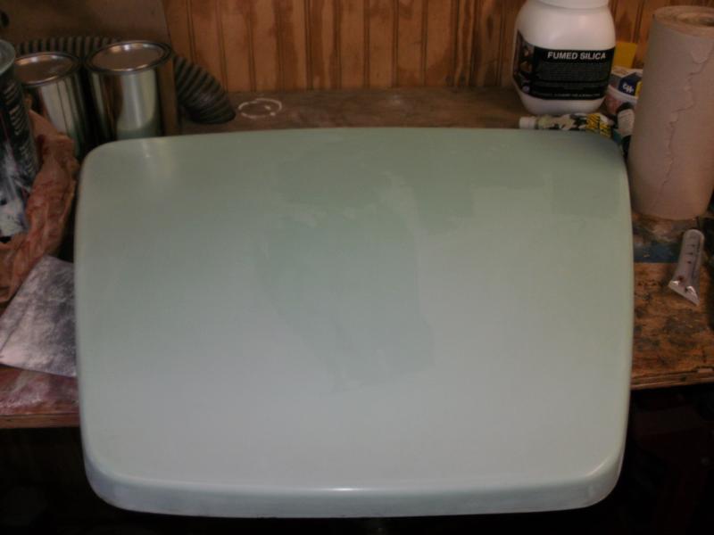

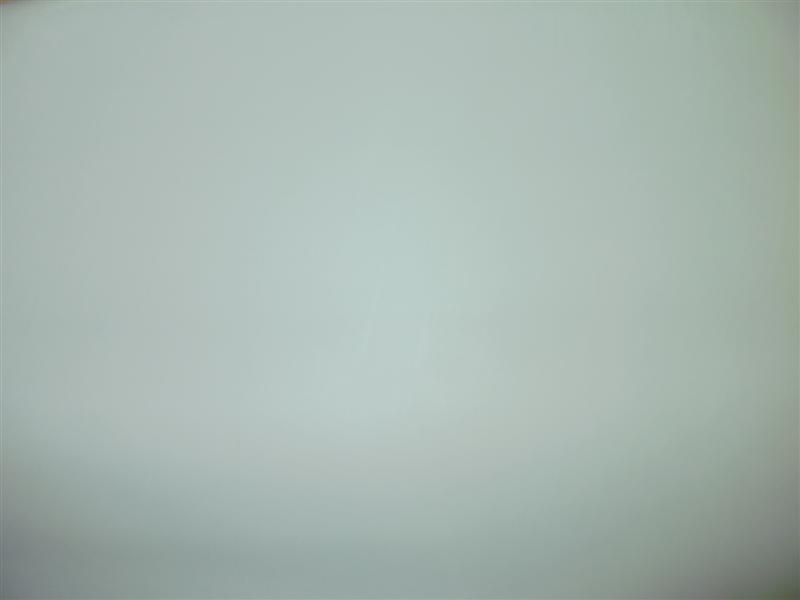

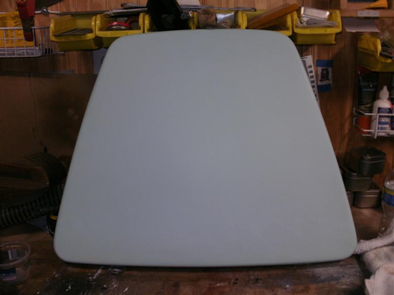

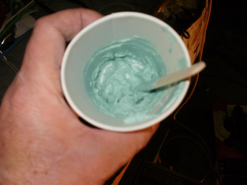

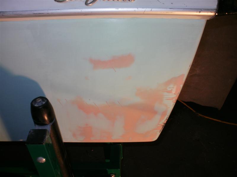

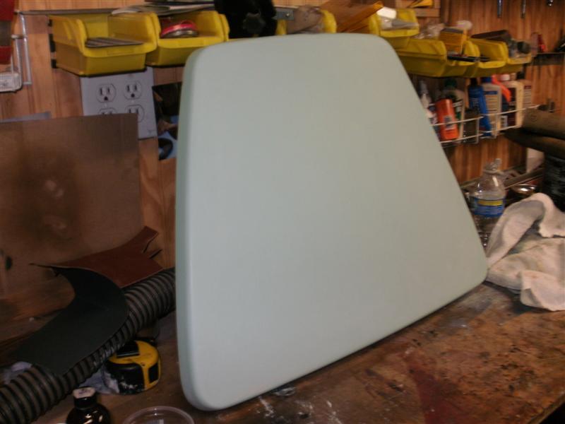

        I took my hatch cover down to Fiber Lay on west Marginal way in Seattle and they use a mass spectrometer just like at Lowes for house paint, it takes a few days to get it so don't expect to get it while you wait. They will ship it to you when it's done. They also sell all the Fiberglass accessories for anything you need to do. They are just down the street and over from Crosscut Hardwood so it makes a great day trip for me. Fumed Silica is just like the Christmas tree flock you used to use for fake snow. You mix the Gel coat and the Silica in a small cup add some wax and last thing is some Hardener. I have a few more patches to do and I'll take a few shots of the process and post them. After it kicks you just wet sand it down with different grits then polish with a buffer. Its really hard to tell where you have patched. Color matched Gel coat is spendy but a little goes along way. Picture of the hatch cover has some of the gel coat on it before its sanded and polished . I filled the holes where the Bow light was and also a crack in back by the hinges. Wear a mask when mixing the Silica its very dangerous - gets in your lungs - when it's mixed its safe . You can see the tub of it in the back of the picture.

          Thanks Rick, the photos of the process would be great! Really good info to have on the forum.

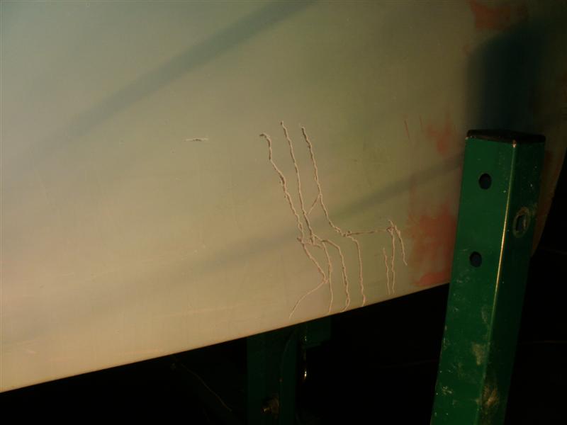

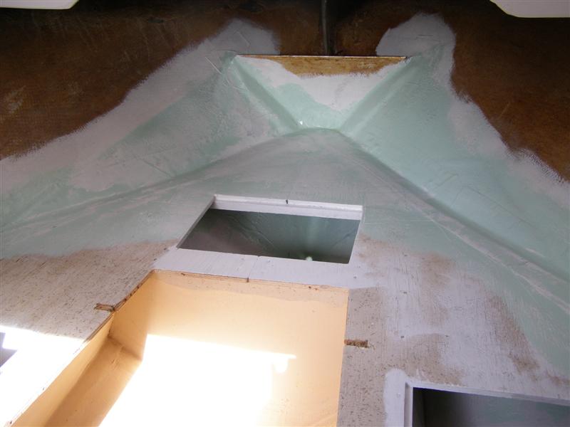

            filled crack and top coat

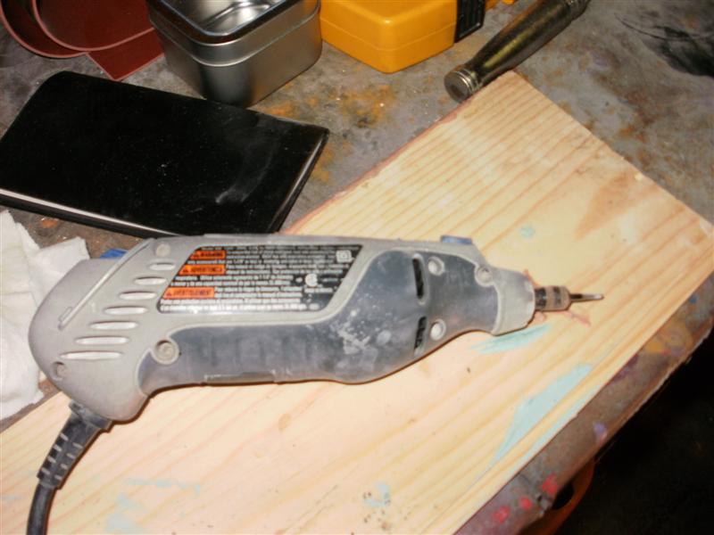

            Here is the process , I grind out the crack with the dremel with a small carbide tip. Mix the Silica with the gel coat add hardener and some wax . Fill the crack when it kicks I will wet sand it down and then put a finish coat over it. Then polish and buff it out

                Hatch cover sanded
                Here are some pictures of the hatch that I filled the holes where the bow light was and had a big crack in the back section. Rolled and tipped the gel coat and wet sanded it down. Now I'll polish it with the buffer and Finesse and wax Picture with all the color is a shot of where the 3 holes for the Bow light was. I'm going to move the bow light up to the top of the cabin so I can make room on the bow for my anchor roller and Bruce Anchor

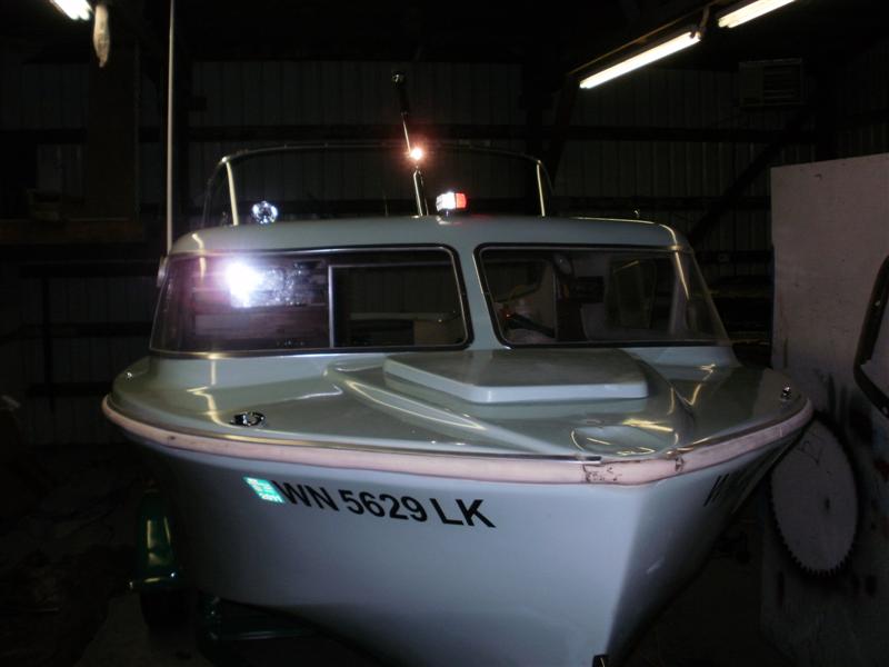

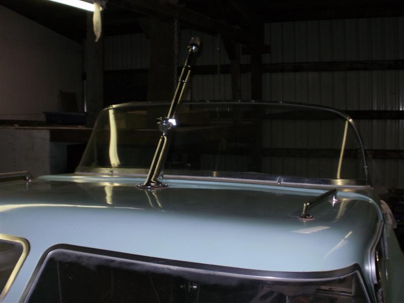

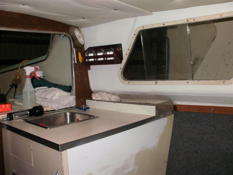

                              Made some more progress

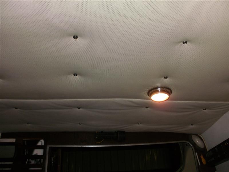

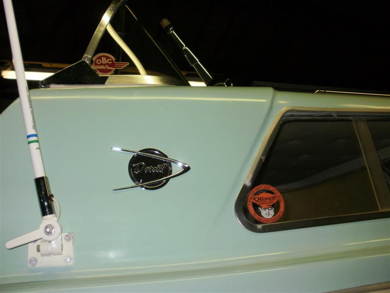

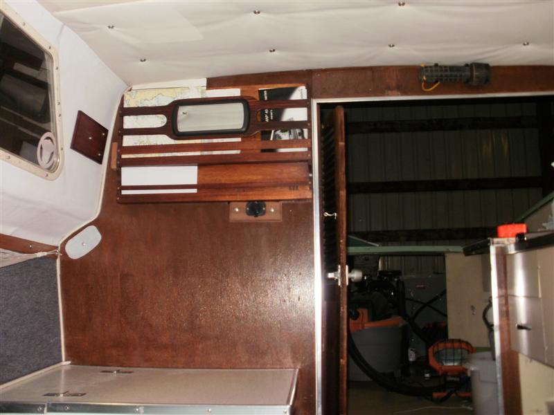

                              Got about 95% of the patching/ filling and polishing of the gel coat done. Melanie came by today and gave me a hand with some final electrical and some of the jobs that you need two people . Got the Chrome back from the chrome shop and mounted. Moved the bow light from the hatch cover to the roof of the cabin. Also got the cabin insulated and the headliner back in. Cabin is almost finished just some paint on the cabinet and some finishing touches. Got the Fuel/ water filter installed and all the nick knacks put up. Should be ready for the launch by March 1st for sure. Thanks for the hand today Melanie and I'll get you a day on that Skagit when you are ready !
