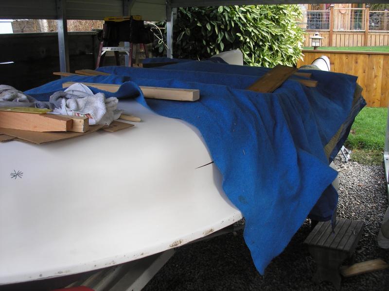

    Okay, it is just a 7 1/2 fiberglass dinghy and it was free so I guess it hardly counts as a boat. However, I think it is worth every cent I paid for it. Got a split in the side about a foot long and, since I just got it, I'm anxious to fix it up. Have messed with a fair amount of fiberglass over the past half century but forgot most of what I once knew. My question today is how warm is warm enough to repair the hull? I don't have any heat I can put on it. Don't figure it is something I would want to mess with until it warms up a bit but say 50 degrees? Could I just increase the hardener until it will kick in say 15-20 minutes? Or do I really need to wait until spring?:Cold1::Cold1:Jerry

    You can tarp it over with a light or safe heater to pre-heat the hull once prepped.Keep the epoxy material warm and mix normally and you should be ok.
    Upping the hardener may make a weaker repair if it gets too hot.
    A small space heater or light while it dries will get it hard overnite.
    A cardboard box could be used to confine heat to the repaired area as well,just don`t start a bonfire!
    Faster cures mean weaker strength.....
    Final tip on blending the patch,try tearing chop strand instead of cutting with scissors.Let the Hairs lay however they want reaching out from the seam of crack.A Cloth Band-aid can go on later or right on as it tacks up so you can squeegie the epoxy smoother.
    Also good to do both sides of hull so strength is balanced.

      Thanks Tim. I was wondering if loading the resin with hardener would have a negative affect. Guess one of these days, I'll pull the truck out of the garage and open door and window so I don't drive Becky out of the house and put a tarp and heater over the dinghy. Suppose I'll need to patch both inside and out. Are you suggesting a longer patch and both port and starboard on either side to make the dinghy stronger? Suppose I should think about some foam under the bow seat so it doesn't go to the bottom if I tow it too fast and flip it. I'm still thinking of that little Mid-jet ob down in Oregon. It seems so cool. Hoping when he said it doesn't run, he was talking about the Tehcumseh or Briggs and Stratton motor and not the lower stuff.

        I just laid a couple boards across the boat and had a small space heater inside and then laid a couple blankets over the top and a few other boards to weigh it down, Just like Tim described . Worked really good . If you put in too much hardener it takes away some of the strength and makes it brittle (so I've been told )
