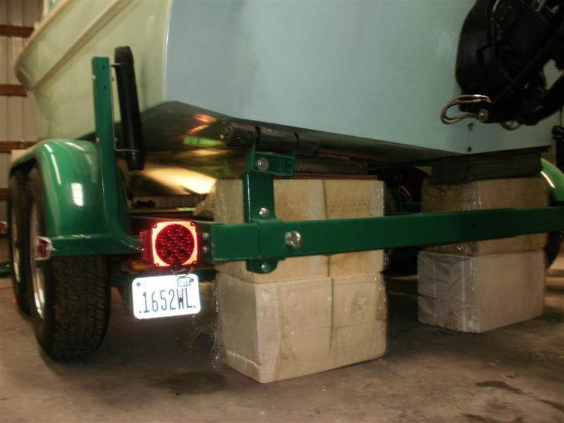

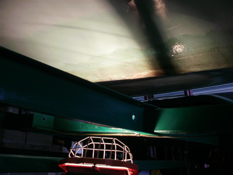

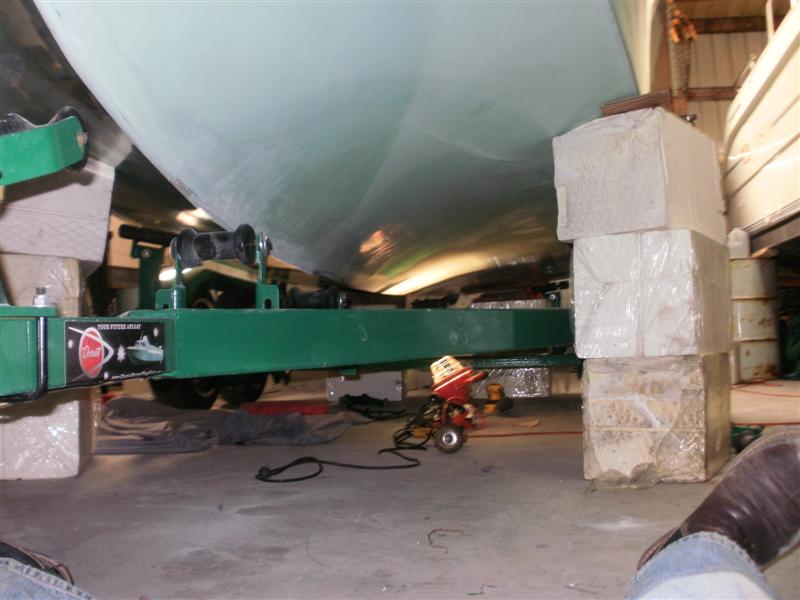

                    When you put the boat on the trailer it does not leak out ??? I found a small leak I had on the keel from the rollers. It was just a small crack and when it sat in the garage I could see a small puddle under the boat . One would think if it leaks in it would leak out ? I had to jack the boat up off the trailer and block it then put a few strips of fiberglass along the keel - no water now when I remove the plugs I don't get a drop. Got lucky this time
