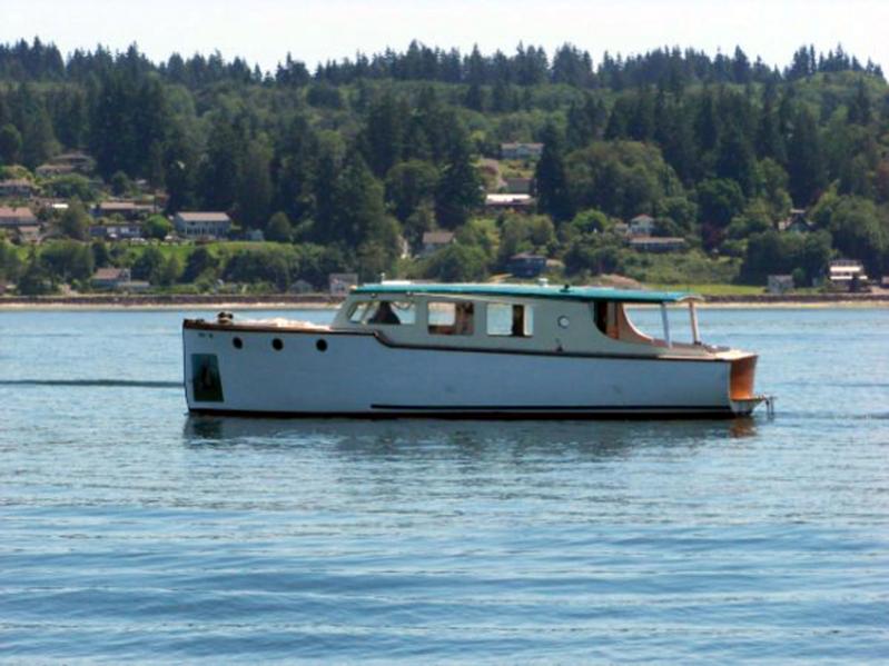

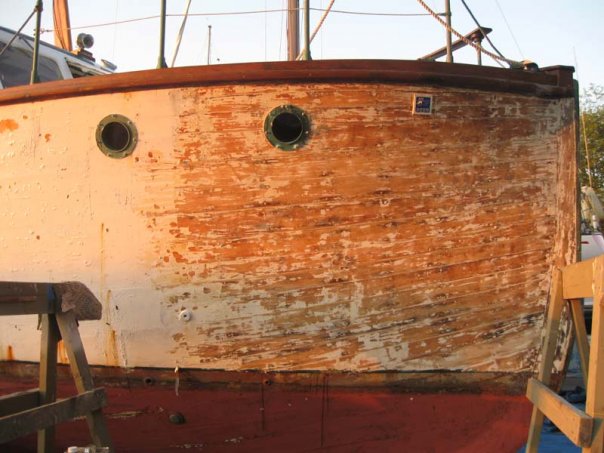

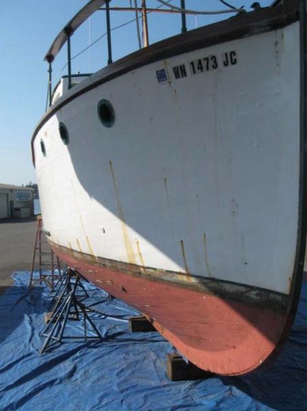

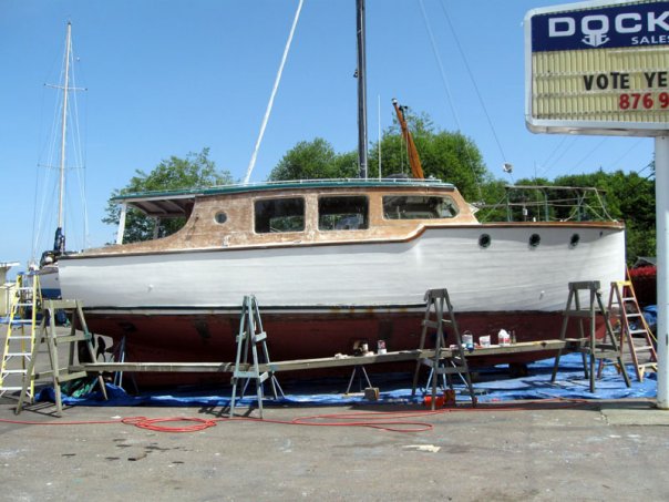

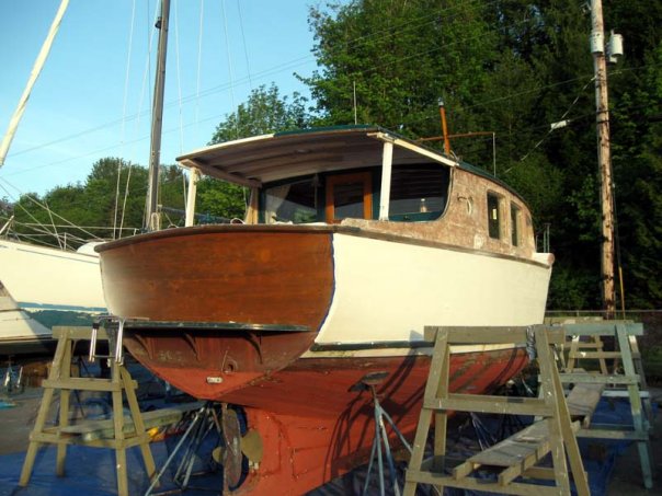

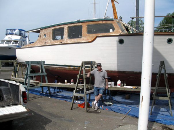

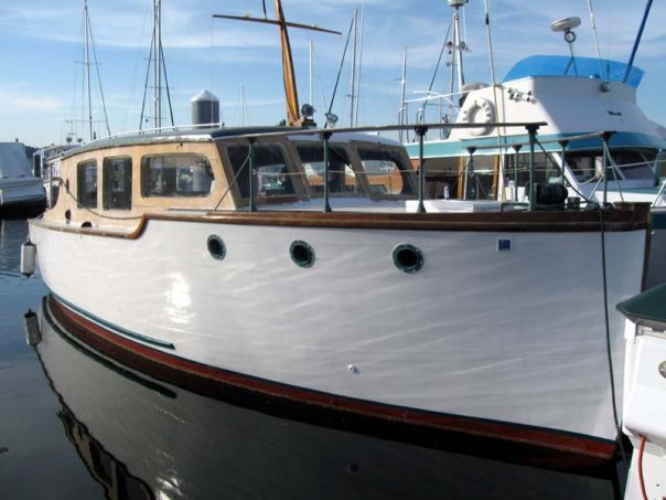

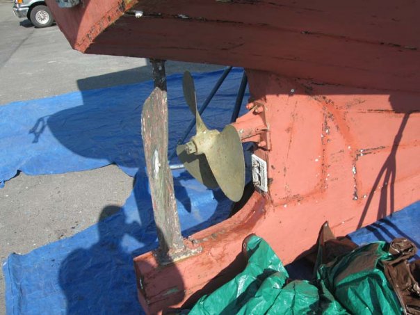

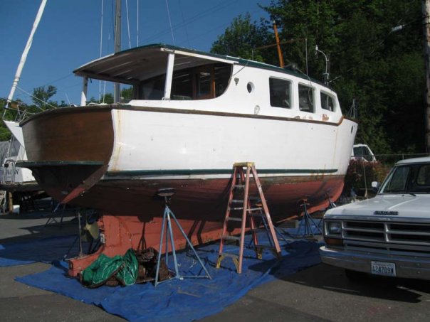

Thought I'd share some photos from my project in progress from 2009. I purchased her from a couple young brothers who had used it as a party boat for 8 years. The older fellow was a good mechanic and focused on running gear while letting the exterior wood and canvas go south. At least they kept things covered with many layers of white paint (on top of peeling canvas and blisters). When I took possession, she had a long plastic slide from the aft cabin top down over the stern - evidently for kids to splash in the water - looked really weird, first thing to come off.

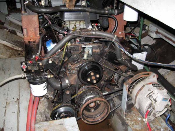

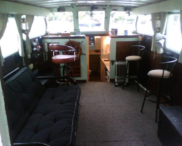

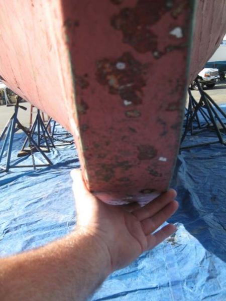

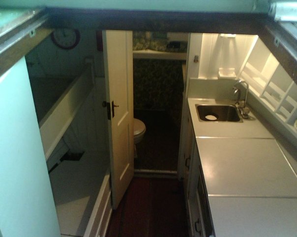

She has a 305 Chevy MerCruiser installed in 1985 (about 1300hrs) that runs like a top and doesn't use oil, a head with manual pump and 15gal holding tank, 4-burner propane stove and oven, 40gal H&C pressured water, 12/120v frig, two 12/120v inverters totaling 2200 watts, four house batteries and one start, hull is 1-1/2 cedar over oak ribs on 10" centers, the keel is 10"x24" cast iron that runs from just back of the bow to the skeg - keeping her very stable and making up a good portion of the 32,000lb displacement, there is a 22" bronze prop but I don't know the pitch.

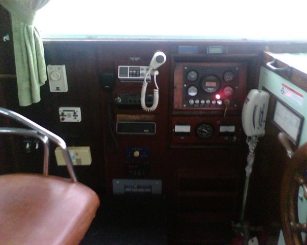

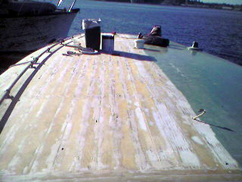

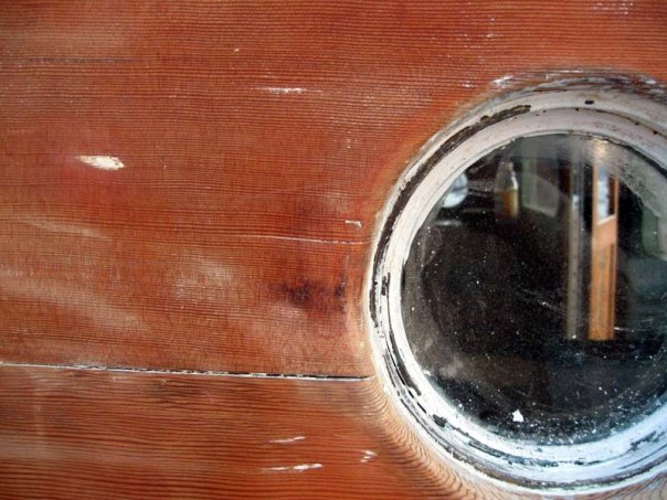

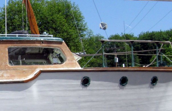

The old girl has no radar, depth sounder, GPS or such but has a couple VHS radios, a compass and the regular assortment of engine gauges. Most of these photos are from the haul-out soon after I brought her home. The last few weeks I've been stripping the old canvas from the cabin top (T&G western red cedar) and prepping it for West Systems penetrating epoxy over fiberglas cloth the same way the deck was done. The deck was finished with gray colored 2-part Gaco deck coating and ground walnut shells.

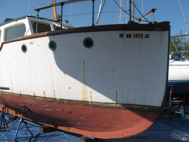

Sure wish I could afford a boat house 'cause it's no fun dodging the rain to get the exterior finished! Remember: The bigger the boat, the bigger the problems!

Most impressive, always nice to see people putting the effort into these old woodies. At least with that keel and prop guard you really have to try to damage your running gear
