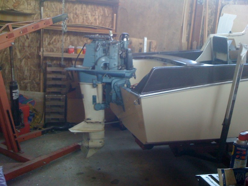

        The plans right now is to just put the Bearcat on the back and run her with that. No need to go fast as the hull won't allow it anyway.
        I am not sure she would carry two of them with out dipping the tail end in the water as she is pretty low in the water.

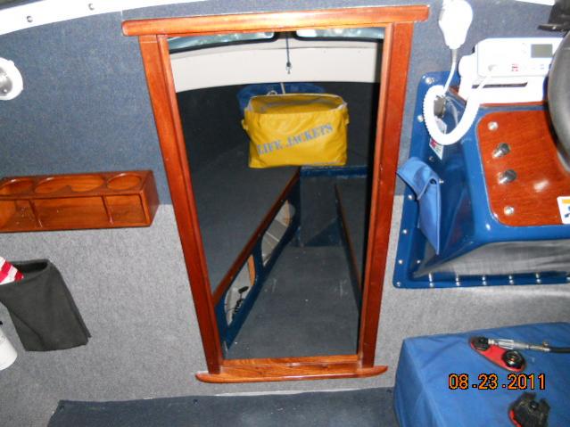

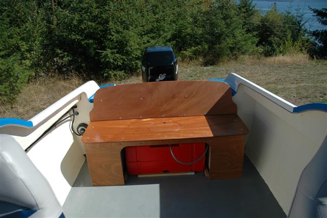

          Joe, U mention the fuel tanks up by the bulkhead. Here's another idea i did on a few of my boats. Only one so far on Bainbridge as it is only a 12 gal strap down back up tank ( it was left over from the G-3, Farallon ) to the 28 gal in the stern. The Rosario has both up at the bulkhead. Chuck
          • #20
            That looks like one of those red tanks without a grounding lug on it. Hope not.
            I have a 12 gallon tank but I can't lift it in so I have to fill that with another plastic 5 gallon jerry tank that I fill, On the ground at the gas station.
            I seen this thing on Youtube were a fellow was filling one of the portable boat tanks from the gas pump at a gas station and a static spark started a fire.
            He had enough time to get out of the boat and run as it caught the whole gas station on fire.
            That is why they tell you at the gas station, Take the tank out and fill it on the ground.
            Not saying you don't mind you, it just came to mine when I seen that picture of red tank.
            All most of what they call "under the deck" tanks will have fuel gauges and a grounding tab that I use when wiring up boats.
            Thats the end of my public announcement :BigWink1:

              Joe, Did you get my e-mail ? My 12 gal above floor tank is plastic mfg by Tempo & Moeller. The one in the Skagit 20 ( 28 Gal) is another Tempo. Are you talking about Metal red gas tanks? It sounds like you are doing the same thing with your 5 gallon plastic as what i'am doing with my 28 gal plastic tank and 12 gal plastic except mine are already on the floor in the boat so i don't have to fill it again. Are your tanks metal style the boat ? Just trying to understand. Best,Chuck
              • #22
                Hey Chuck.
                I just replied to your Email.
                Its simple. If your fuel tanks IN the boat are Not grounded to the electrical system, don't put a gas station nozzle in them. Static electricity can cause a fire.

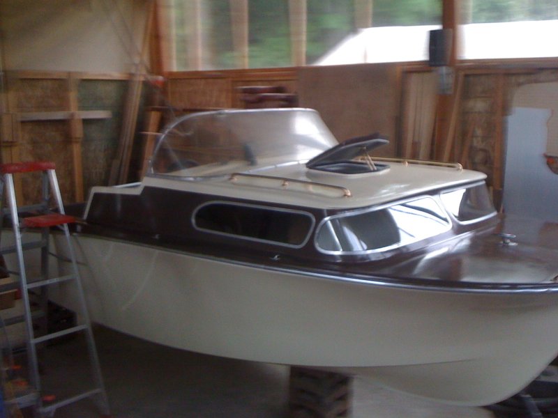

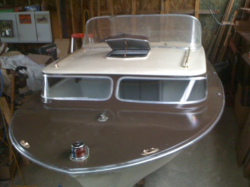

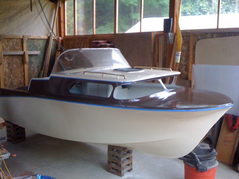

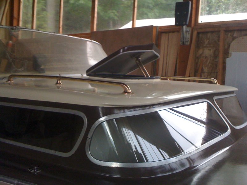

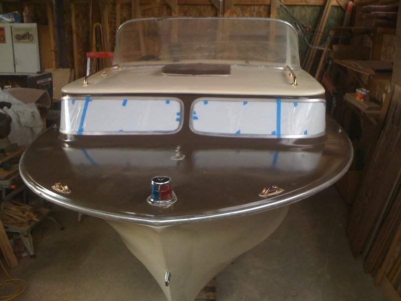

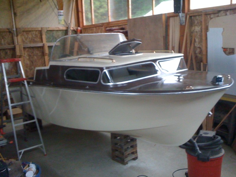

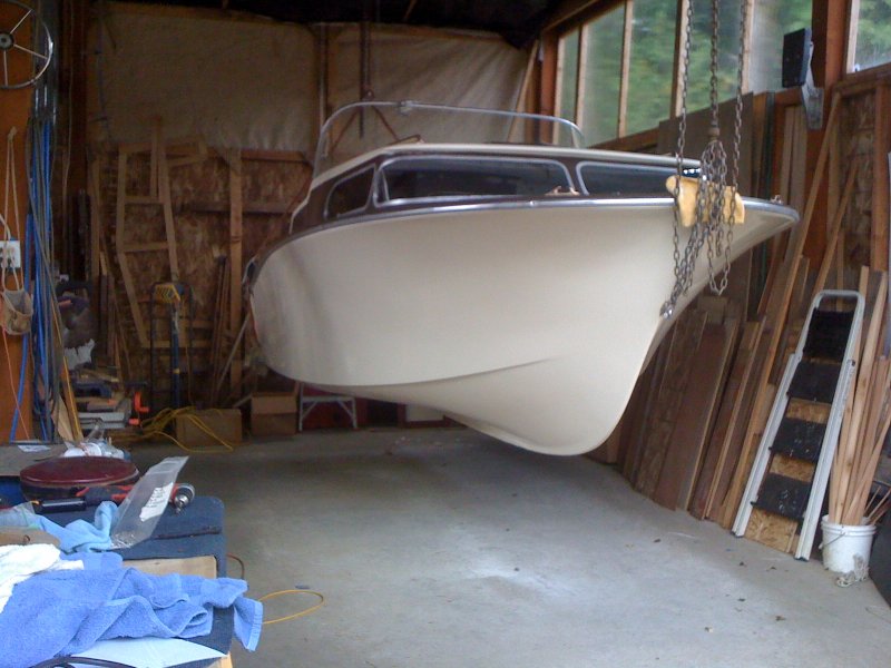

                  More Progress on the Uniflite.
                  I really hate doing windows, But, it had to be done..
                  Anyway, here is more progress on the Uniflite....
                  No time to buff it out, time to get the motor hung on it, controls etc.

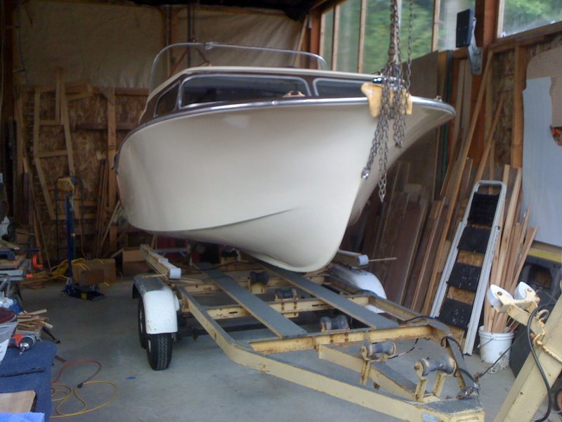

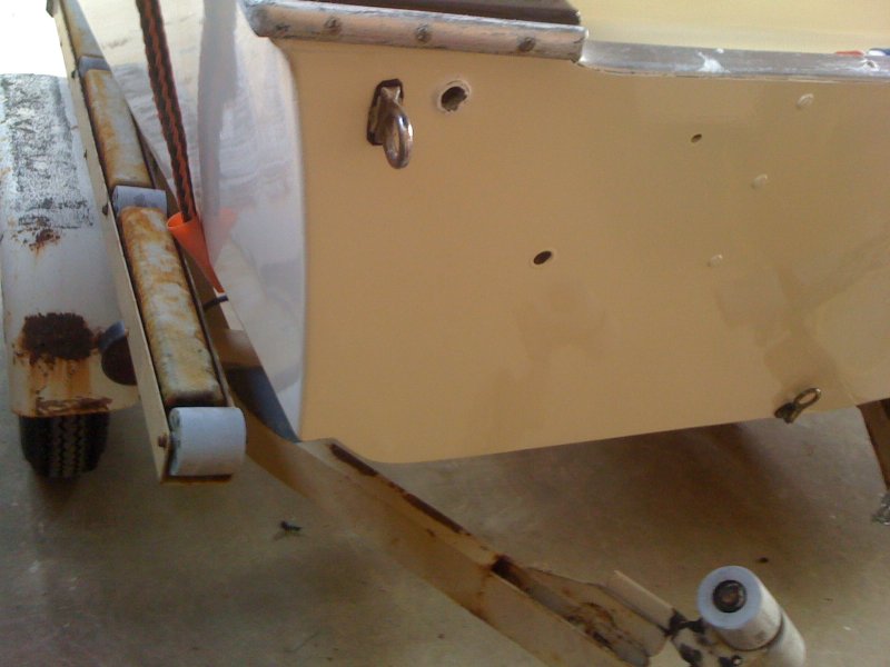

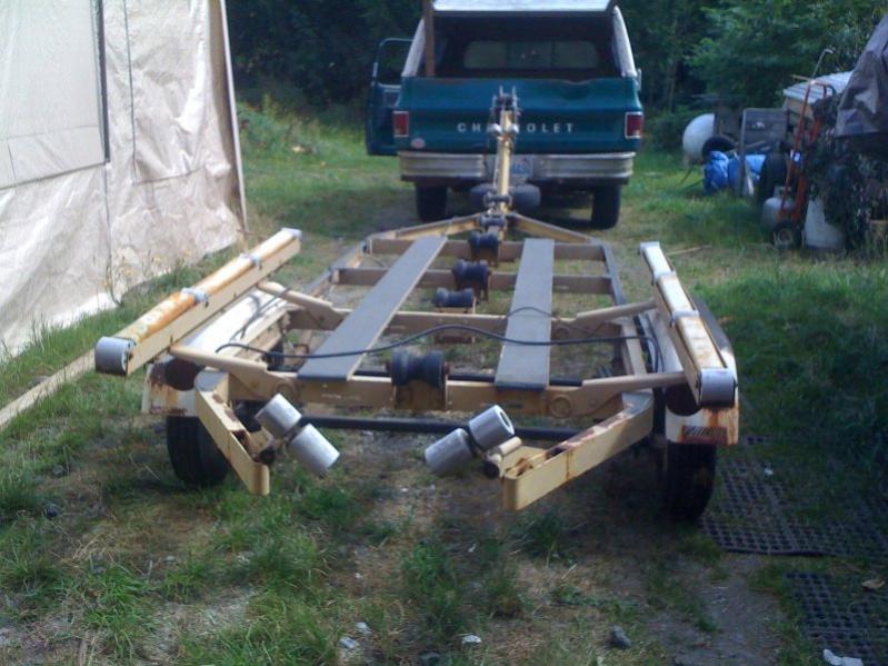

                        More progress today on the Uniflite.
                        Tried to load her up on the dual axle calkins trailer but found its going to take a Lot of adjusting. The side bunks both need to come inboard.
                        So, she when back on the single axle calkins. I had one bent pipe that held one of the rear rollers so stuck the rose bud torch on the pipe and with the army jack and a logging chain, all fixed.
                        Just not real fond of how wide this trailer is but will do.
                        Next is to get the motor hooked up, controls and at least a bilge pump wired in for Mason.

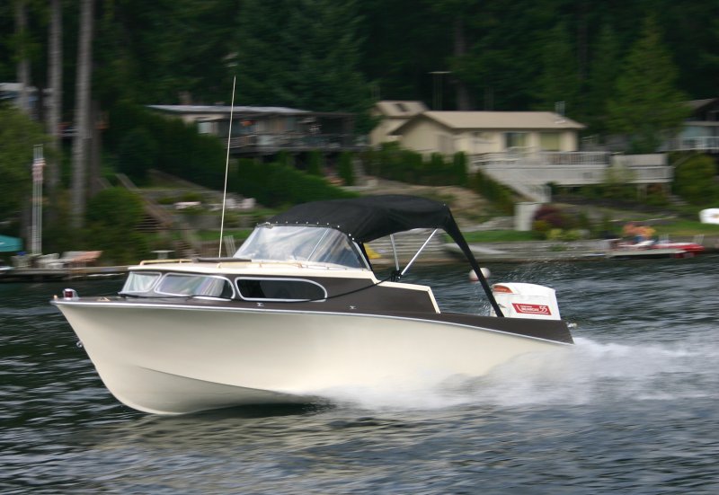

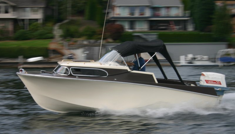

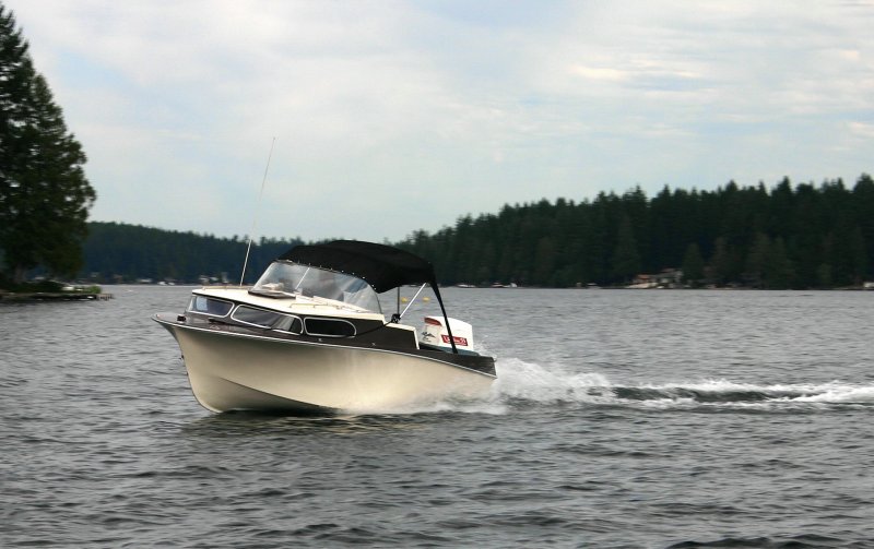

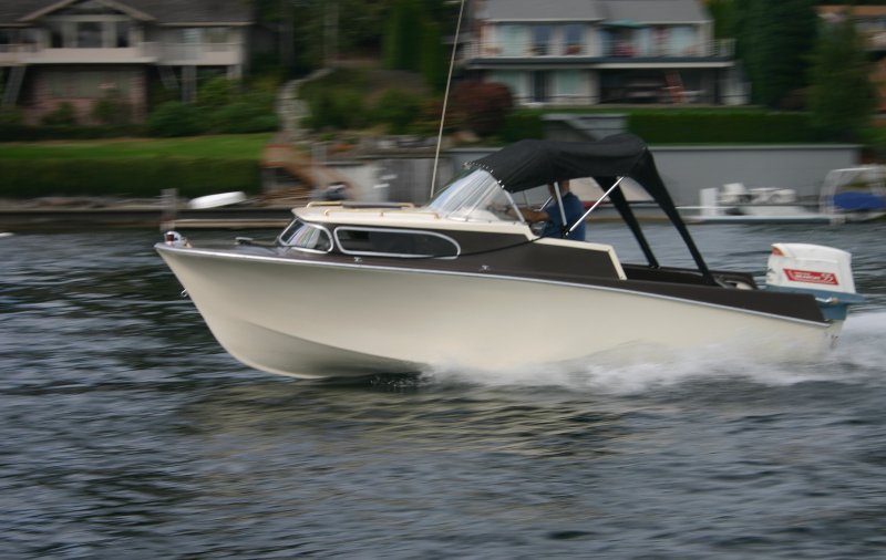

                              Progress on the Uniflite 17
                              Well, as most of you that were at the Mason event ( I think its our best event setup for a large group ) I am sure you seen it.
                              The trials went find, the Bearcat was running at its best thanks to John Nelson as John and I went thought it.
                              It would jump right up on plain and scoot out to about 27+ mph at 4200 rpms.
                              Its back in the shop now to get finished. It needs inside the cabin done as well as some work in the cockpit area.
                              I guess I can say I was Very pleased with how she ran out
