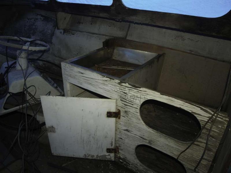

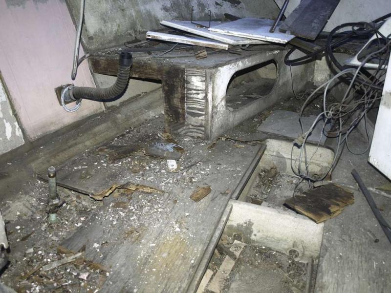

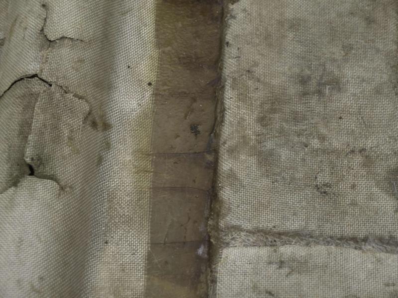

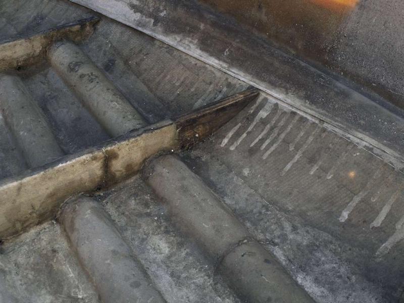

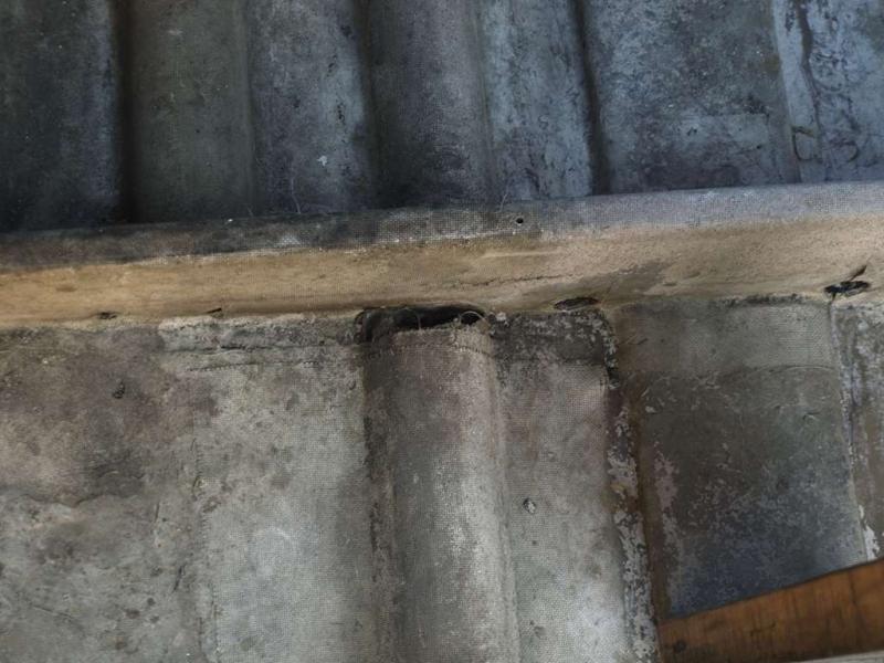

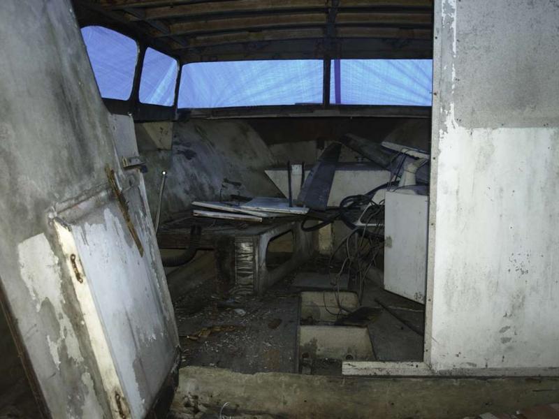

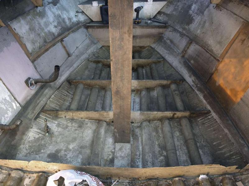

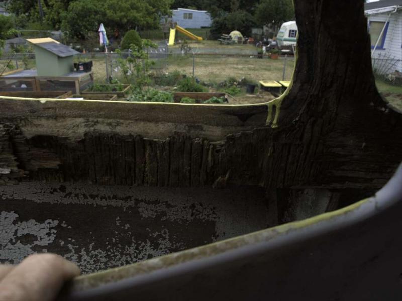

The 19 Bell Boy is a customers boat that I was working on and I will attach a photo of what I am on now.

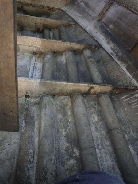

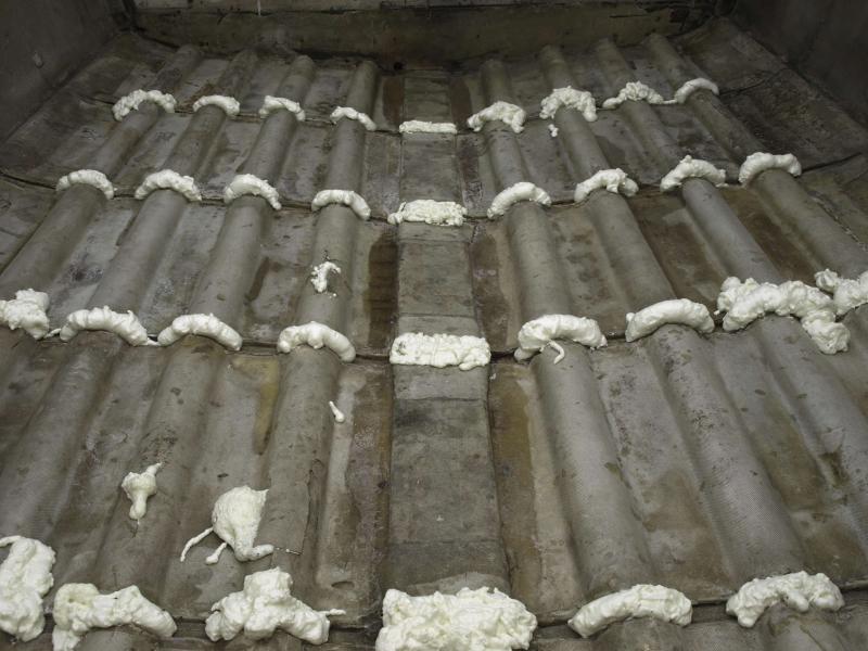

The floor is 1/2", super sealed on both sides, double on the edges and once the holes were drilled out, I just took a little foam out of the hole and used expoxy resin and epoxied the plugs back into the holes.
Once covered up with glass cloth after foaming and plugging the holes, NO movement at all, solid as a rock to walk on.

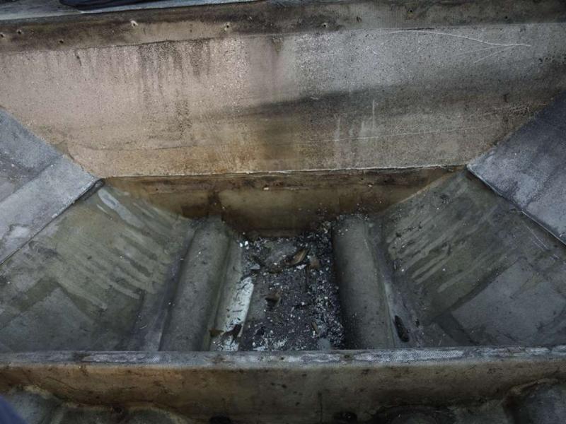

I do remember once we did the tare down was the saddle tanks did have a cross over line under the floor.
If your going to do the cross over, might leave yourself some room and plumb that in before you foam.
