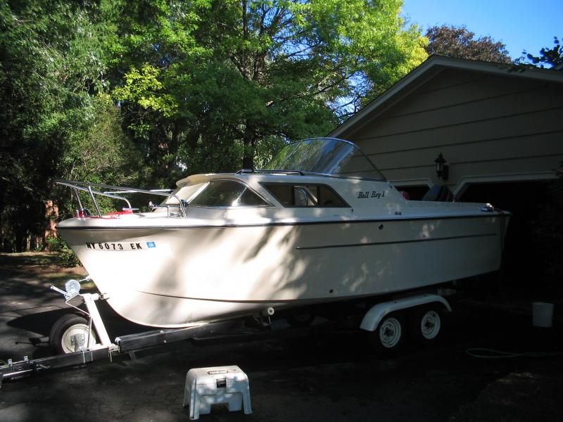

            Ha ha. That idea WAS floated around here but the new garage header would have to be 120" (10 ft.) I am now at the standard 83" No tire deflation would lower my boat 37" !! That, of course would be best for the BellBoy but I would have to dismantle the loft inside the garage, raise the header and buy a new garage door...Hmmm. Here is a shot of the boat in front of the garage door.
            I think I will stick with the removable windshield for now but my goal is to get the thing to LOOK better where it is attached. I will find a way. You have been very helpful and I have a lot more ideas than I did!
            Bob
