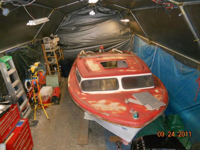

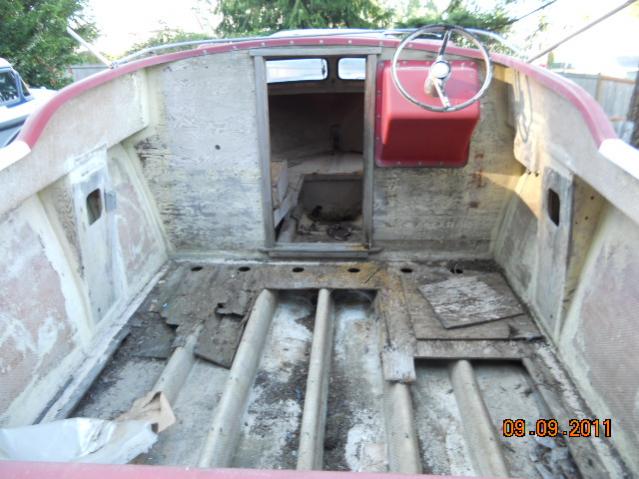

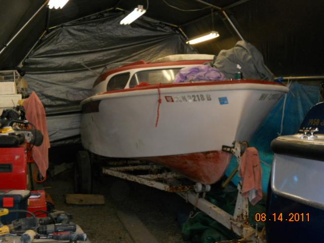

    Well I woke up this morning after poking around the new project yesterday. Found some rot by way of my foot falling into the bilge area... And rot under the sink... So after two pots of coffee, cussing, wondering why I bought this, followed by more cussing (my neighbors must love me). I started to delicately tear out the interior and floor. The people who owned this boat sure liked sheet rock screws, all three types (phillips, square head and those pesky star ones). So that being said here are some really bad pictures I had to use my phone because my camera is shot...
    As for the last few pictures, this was the "electrical" and the helm.. I am not sure if speaker wire and electrical tape are marine grade, but I am surprised this boat never caught on fire...

        I was poking around after hours and it was not good or maybe it was... the rot I was speaking of on the cockpit is worse than I thought. Those damn sheet rock screws were pulled up like nothing.... So everything will be pulled out of the cockpit (gas tanks, helm, ECT.) and the real work begins.... Gotta love it or not get involved in it!!! I will post more pics soon...

                  Ok got into it a little bit and removed a small section. Not as bad as it seemed. Stringers seem sound and the rot it confined to the top sheet. At some point the deck was replaced. But since I am this far in I am going to remove it all and replace the cockpit floor and glass it up correctly. Bonus: I found a bilge pump!!! Not hooked up to anything, but it looks new! Pics to follow. I do not have much daylight.
                  Helmar, does the expanding foam seem feasable on this? I think it would take a lot and make the hull run high... Any suggestions or should I drop a new under deck fuel tank?

                      Here are my pics from the after hours exploration, and under further investigation it is not as bad as it seems... It looks a cockpit floor replacement is now on the agenda, but that's okay. Maybe a good time to install a under deck fuel system. There is plenty of room. Suggestions? Last pic is the bilge pump to nowhere...
                      Electrical has been removed as well as the old helm... Twin funky tanks are out. Still has gas in them...

                            Break out some Bleach,mix it up with Hot water and start spritzing all that solid plywood you see.The black will go away if you do it enough,then sand and watch for powdery areas which may be dry-rotted.The goal is to kill the mold spores and saturate the wood for any offspring.
                            Epoxy anything you think is soft or replace (both sides equally thru-out hull).
                            I`d keep the fuel above decks,amidship so center of balance is the same whether empty or full.Skinny belly tanks don`t fill quickly(which look like all you can fit) and also show full until 1/4 full,then drop off and finally work as you drain them.
                            Find any screws poking out the bottom?
                            With floor out ,you can put light outside or inside the hull and then look from the other side to reveal thin places or repairs you never would find otherwise.This works better in the dark.......
