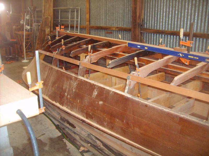

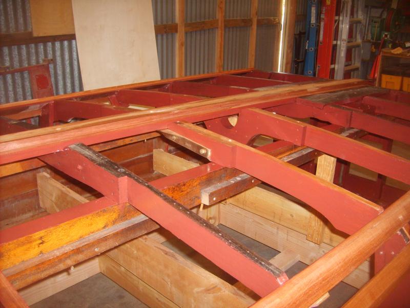

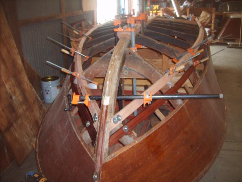

    Guys, I'm currently restoring a 1960 CC sportsman. It's a solid mahogany 17 foot utility boat. The boat came from the factory with a 283 v8. I bought it to bring it back to luster...

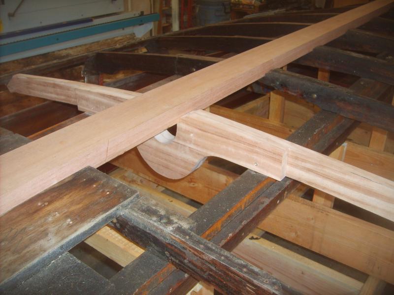

    I have turned the boat and currently installing a new (5200) plank bottom. I have replaced 3 frames, the keel, and chines. It's been a fun project with some challenging aspects so far! It was taken apart in the '80's and had been sitting since. Can't wait to blast up the river in this classic...

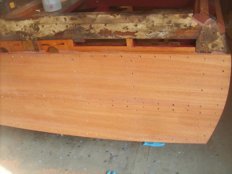

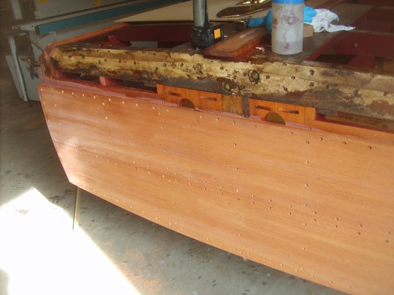

          Guys, after getting a second coat of bilge paint in the transom area yesterday, I was able to get the transom planks screwed in place today. They are glued with 5200 and screwed like crazy! about 160 screws in those two planks...I made my own plugs from the drop when I cut the two new planks. The grain on each plug WILL be straight! The CC factory so hap hazzardly built these boats...I have a little more touch.

            oooOOOOoo!! Another woody! Nice project! There's nothing quite like a boat made from trees - you can always use them in the fireplace when it comes time to scrap 'em!
              Nice work, Looking forward to seeing it afloat. For me the project is almost as fun as using the finished boat. Andy E.

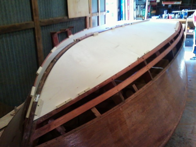

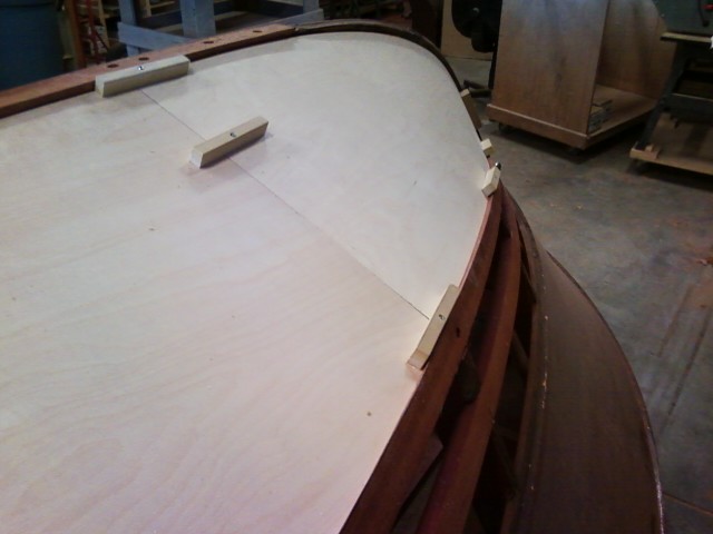

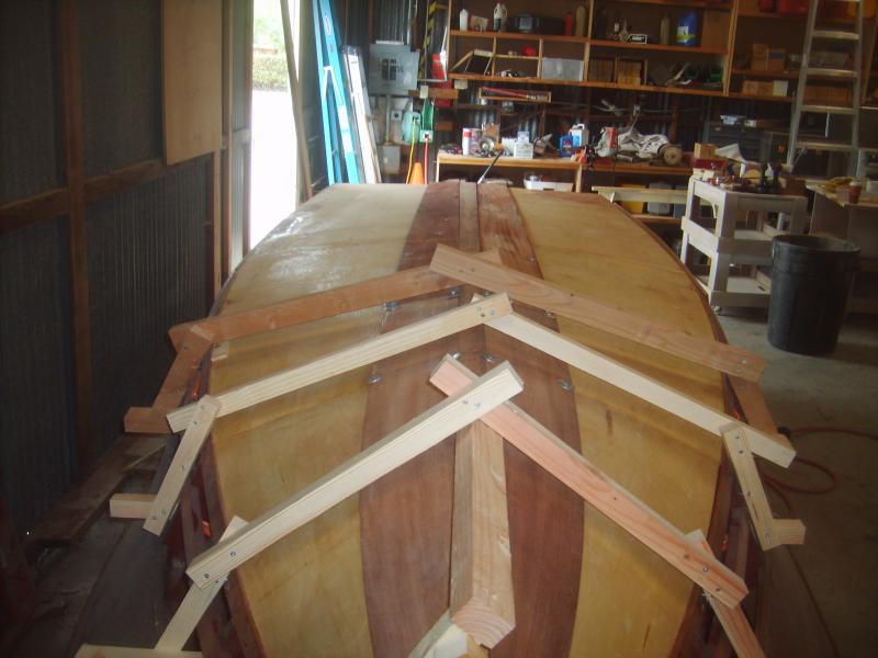

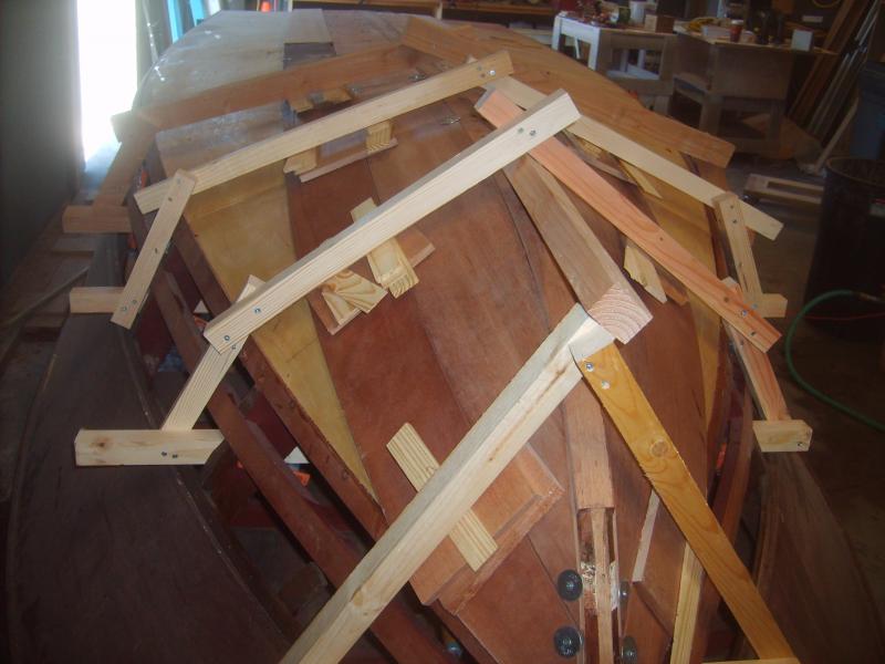

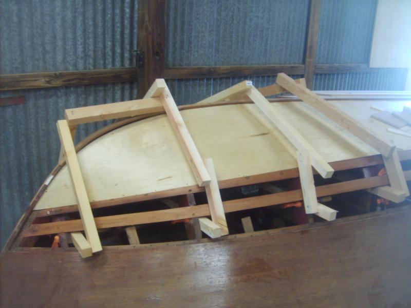

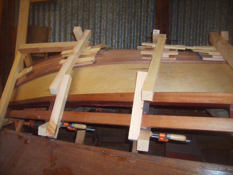

                  Guys, I have been working on the trailer the last couple of weeks, but I have made progress on the boat as well. I fitted the inner ply bottom. It is 1/4" birch ply. I can now seal all edges and faces. I need to bore the drive shaft hole in the keel before bedding the 1/4" ply with 5200. It gets screwed in place with blocks as in the photos. Once the 5200 cures, the screws are removed. The bottom sides planks are bedded with 5200 and screwed in place with nearly 2000 bronze screws. I'm real happy with my work so far... STAY TUNED!!

                    You should be happy Bob. That's a nice tight fit on the birch panels. Nice job for sure. Looking forward to seeing the progress pictures. Thanks for the post.
                      Looks like your doing a wonderful job, please keep us imformed on your progress and welcome to the club.

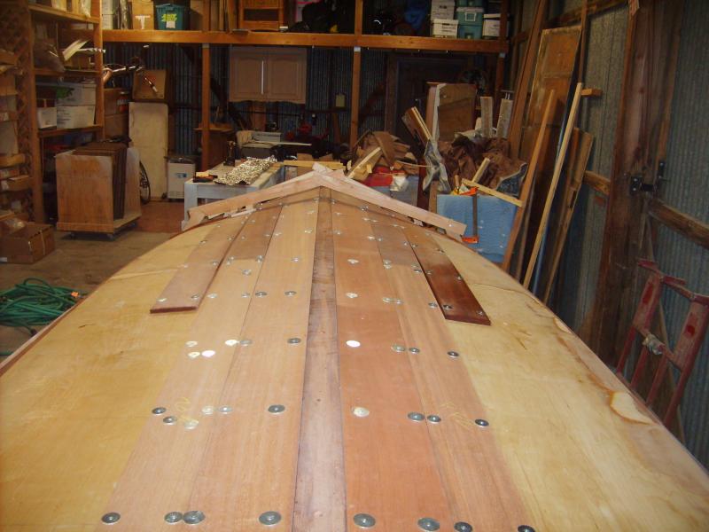

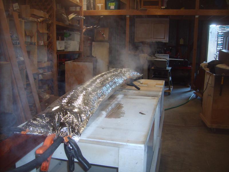

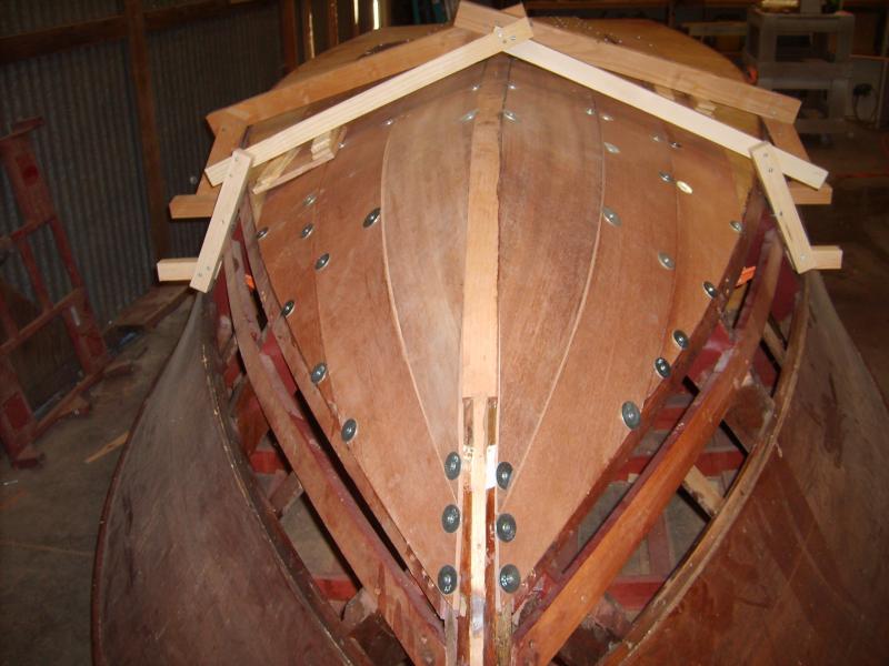

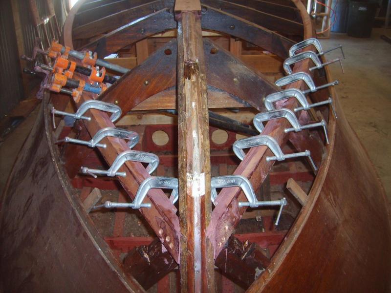

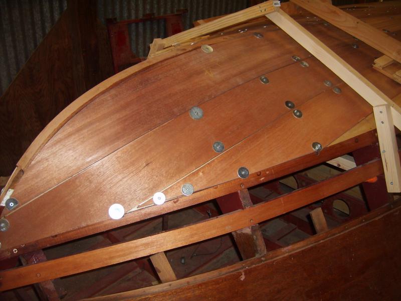

                        Guys, It's been some time, but I am back on my restoration project. I have been steaming in bottom planking. It's going real well thus far. take a look...

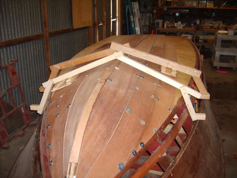

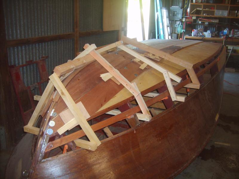

                          we're gettin closer!!! two more planks steamed in today. Sometimes we go through an element or more doing this steam thing. today I went through two, but got em in...

                            This is looking better and closer to the water every time you show pictures.
                            Keep up the good work :GoodJob:
                              Thank you Helmar, It's moving closer... lots left to do. Bored I will not be.
