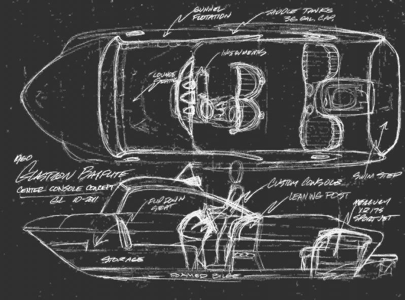

        Though the Glastron Bayflite is nicely preserved, the factory's utilitarian "lawn chair" set-up, with it's luxurious 1" foam padding - wasn't going to win any style or comfort points. The ability to camp, tow skiers, and haul family in style has driven the Center Console Concept with lounge seating up front.
        By moving the cockpit mid-ship, with a leaning post driving position - vision and comfort will be enhanced. In modified cuddy form, powered by a Mercury 175 hp SportJet, the "space age" Glastron should live up to it's original design goals...G
          Greg, you will like the Center Console. I picked up a 16ft Center Console for fishing the lakes down here (Not a Glassic), but a wood boat built by a fellow up in Portland.
          I really like it. It's much easier to get out of the seat and tend to whatever might be going on. Seems to be much roomier with that layout as well. Go for it, you won't regret it.

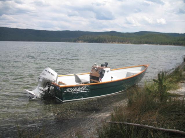

            That is a sweet ride, Diesel Kiesel. Tell us more about this new fish catcher made out of plywood? What are the advantages over modern materials for your uses. Wonder how many the builder sells annually? Can't help but notice the Honda - I thought your lake was minimum HP only??
            Your thoughts on the center console plan are appreciated. I loved the freedom of standing while riding in your Seafair and GregJ and ChuckC's Skagits I've hitched a ride on.
            A leaning post has a small seat area, but a standing position is normal, allowing your legs to act as shock absorbers, in harder riding low deadrise hulls. With my condition, the "free" excersize induced by a seemingly passive hobby will make it easier to justify feeding the hungry Mercury.
              The Honda does look big in that picture, it's a 40hp. Pushes it along just under 30 mph with two on board. Sure nice having an engine that starts when you turn the key. What a concept.
              The builder only built this one. Not a real professional finish job, but good enough to spill some fish guts on.

                Greg, Great concept. Looking forward to seeing that on the water one day! Do tell more about your Merc jet. What did that come in? What do i need to keep my eyes open for to salvage a power plant like that?

                  Hi Brian, the low-hour Mercury XR2 175 SportJet going into the 1960 Glastron Bayflite project was excised from a '98 SeaRayder F16 that was burned in a carport fire in 2000. It sat in dry storage since then, until purchased early this year.
                  Everything needed to retrofit the combo into the Cruisette is intact and undamaged, with the exception of the pervasive burned resin odor.
                  These motors were commonly installed in 97-99 Sugar Sand Tango, Bayliner Jazz and SeaRayder recreational jet boats. The 200 and 240 Optimax engines were common in SeaDoo Utopia until 2004. The later models have the louder wetbox transom exhaust that makes for a larger engine footprint, and more complicated install. Expect top speeds in the 48-50 mph range in a glass boat up to 18'.

                    Greg ,
                    Wow ,is an understatement.....knowing what it takes to rig a Sportjet OR a center console (access panel for helm and wiring please....or hinged as an assy) makes my neck hurt just thinking about it.
                    You get to tackle both!
                    I too love the stand-up ride,lets you give some "English" to the driving and saves the lower back.
                    I`d do a rough mock it up in Cardboard and milkrates ,ala "Red/Green" and see what your steering cable want to do.
                    Keep up the wild restos!
