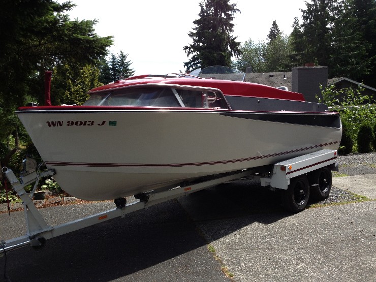

      Joe, here's how mine turn out on this 59 Skagit. 1/2 " and two 1/4 tapes.
        Personally I have never had any luck "calculating" water lines. I always save that for after the first float test. Then with a good sharpie and cloth (to dry the spots off) I make a very small (but noticable) mark where the water actually is. Then get back home and tape from mark to mark... The is the method ACB actually used for their boats as each one had so much customization that no two ever sit the same in the water.
        To me there is nothing that ruins a perfect boat faster than an incorrect waterline placement. It can be seriously tacky looking. Look at some of the midsized Bayliners out there with 12" of bottom paint exposed at the bow! Tacky!!
