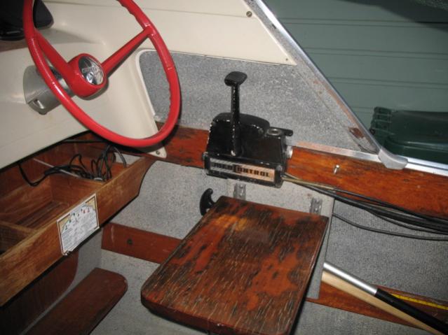

          Greg, I've got an old steering wheel that might work. I'll get a picture Saturday and post it. You can decide. It's the original one from my 59 Seafair.

              Greg, one problem with having a big shop, is it's harder to find things. The one off my Seafair is pretty much like you already have. Here's a picture showing the wheel, most of it anyway.

                Thanks for digging up photos of your original wheel Steve. It is not quite old enough to achieve the "look" I was thinking of, but would be a great addition to any ride from the 50's. I bet you could fetch a decent amount if you offered for it sale.
