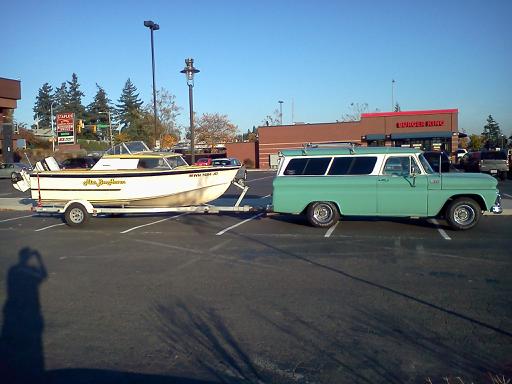

    As you can see we purchased Tim Mattsons Seafair. We told Tim that we were going to gut the boat and rebuild it, its just we do with projects. We just completed a total rebuild in May of the 1965 24' Airstream which is our third vintage trailer rebuild. Our plans are to change the color from yellow to light green the same color that was an option in 1959. It will also match the 1965 Suburban that I took down to bare metal with extensive metal replacement and paint.

        I like the early duel head lights, it is something I have wanted to do to ours. I built the burb as a daily and as a tow rig for our vintage airstream. Power is a 350 with a 350 turbo 4.11 gears with a gear vendor overdrive. We just completed a 5000 mile plus trip towing the airstream to all of the national parks in the 4 corner states.

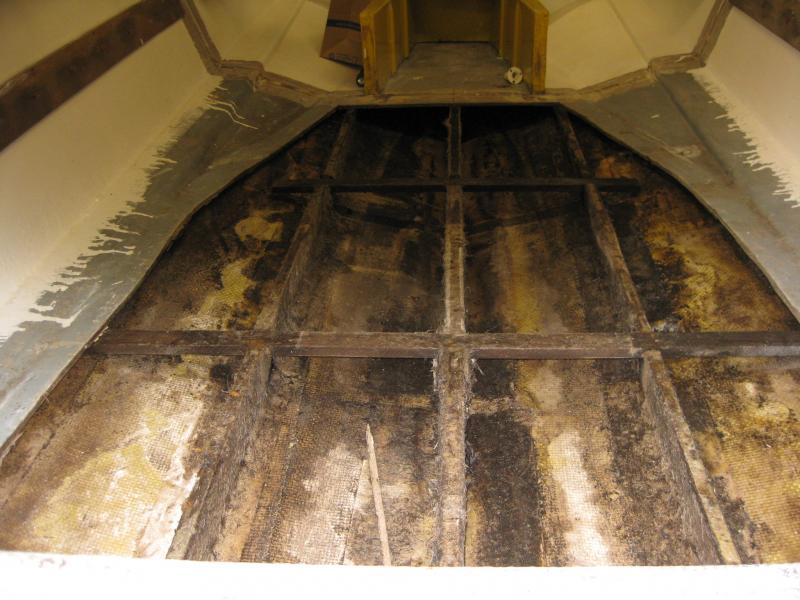

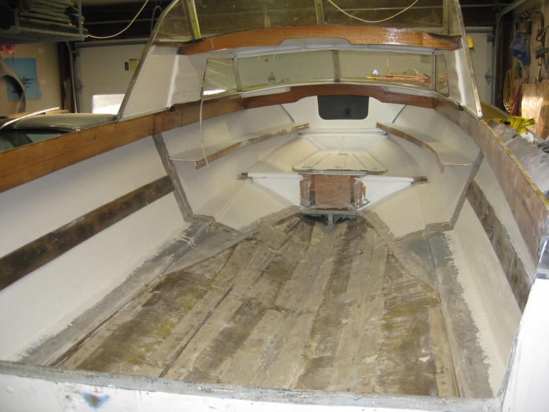

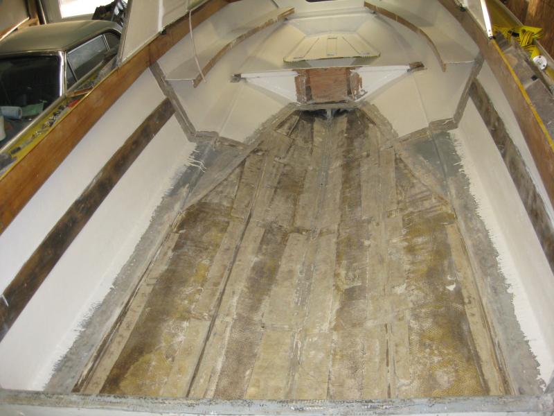

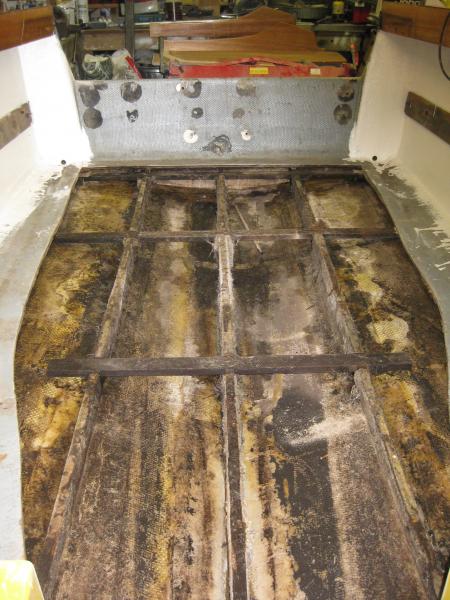

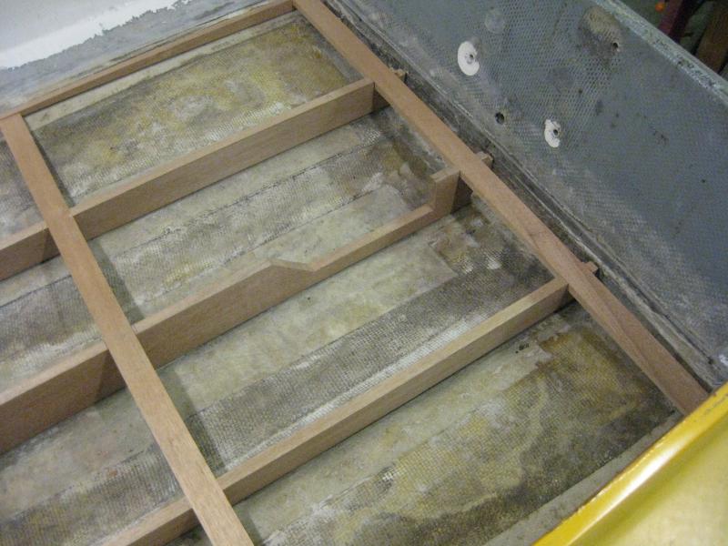

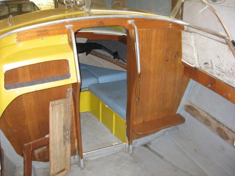

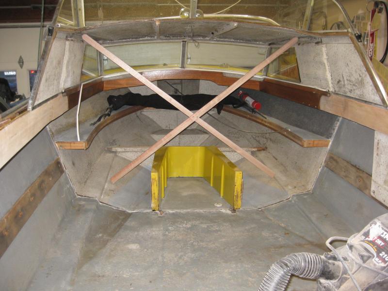

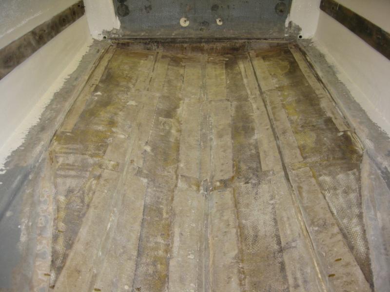

            Here are more pics of the removal process. The floor removal went easy it was only 3/8" three ply plywood and all of the fiberglass was delaminated from the wood. This also went for the stringers, they were fir and saturated with water (yellow submarine). The stringers only had soft spots where the cross supports attached. Removed allot of weight with the wet wood and saturated foam. The stringers were only attatched to hull in one 18" section they just lifted out after cutting the glass. One evening of grinding cleaned out all of the junk and loose fiberglass.

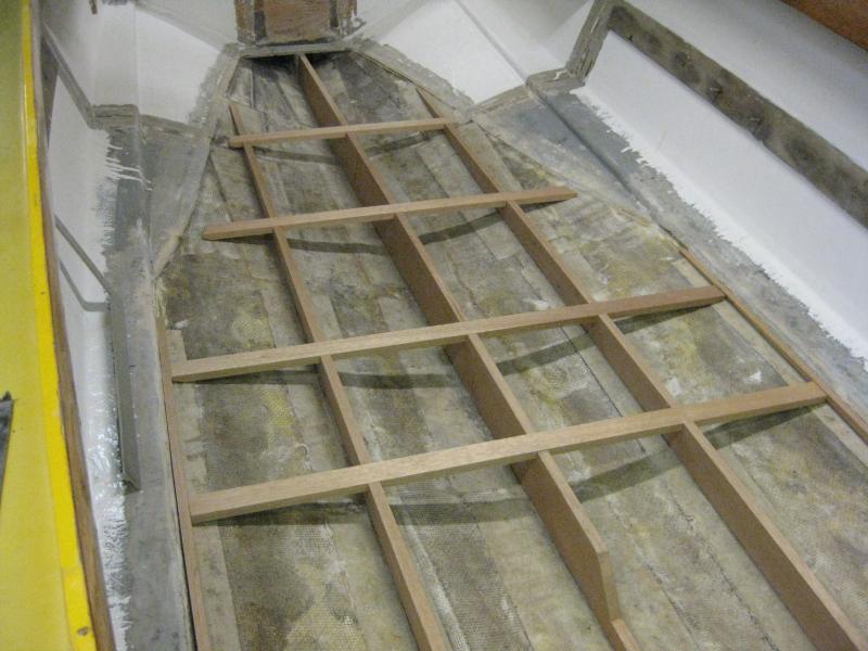

              The Seafair has a weak spot right around where the cabin bulkheads are located. Some of the Glasspar guys have added "sisters" on each stringer, and one on each side of the keel stringer. Glasspar in Olympia didn't use the best materials and didn't always glass them well to the hull. Do those two things and the hull will stiffen up nicely and ride the rough water really well.

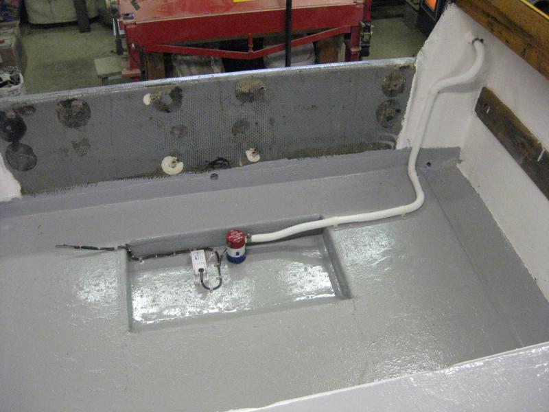

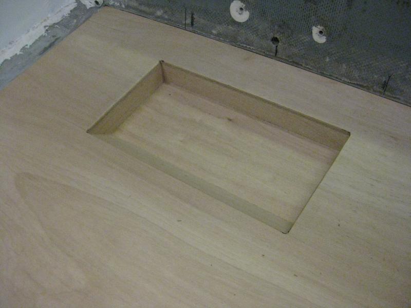

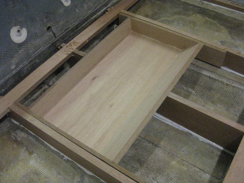

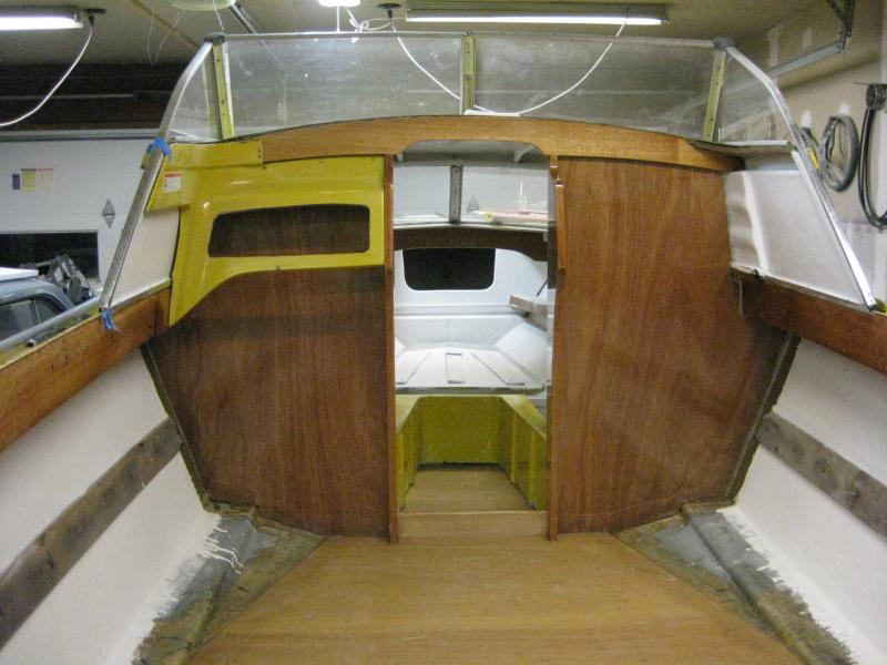

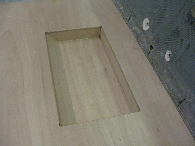

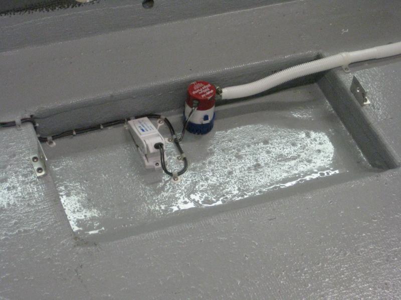

                The stringers are already in I used 7/8" thick Marantie. I radiused all of the bottom edges that hit the hull. I glued and fastened all of the stringer assy and then removed it from the hull I then layed down large beads of 5200 and bedded the stringers in that. After the 5200 set up things are real firm. I then fiberglassed the stringers in with matting. As you can see from the pics I also made a dry well under the engine dry well, pics of the bildge pump and float switch later on that installation. I epoxed and screwed the floor to the stringers and cross supports. I glassed the edges with a 6" wide stranding and then covered the deck over lapping the edge taping with a heavy sewen layerd glass cloth. I had purchased 5 gallons of resin and have less than a gallon remaining.

                    Like the dry well. Will you be able to get to it for that last bit of water the bilge pump always leaves behind? Want to do that to mine as well, but want to keep access to it.

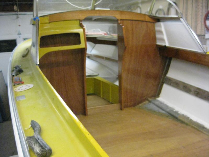

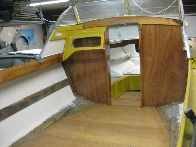

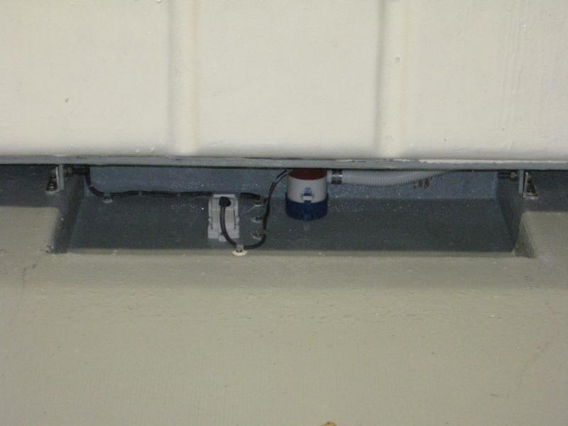

                      My wife and make a good team and progress projects quickly but not as fast as this thread may appear. we are further along and have been showing a little at a time. Our last project was a total gut and rebuild of a 1965 24' airstream. This project was taken clear to the frame with frame repair and new floor plan in 7 months. The following pics are of the new bulkheads, I used marine grade 5/8 Marantie and 4/4 Marantie lumber to construct them. I also replaced the header piece because it was cracked in two places and had separated from all of the fiberglass. The old bulkheads were totally rotted out at the bottom. Also shown is the bilge pump and floot switch install. The motor dry well is only sitting in place, will reinstall it after paint.

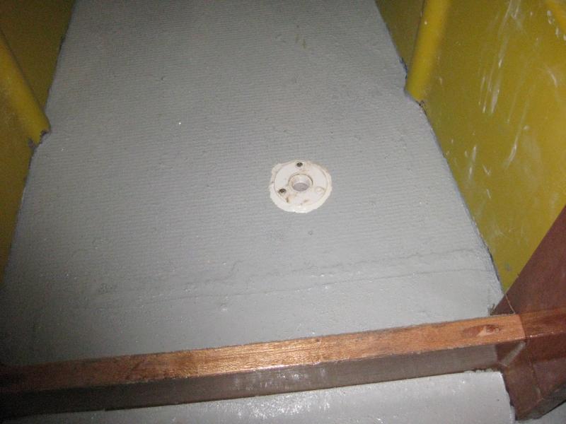

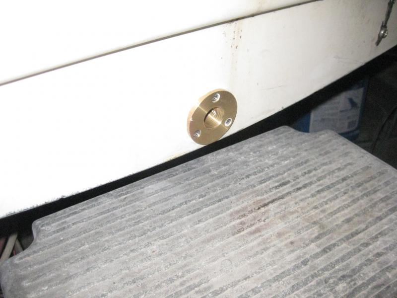

                          The under floor area on the Seafair is a sealed area, I drilled a 1" holl in lower transom area and installed a brass drain plug. I used the factory nylon type 1" drain plug in the forward floor in the cabin in its original placement. No water should get in but I now have a way to drain it if it does. I also coated all of the stringers and cross supports with resin as well as the bottom and edges of the marine plywood before laying it down so dry rot will not be a problem for as long as I have the boat. I believe with your Chris you dont want to seal it up you want it to breath.
