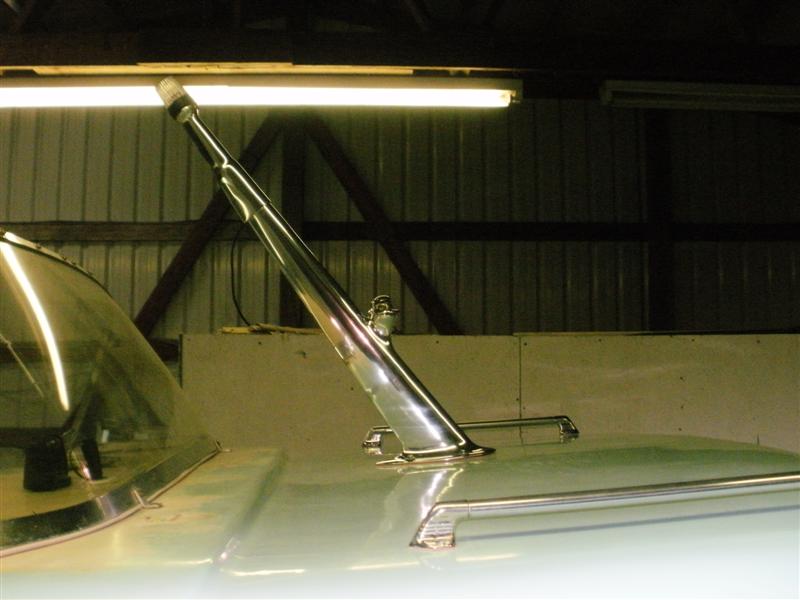

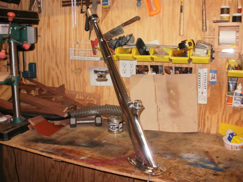

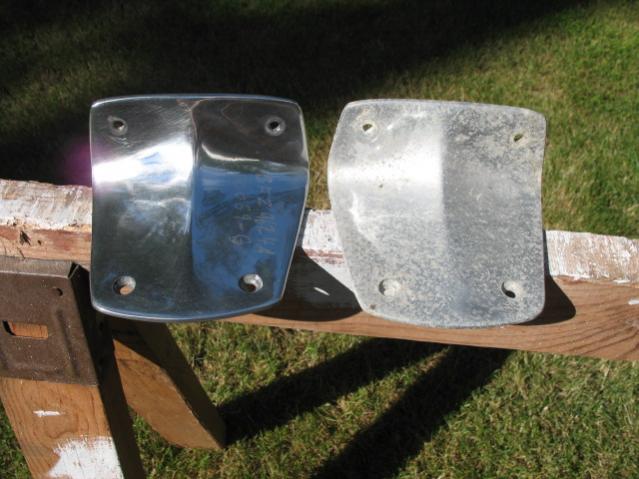

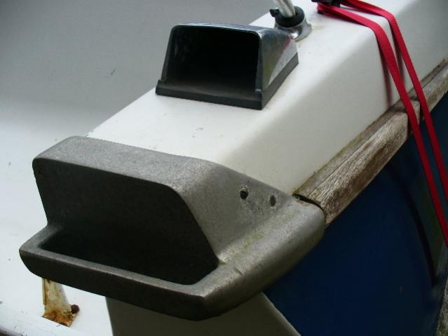

      Here is a sample of what I was able to do after one of Marty and Joe's workshops several years ago. The process is pretty much as Tim explained above. I may be sick, but I find it to be a lot of fun bringing the old parts back to life. Have fun with it.
