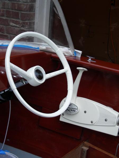

        We did the wheel on our Tolly craft with a rattle can of primer and one of white. Even changed the wheel from black to white. Going on the third season and it seems to be holding up very well. Like most of the work on vintage items, the prep is 90% of the battle. If you take your time to prep and fill little nicks and scratches, it will turn out great!

            Thanks Brian. Great looking job. Will take the extra time with the prep.
