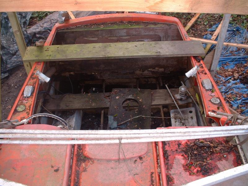

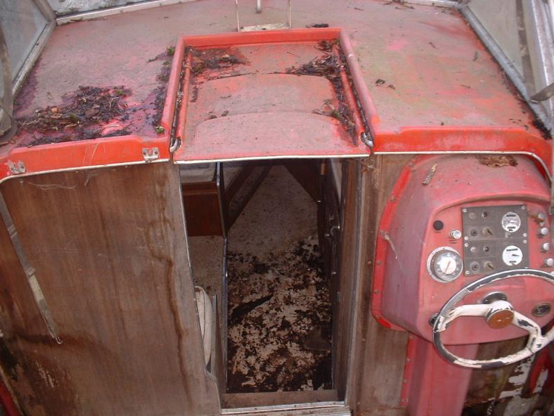

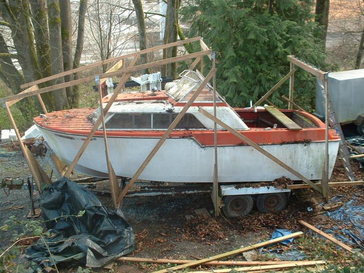

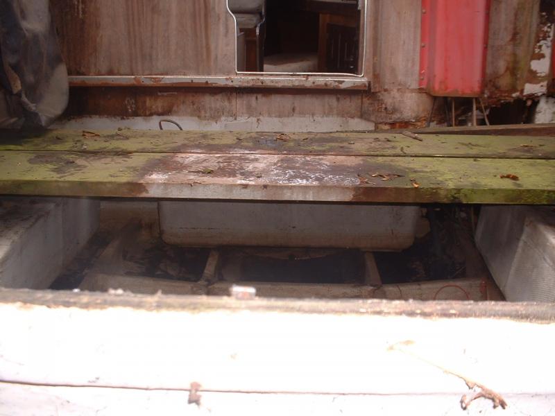

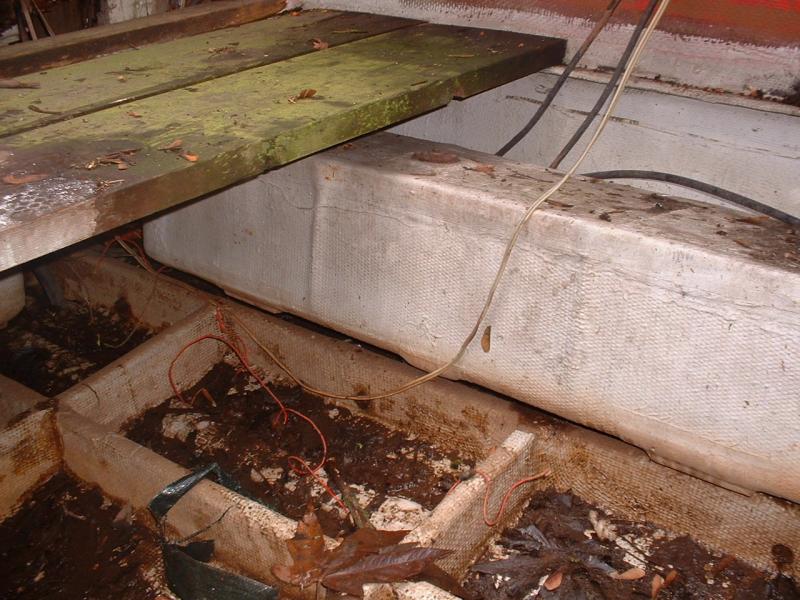

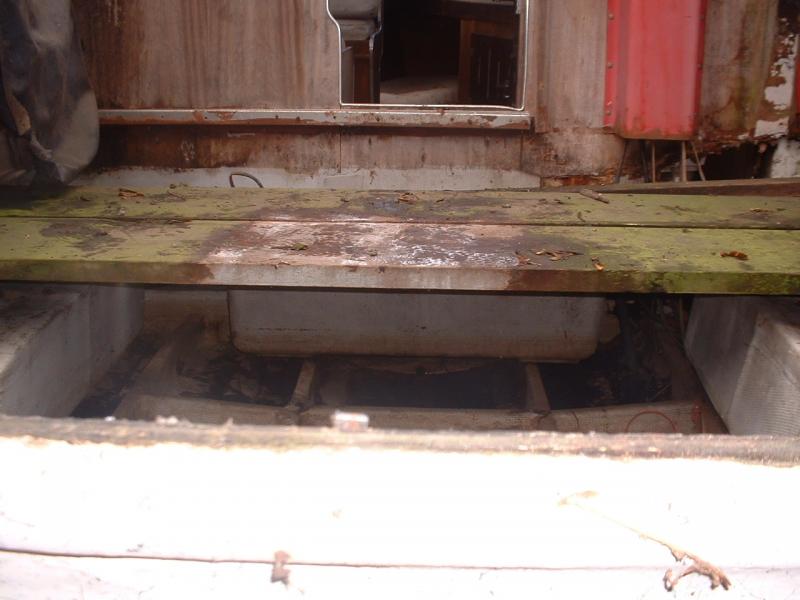

      Karl, I would take a scientific approach and being I am not a scientist, heres my 2cts. I would try to limit the side to side rocking. I would think that the more weight under the floor the better. I was actualy thinking of converting the old sattle tanks into balast tanks and filling them up while in rough water just to keep the boat from acting like a big bobber. This experience is from the Skagit 20. This would be a guess. I would build tanks to fit the individual sections under the floor. I have been thinking about this since I bought mine so many years ago. Its being prepared to sell so here are some early pictures. Do you have the same amount of room under your floor? John

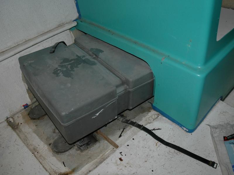

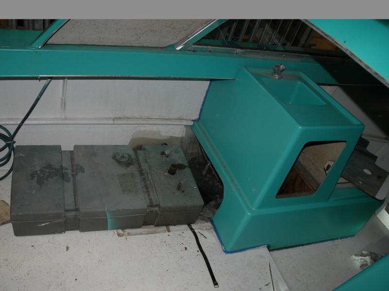

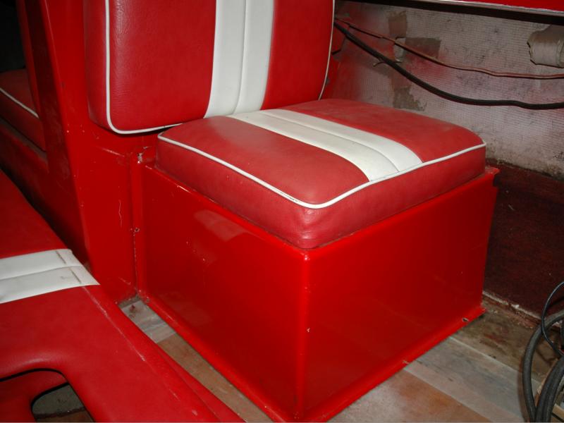

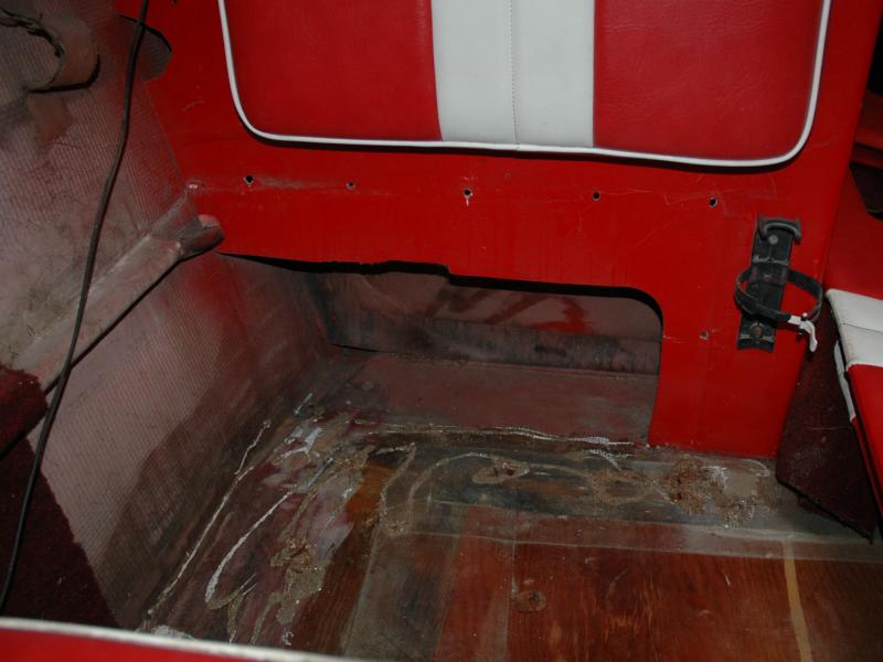

              The 1961 Skagit 20 (Loken version) had 16.5 gallon tanks under the back of the front/sink/back seats. Green pictures.
              The 1961 Skagit 18 (Drake version) had 12 gallon tanks under the back of the front/back seats. Red pictures.
              In both boats the tanks were mounted on rather than below the floor. There were two side fills on both the 20 and 18 models.
