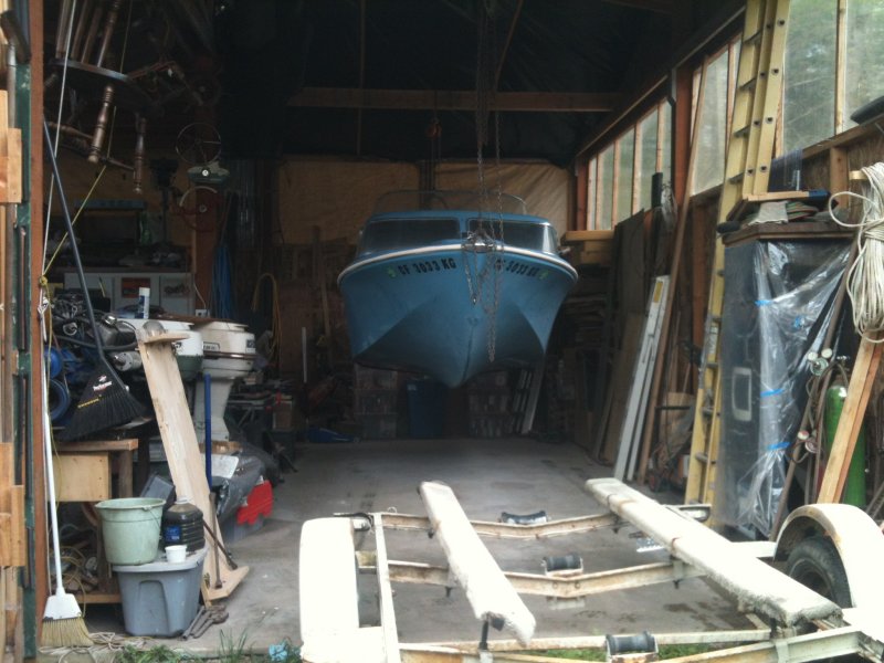

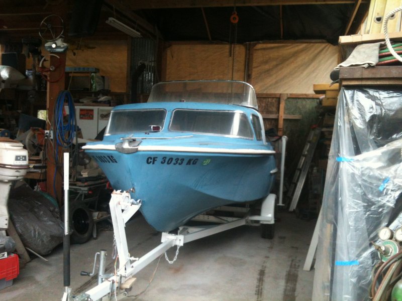

    First things first, no trailer so I need to refurbish a trailer for it. This one I will be running in Oregon so no worries about salt as she will never see it.
    My friend Super Sportster is willing to help with putting together a short shaft Bearcat engine for it with parts from some of my supply and mostly his.
    So, I am working on this trailer and seems I keep getting deeper and deeper into it and then say, what the hell, do it all the way or nothing.
    So, up on the stands the trailer goes, new sealed lights, new bearings, races and seals, new buddy grease caps. Few rollers to replace, bunk pads were shot, Lots of rust so sanding, more sanding, then dug up my paint rig and shot some X-0 Rust primer paint to kill anything I may have missed.
    So Primer, paint, more paint and now she is looking pretty nice....

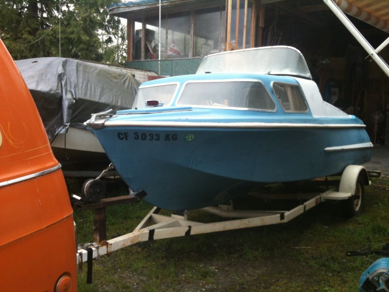

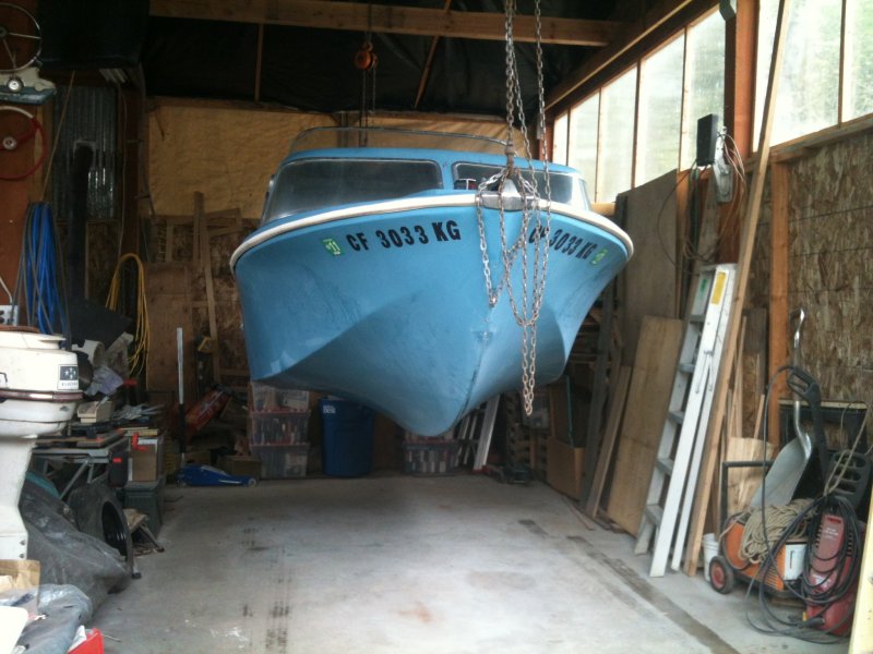

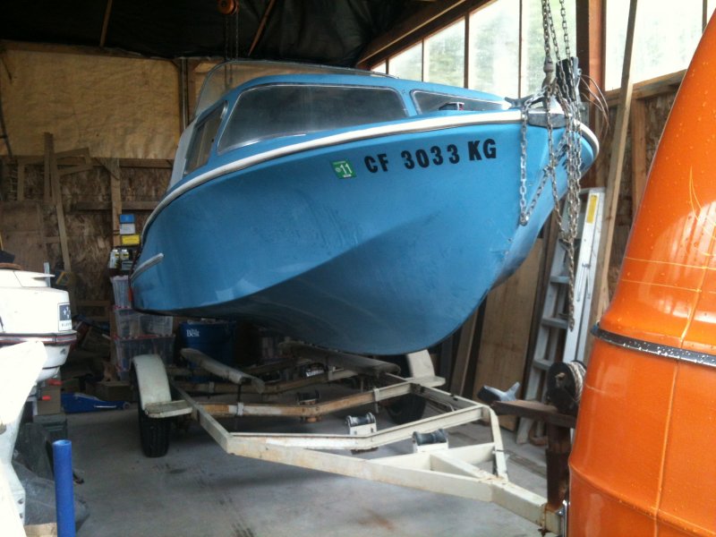

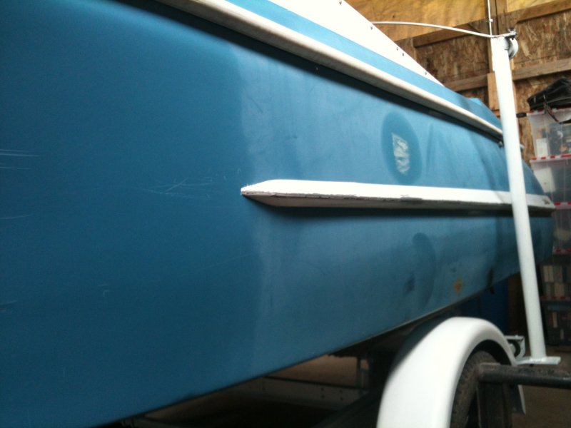

    Back the Dorsett in and hang her from the rafters only to find out, man, this is really oxidized bad, in fact, looks pretty nasty.

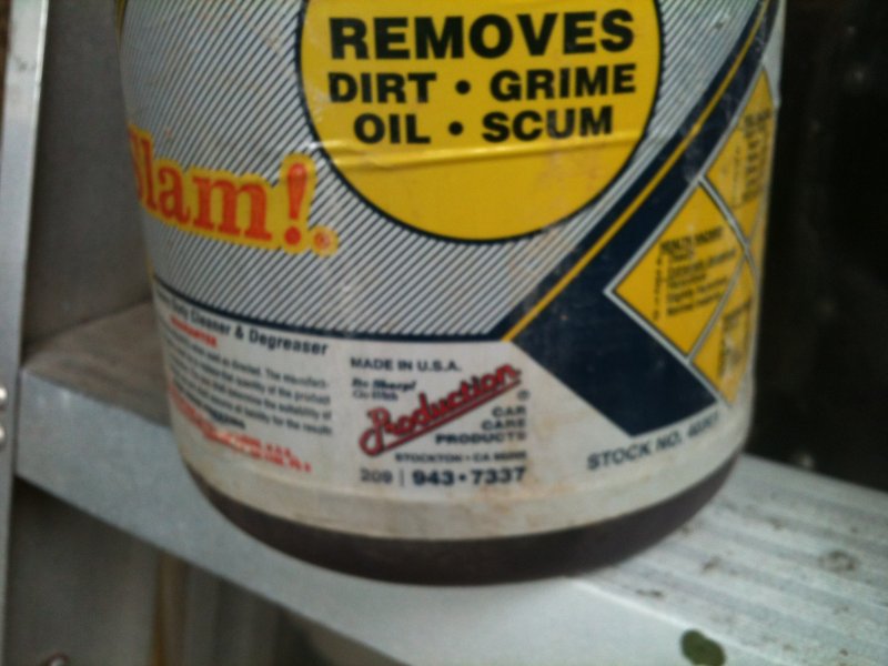

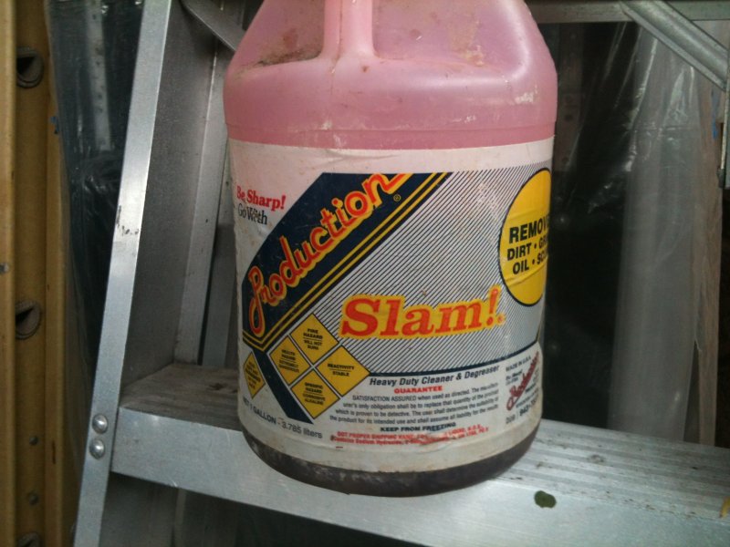

    So, out comes the Production Slam product, 20 to 1 mix, scrub it on, whip it off and Wholly Crap, I forgot how well this stuff worked..
    As you can see, it worked very well. And, the finish is Dry, not wet to make it look shiny or darker, its Dry and clean.
    The plan was to drag it down to the Sandy Oregon Resto shop were I am teaching this trade to my Sons. I will have a full shop set up like I have up here.

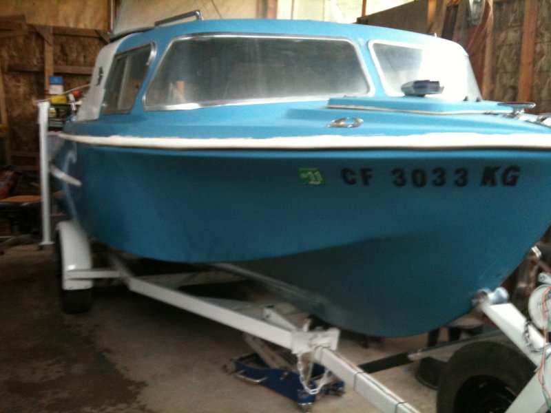

    Only thing, the boat looked really crappy on the fresh painted trailer.
    So, inventory time, yet, go most of what I need in parts to put her in the water this summer.
    Work in progress...

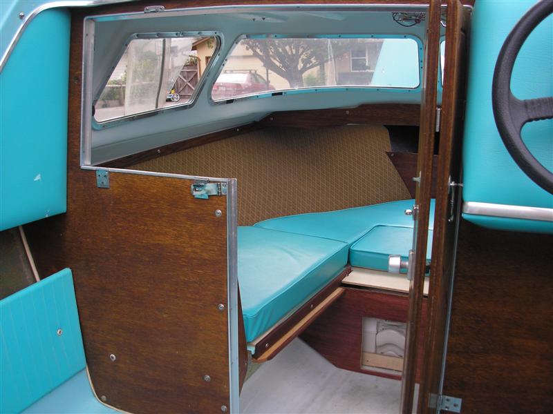

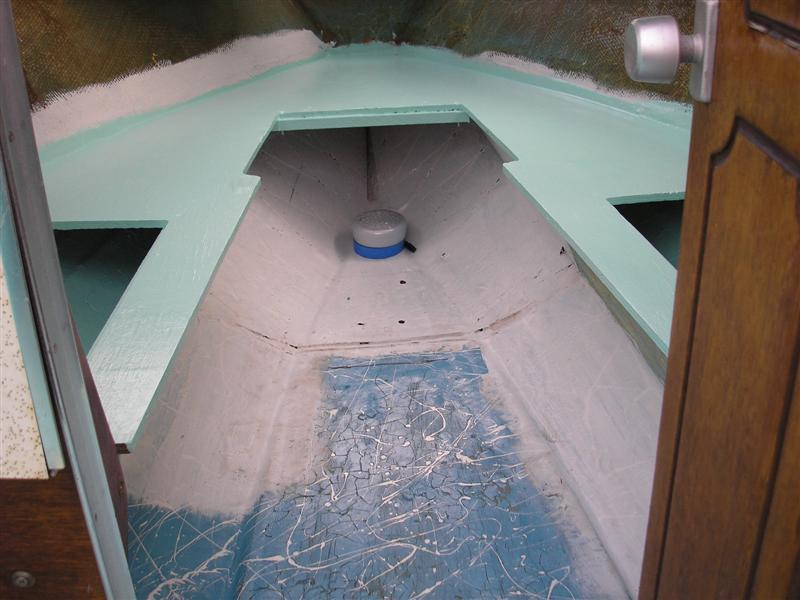

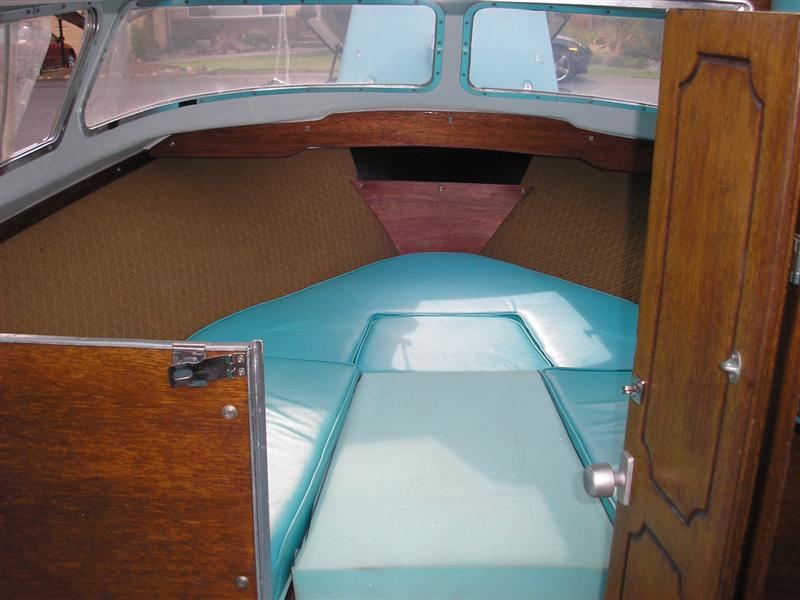

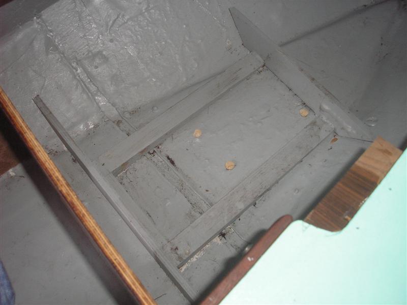

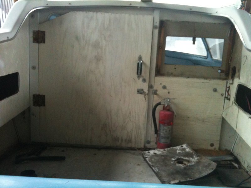

    Oh, Rick, do you have any pictures of your cabin door or the layout??
    As you can see here, I mean....Damn.....
    I have No idea on what this person was thinking..Home depot special I think.

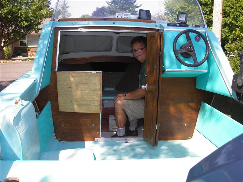

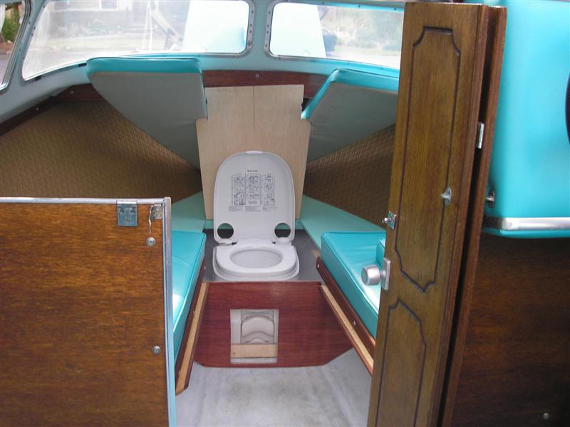

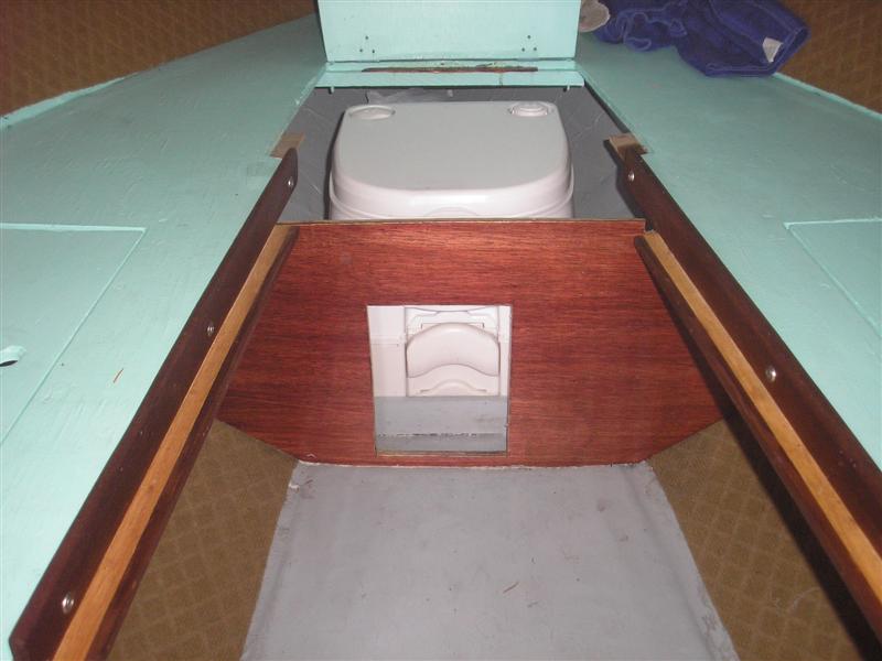

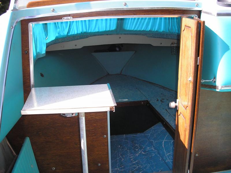

        Looks to be in decent shape , Yeah that cockpit is a trophy , Here are a few shots and I have not searched the threads but I'm sure if you look back there is a thread for when I installed the head in the cabin. It was pretty easy to cut out the bow plate and pull it aft a few inches and a porta potty fit in the bow pretty nice. I'll send some more shots later - Have to get up early tomorrow to go to the N.R.A. Convention in Chicago - No guns - National Restaurant show I'll send another batch when I get back. Good luck Helmar
          Thanks Rick.
          I will open that door and get a better picture as it looks quite different than what you have...
          I really like your setup..
          This one is a large opening on mine or at least the framework is still in place...
          Yes, more pictures when you have some extra time :BigHappy1:
