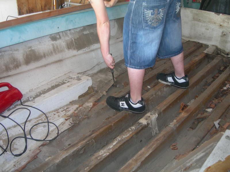

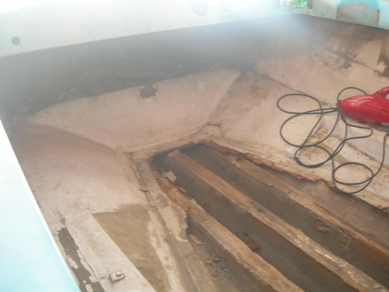

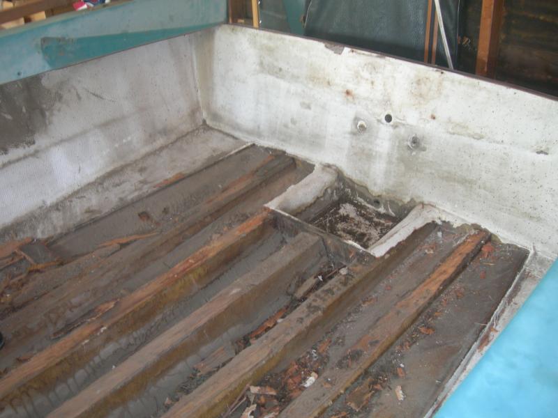

I went through the same ordeal last summer on my "saved from the dump" Fiberform 16 footer. When you get around to glassing the new floor in, don't forget to squeeze the hull gunwales inward to the approximate width of the deck; like with several webbed straps around the whole boat. At least be sure to measure the overall width compared to the deck. The naked hull will relax slightly without the deck holding the gunwales in toward the centerline of the boat, even with supports under the chines. Once the new deck and poured foam is installed, the hull will become semi rigid again. I had to cut relief slots with a small circular saw along the edges of the new floor because we couldn't get the sides to flex inward enough to install the deck. Huge downer for sure; spent (wasted) two days on what should have taken an hour, or so.

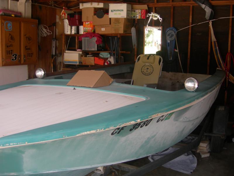

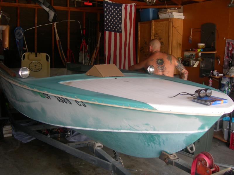

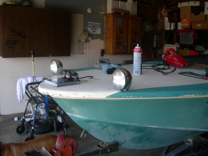

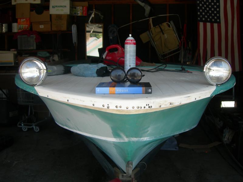

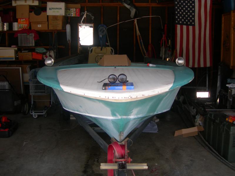

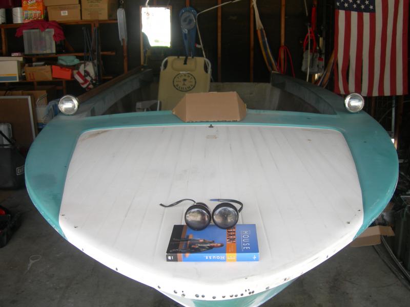

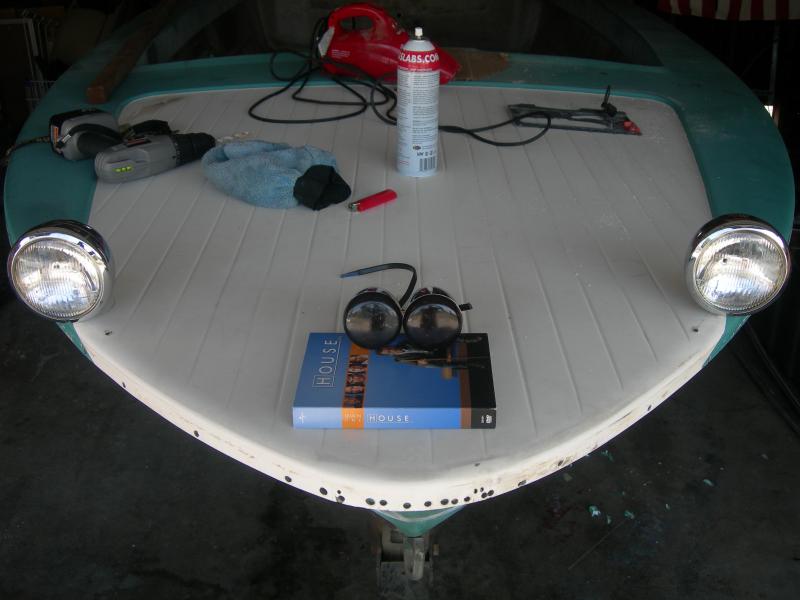

1st pic is what im thinking on the bow light one red one green, and some harley headlights for spotlights ...
the cardboard in pic 5,6,7 is what im thinking of building up on the bow to hold gps fish finder etc and going with two tiny windshields..
I like your custom dash housing, seems like a cool stylish way to house all the electronics and protect them from weather. The "spot lights" on the sides is not a good idea, from experience with my ski boat and its hand held spot light at the windshield, the lights are going to light up your bow and make seeing flotsam in the water nearly impossible!! That's why you see newer boats with searchlights mounted way forward on the bow or even up on handrails. Or like the new ski boats people mount the lights down below the rub rail so that the light hits the water and not the deck...Brian Flaherty
So thats better, but I would only suggest moving inboard (toward center) enough so that potential docks won't wipe them off the deck. Spot lights / headlights are always a challenge to install because what looks aestheticaly pleasing is usually not functional and what is functional usually looks like crap...
Our Chris Craft has a dash mounted handheld spot light that we use a lot but I have to have my passenger stand up and hold the light as high as possible or it just lights up the windshield and bow so much I can't see the water...Brian Flaherty
Ask yourself this: How often do you plan on running at night? Once or twice a year would warrant a handheld. More often would warrant something on the deck. They do make lights that can mount in the bow that are flush. Might look at that. Or you could try to find a vintage piece that mounts up a bit.
On my Marathon, I don't use any lights. On the Bell Boy, when it is done, I'll have a single light mounted forward, mostly just for fun as I am not out at night much.
Regardless, whatever you do, make sure you use stainless steel components, or heavy chrome, or aluminum. Cheap pot metal from the auto parts store will just rust out here in the salt....John Forsythe

Got a 100hp johnson that runs, may need a tune up though but not right now it doesnt and its in great shape..Post pics of it later today right now im grinding on the floor.
