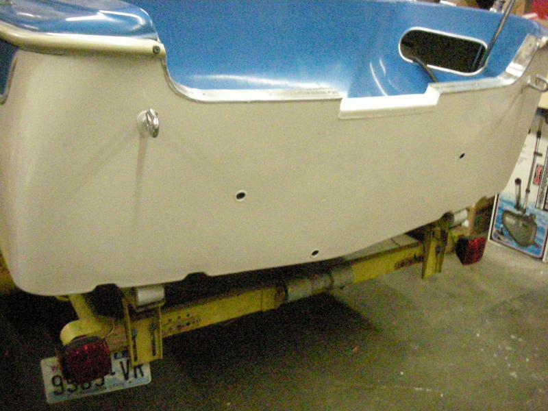

    Stern after first coat.
    Here's a picture of the stern of the blue boat after application of first coat of epoxy.
    The first photo epoxy was totally dry at this point. I then started to apply a second boat and it went fairly smoothly. These two coats should be more than enough. Here is a picture of that effort in progress.
