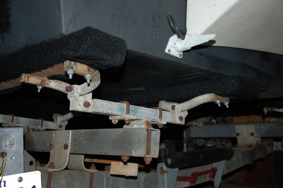

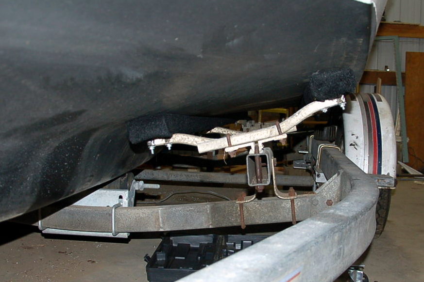

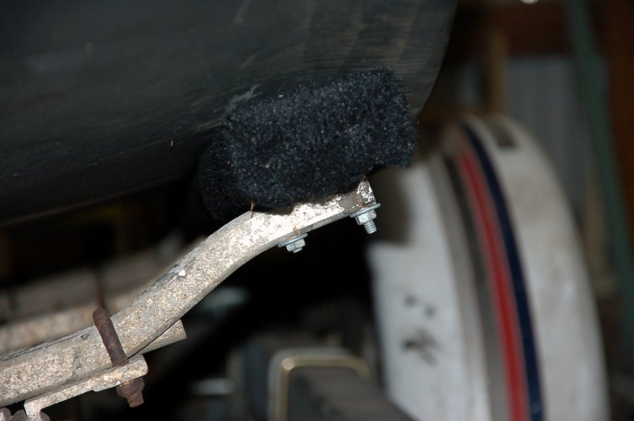

                I converted my trailer to bunks and it was quite easy. The boat was left on and it would be easier with it off. First a 2X6 with bunk fabric was inserted in the are between the rollers. Snugging it up with 2x4s and wedges. Then I jacked up half the boat up with floor jacks until there was enough working room, 6" should work. Now raise the bunk and support it. This way I knew it would not come down on me. Take of the rollers and drill out to 9/16. Position the new bunk. and drill. Check to see if you can put the bunk in with the bolts in. Some will not, make adjustments or remove them. With the carriage bolts in attach bunk fabric and install on trailer.
                    That has to be the simplest conversion I've ever seen... I never thought to use the roller racks that were already in place (of course mine where in really bad shape from sitting 32 years unused next to a lake)
                      I was looking at install only two bunks. Putting bunk brackets to where the roller racks were installed.
                        Yeah but you saved some coin doing it the way you did. How has it been working for you overall?
