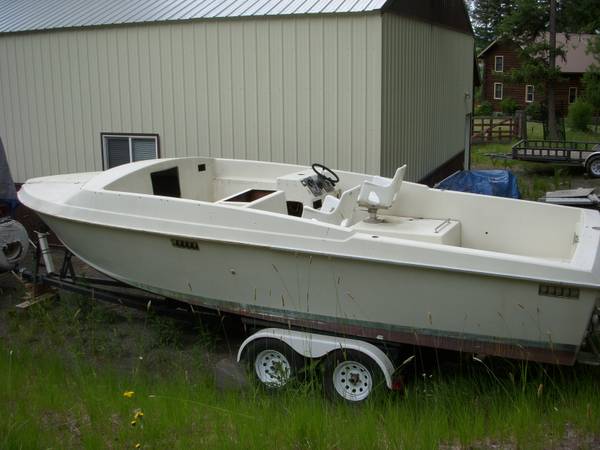

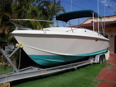

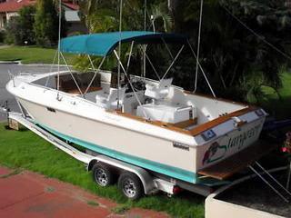

    So this is my new project a 1973 25' Chris Craft Tournament Fisherman. She is 9'9" wide, powered by twin 181 Chevy's and direct drives. It is all there right down to all of the hard to find trim. One engine was just rebuilt over in Port Townsend and the other I am going to re-ring just to be sure. Its a pretty interesting layout really. The last two pics are of a restored one

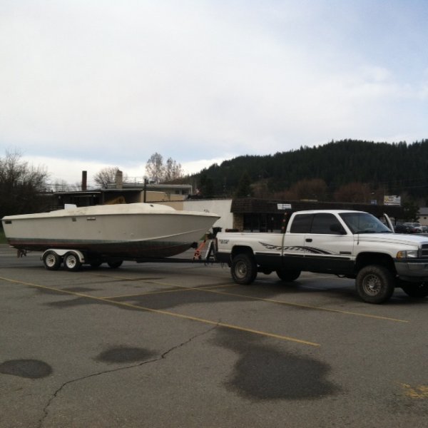

                    A little update, I finally got the rest of her back to the house a couple days ago. For an open style boat she really makes my truck look small. Hopefully get the hole in the bow patched up and motors dropped in here in a few weeks. Name change is top of the list.
                      Wow Nick, your truck looks like a toy pulling the boat!

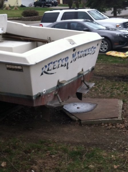

                      Why the name change?
                        Haha, definitely change the name! About as bad as the '69er" that my Bell Boy came with!
                          Ha Ha, nice. Thinking "SMUGGLERS BLUES" though. Throw back to Miami Vice...
