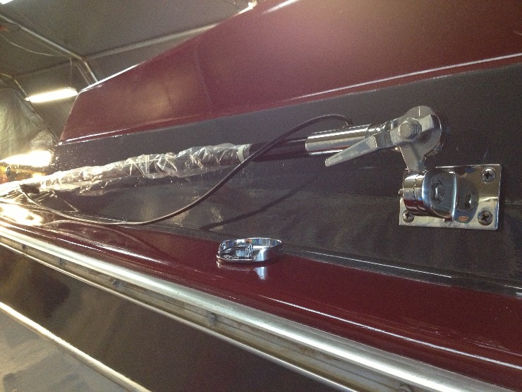

        Looking good! What brand is that antenna? I like the look and the way it stows.
          John, It's a 8' antenna from Shakespeare that they call a Classic 5226-XT black. The same one but white is a 5225-XT. I got mine on e-bay as it is about $35-$40.00.00 cheaper and free freight and no tax. WM wants $174.99 for the black in the old 2012 Catalog. I paid about $129.00. I have had about 4 of them in the past and being i like the black rub-rail and the stripe is black too , it seems to go together to me anyway. O yea, need to get a antenna clip on the end so it does not bounce up and down going down the highway.
          This is what Shakespeare said's about it:
          Shakespeare Galaxy Style 5226-XT 8' VHF 6dB Gain Collinear-phased 5/8 wave elements EXTRA TOUGH!This antenna is the same as Style 5225-XT but with the exclusive Galaxy gloss black finish. It's Shakespeares best maximum range and quality in a great looking Galaxy antenna. The new 5225-XT is Shakespeares classic Style 5225 in a new stronger stiffer radome. Its extra tough for use on hard tops T-tops radar arches or wherever its extra resistance to high winds and high speeds is welcome.Brass and copper elements for maximum range and efficiency Stainless steel ferrule with standard 1"-14 thread20' RG-8/X low-loss cable plus a PL-259 connector Suggested mount: Shakespeare Style 4187 Ratchet Mount One section Shakespeare Limited Warranty: 5 years Technical Specifications:Frequency:VHF Marine BandBandwidth:3 MHz within 2.0:1 VSWRSWR: nominally 1.5:1 at 156.8 MHzImpedance:50 ohmsGain:6 dBMax Input (Watts):100 watts DC Ground:YES Height (feet):8Polarization:Vertical Product : SHAKESPEARE VHF 8FT 5226-XT BLACK Manufacturer : SHAKESPEARE Manufacturer Part No : 5226-XT UPC : 719441200237
