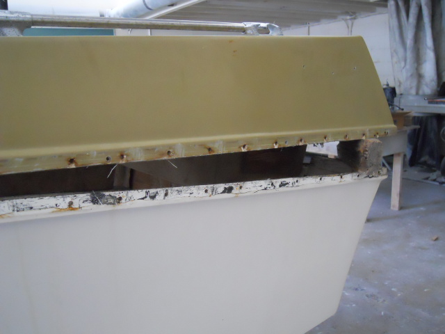

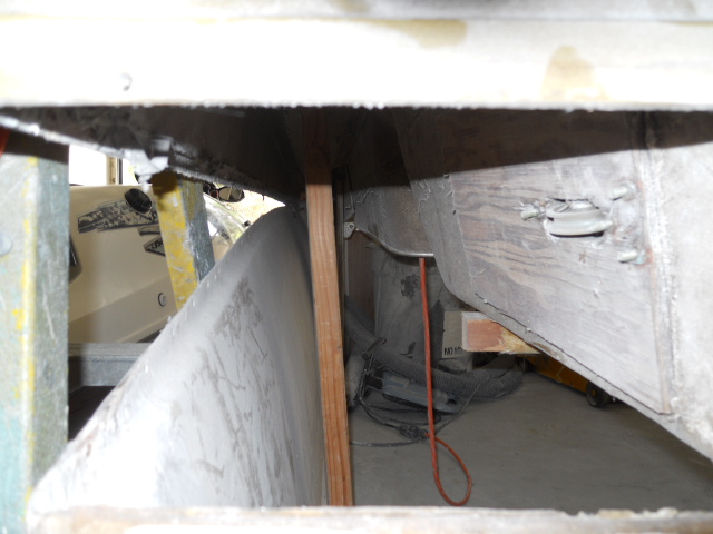

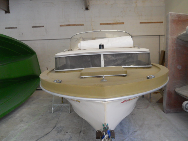

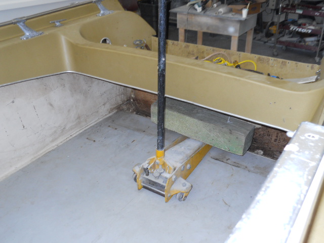

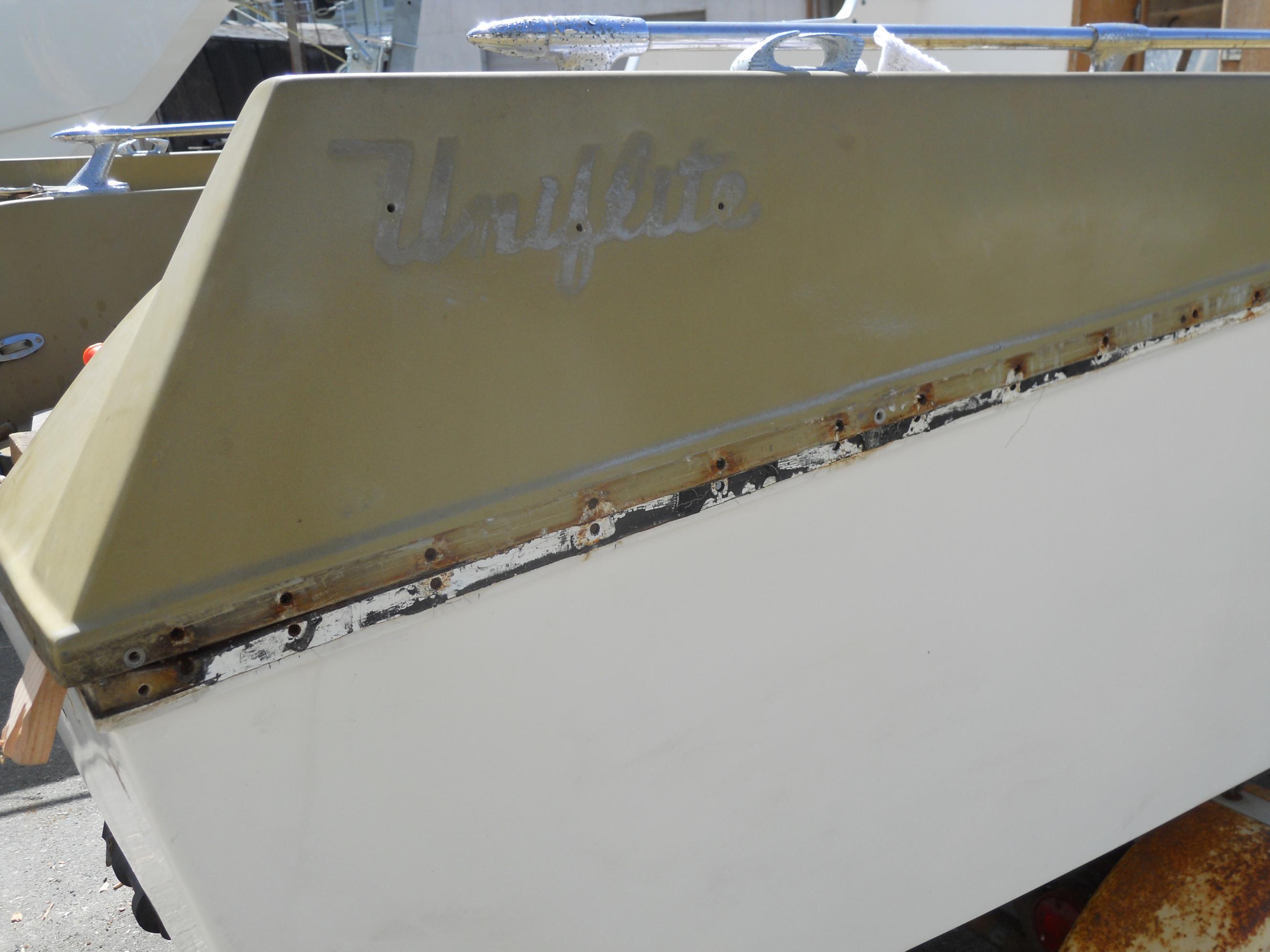

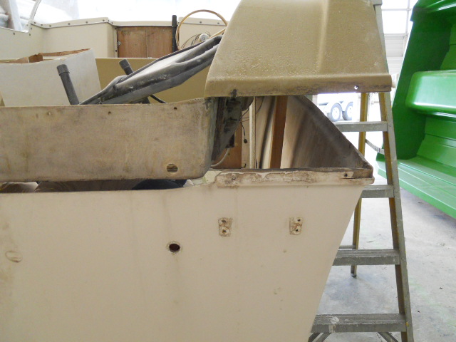

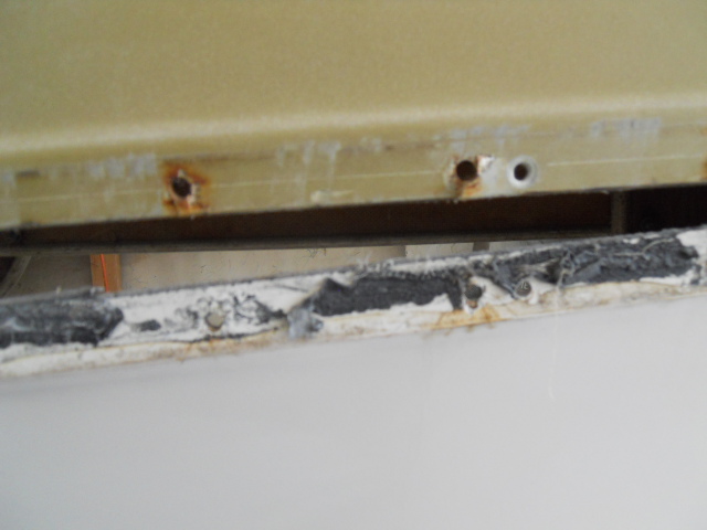

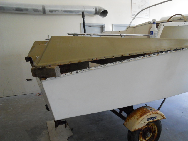

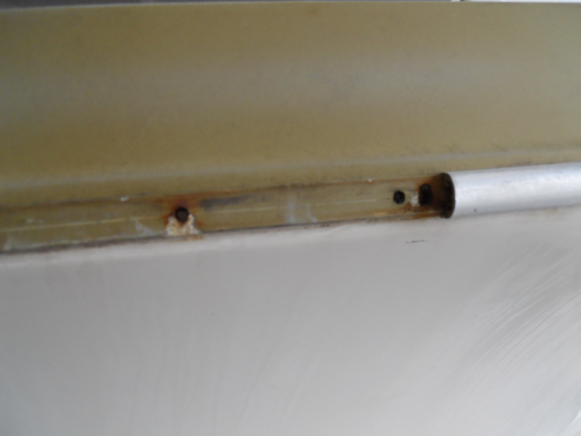

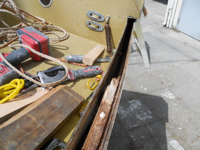

greetings just geting started removeing rotten wood and the rub rail jacking up rear half of spalash well to install new cossa board 1.5 in transom board stringers are ok going to reseal with 3m 5200 sent the 2 uniflite badges to the plating shop in ohio going with what i got cheek out my pictures
17ft express crusier uniflite
17ft UNIFLITE EXPRESS TRANSOM

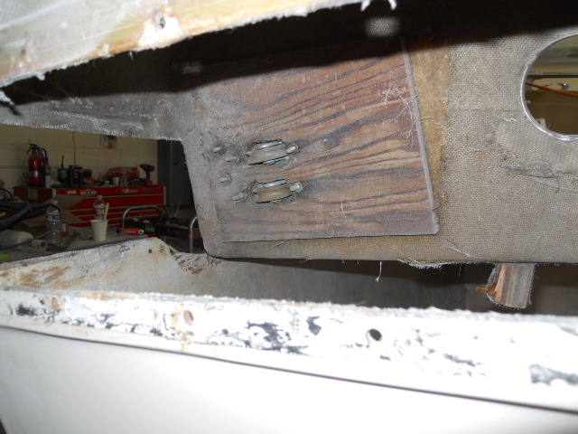

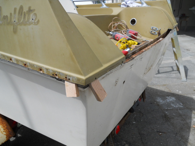

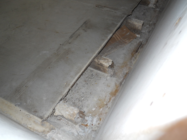

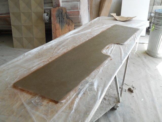

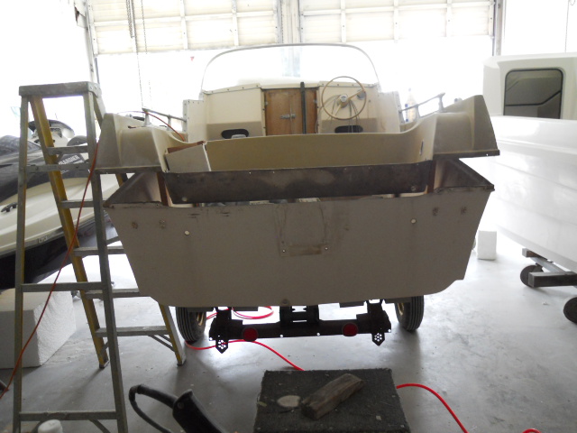

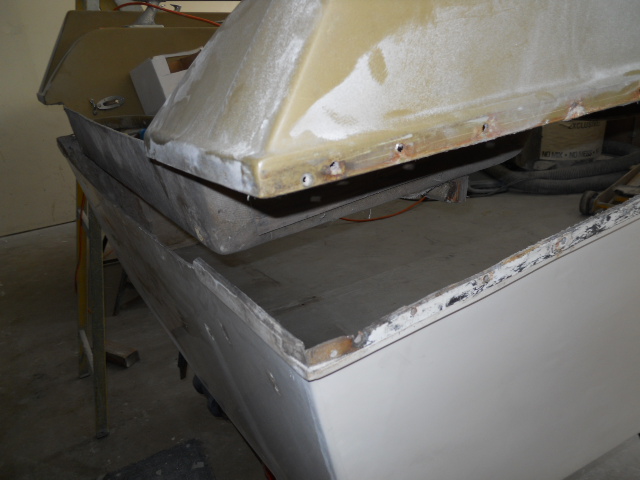

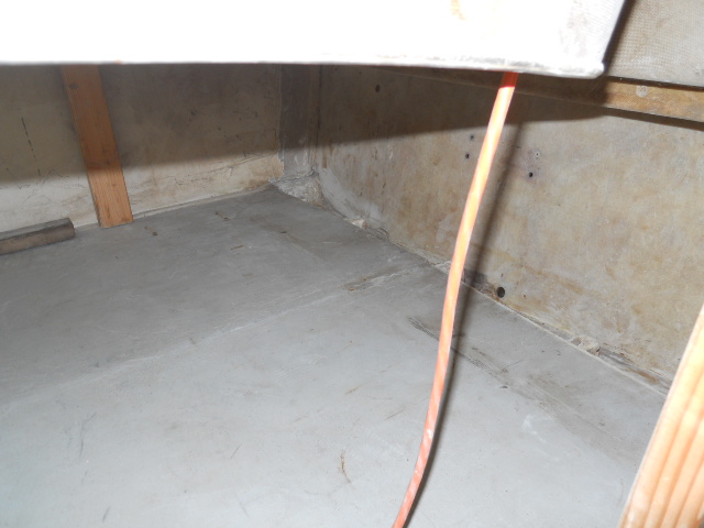

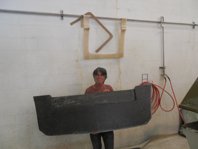

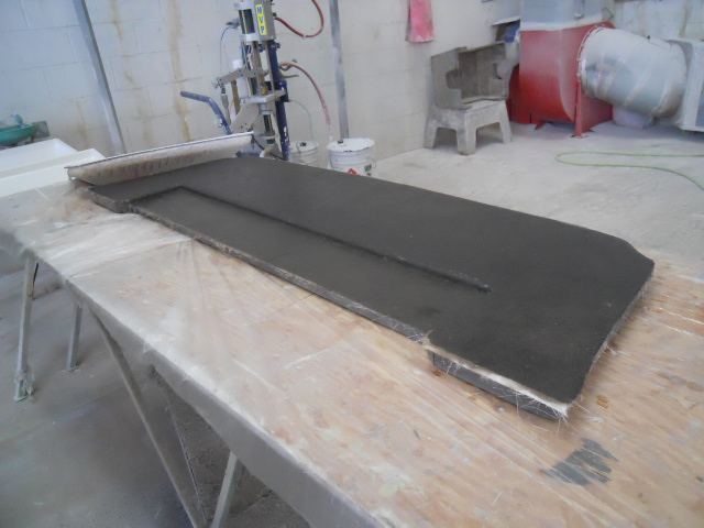

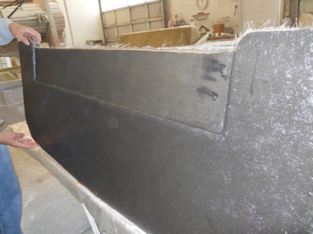

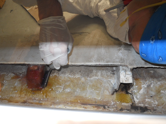

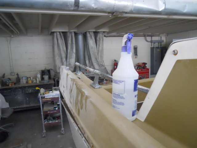

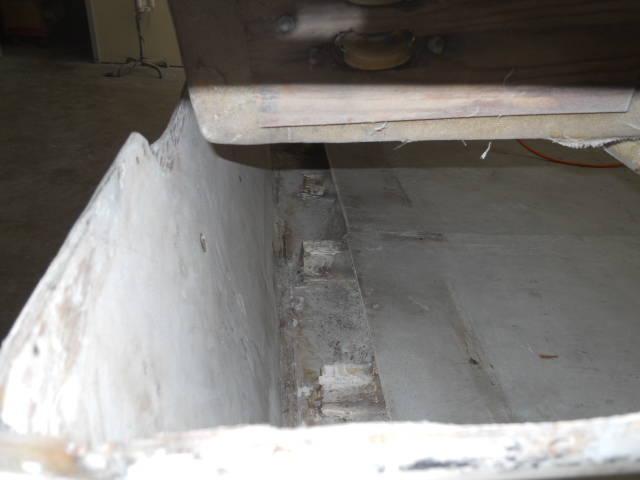

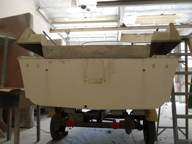

greetings just finished my transom,,, made out of 1.5 in cossa board blue water 26 daddoed out the area for the splash well betwween the rear of the boat tub leaving about 1.25inch thick going to use 3m 5200 sealent between top & bottom halfs of the boat befor installing the rub rail ,,,,,,drilled core samples on the stringers seams to be dry & hard no soft wood so ill leave it for now,,,,, see progress picturesAttached Files- DSCN1544.JPG (131.3 KB, 1 view)

That is looking real good Mike.
I tend to build the transoms out a little thicker for the new 4 stokes but with the cossa product, you can't go wrong.
I think most of John Nelsons transom and the rear of his boat is all cossa board.
If this is the same stuff he is used, it will last forever.Helmar Joe Johanesen

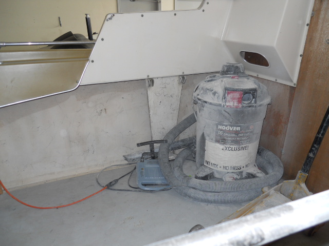

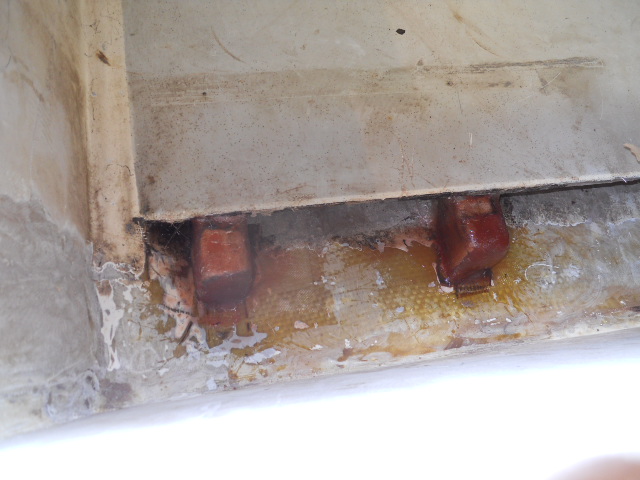

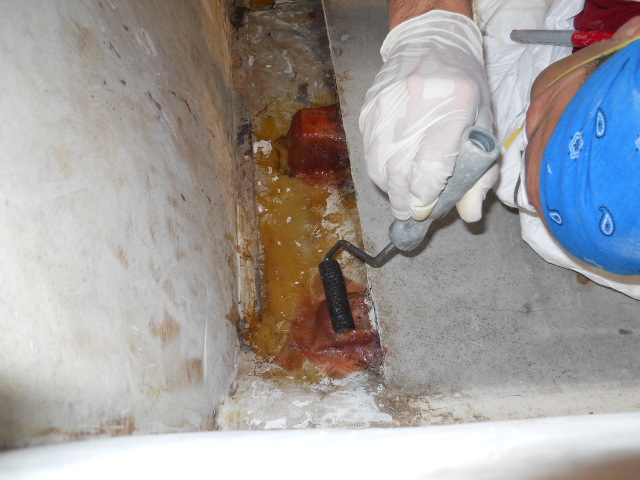

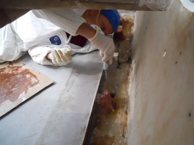

17 uniflite transom replace

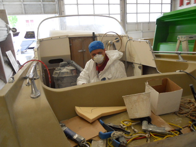

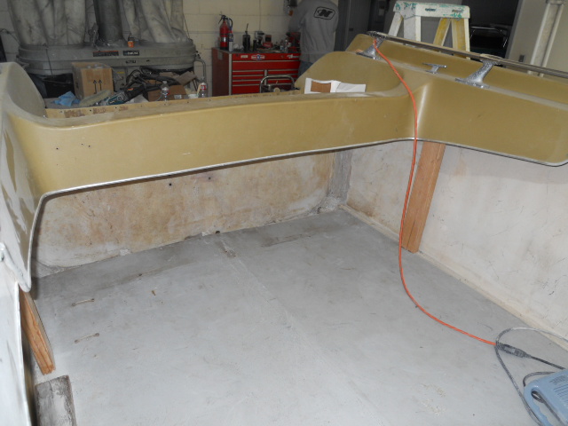

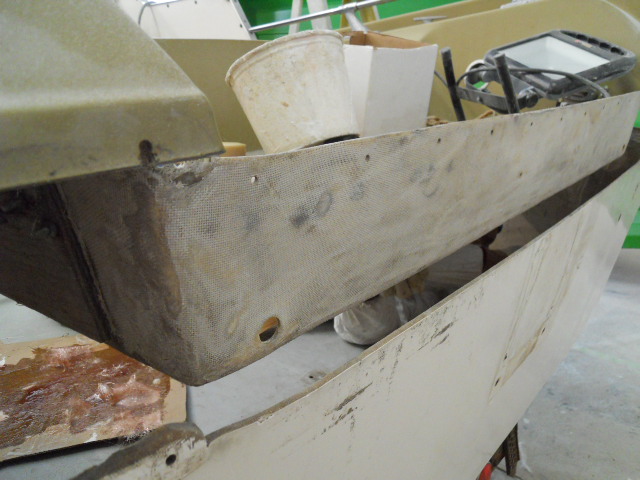

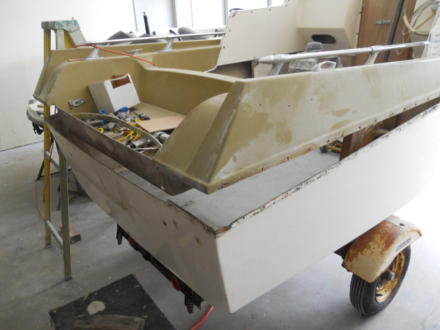

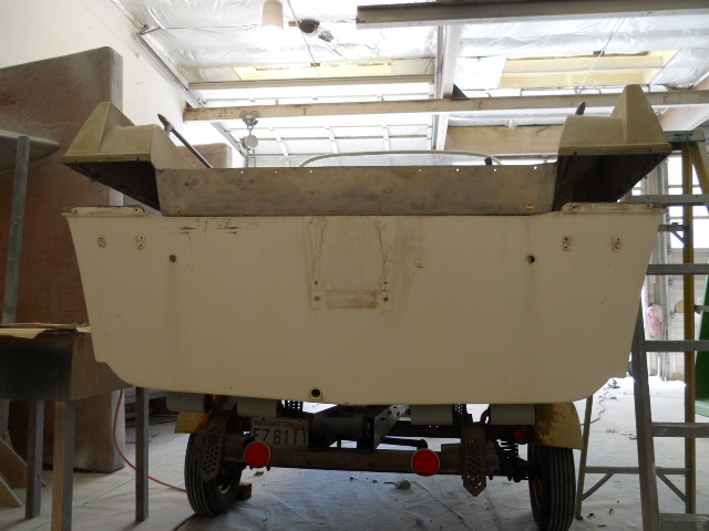

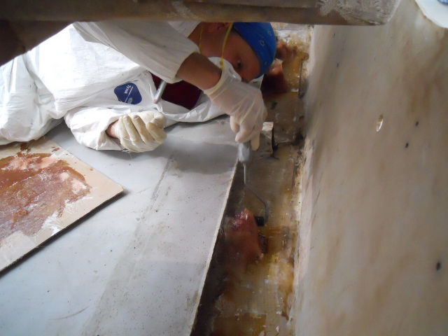

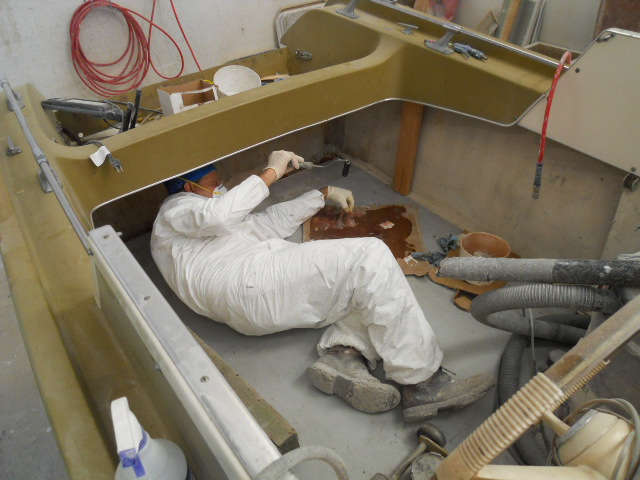

geting closer to installing the cossa board transom doing some more prep today (see pictures)Attached Files- DSCN1575.JPG (142.1 KB, 2 views)

helmar,,,, iam going to reinstall the 1970 80hp mercury its like new had doctor frankmerc in shelton wa go thru it and it screamsLast edited by mike pingatore; 05-17-2016, 02:48 PM.
I have seen bigger ones on stock transoms so no worries.Originally posted by mike pingatore View Posthelmar,,,, iam going to reinstall the 1970 80hp mercury its like new had doctor frankmerc in shelton wa go thru it and it screams
My biggest gripe is the early boats had to run twins to get the speed up and I hate how big the splashwell bucket is.
There is just no easy way to shorten that sucker up without doing major glass work.
I might do that to my Dorsett Catalina as it too has a Very large bucket in the rear to take a large amount of water over the stearn.
Looks as you have a good grip on things as no Adding weight to the back but adding structure. Way to go.!

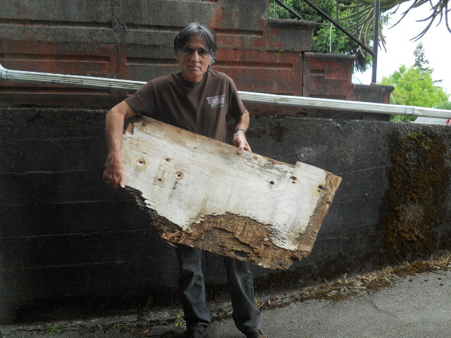

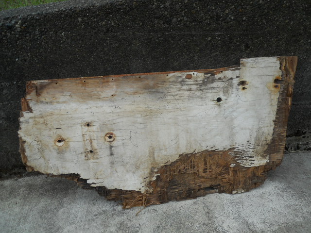

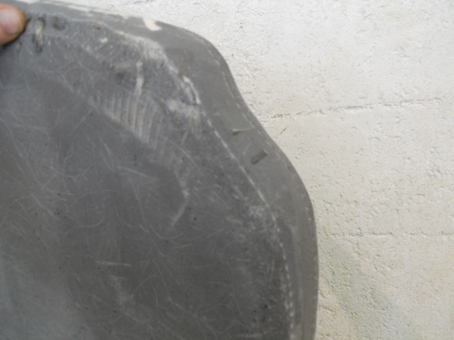

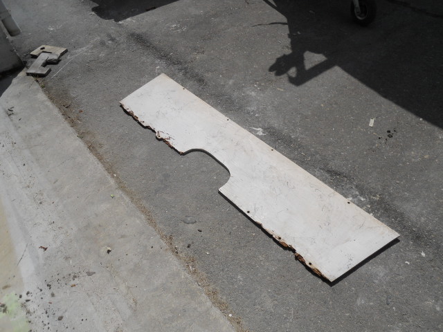

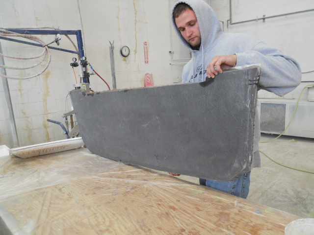

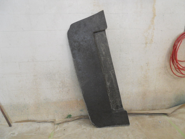

Pretty impressive hunk.Originally posted by mike pingatore View PostWOW,,,,, this is all that was left in one pice of the plywood transom it is very heavy too 1.25in thick (see pictures )
I have seen them come out both easy and hard.
I had several that you could have taken the transom out with a spoon.
Then I have had them were just one corner was rotten but the rest was fine. You can't patch something like that so it too Many Many saw cuts with the proper depth and lots of hammer and chiseling to get them out.Helmar Joe Johanesen
You could totally carve a little off the bottom and have a sweet "vintage" map of the USA! That is a nice chunk... A little odd the rot pattern around the edge seems quite uneven...Brian Flaherty
Im glad to see someone using modern materials. 1.25 seems thin till you realize a lot of the boats had a piece of galvanized steel pipe between the transom and center stringer. I used 5# foam for stringers bulkhead,floor and reinforcing the hull at impact areas. It wont take the clamping force of a motor. I see they make coosa board in 1/4" do you think it would flex enough to layer in an arched transom?
