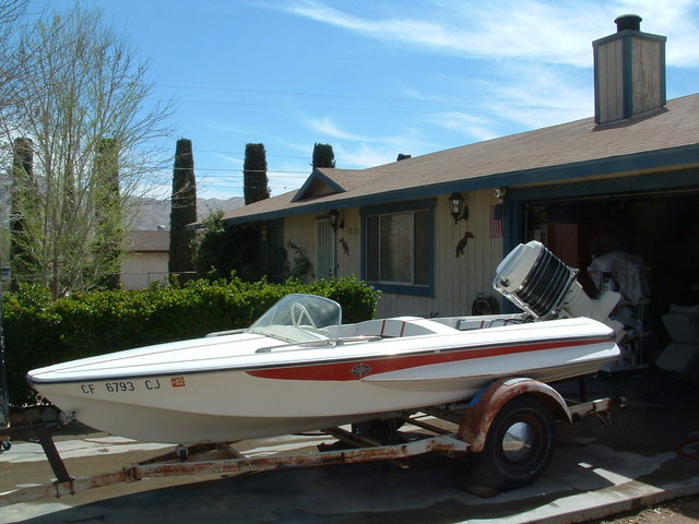

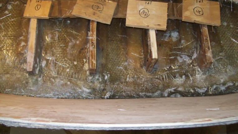

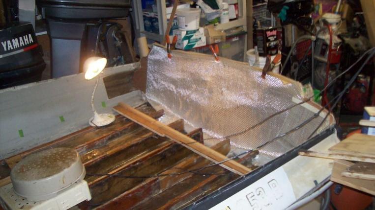

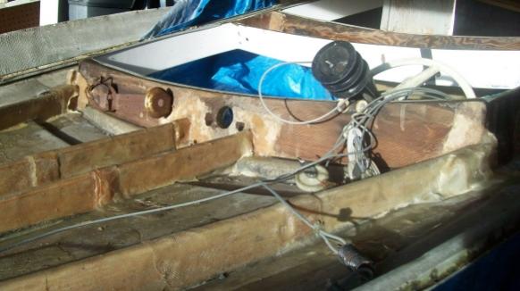

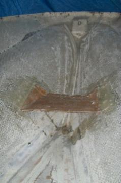

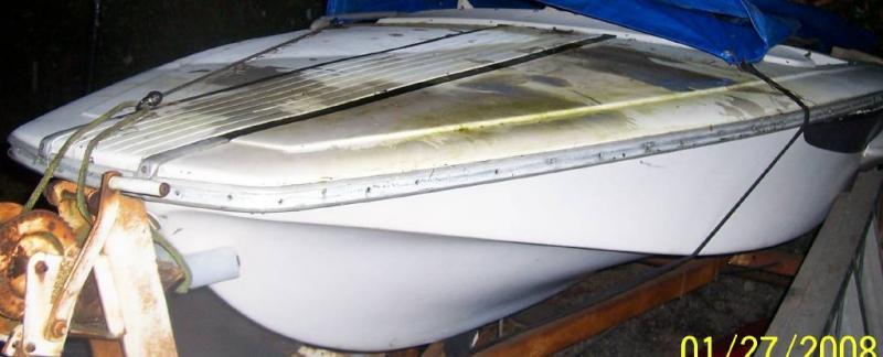

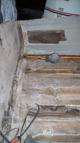

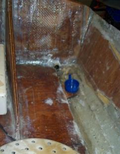

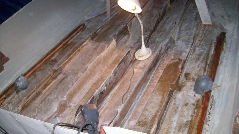

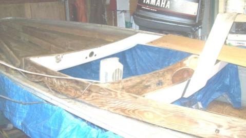

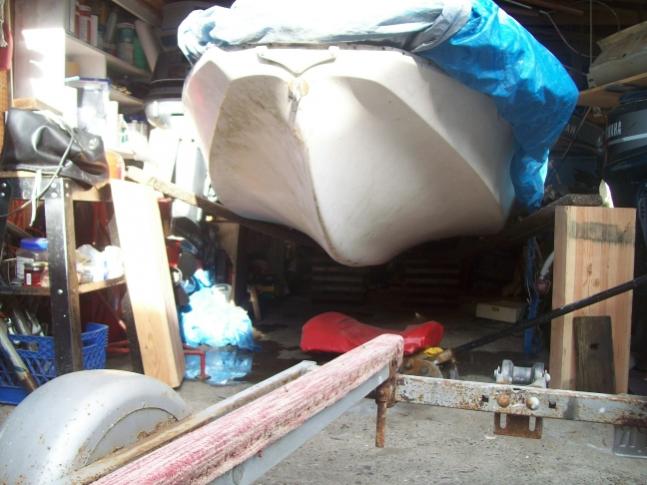

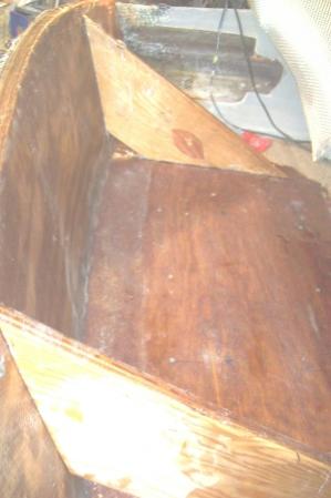

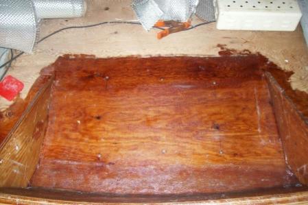

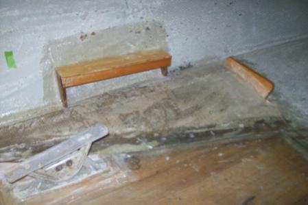

After 5 long years of plotting,my little G-3 ,cousin to Chuck`s Cali Girl,my G-3 is getting anew set of stringers ,transom and with any luck,some floors.

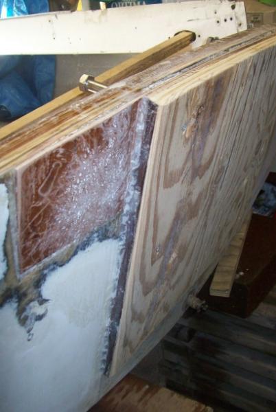

Shell is away from the bottom.

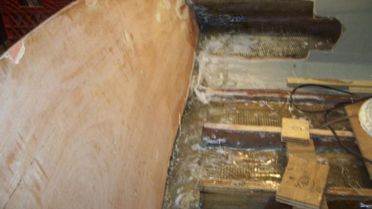

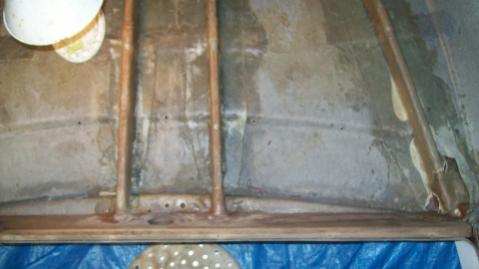

Got the entire bottom free of wood remnants and the peanut butter leftovers.
Thinking of doing the extensions on either side of the motor to help float a V-4 or something to make it really go.
I will be foaming the floor cavity in all areas except the middle which is also getting a fresh slab of structure.
Even rotten ,the wood put up a fight until all of it was gone.

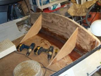

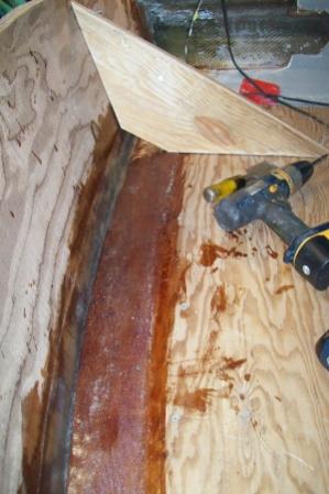

My Salvaged Mahogeny door frames once again have found a new life for the two outer slats,with A/B Marine plywood being used on the 3 main center stringers/Keel.
Tempted to leave some of the old glass to save $ but then again it will add Dead weight.
Weight is the enemy.........
Pics to come,hasn`t been much action of late so here is what I`m doing "For Fun".
Any tips or things to consider would be appreciated.

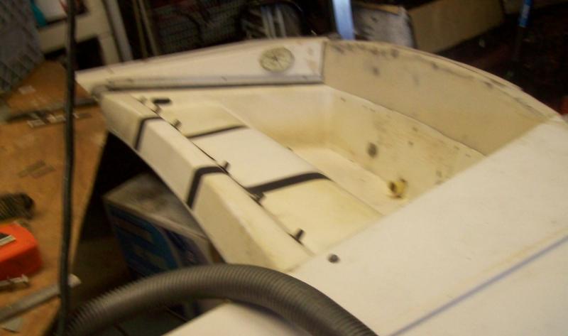

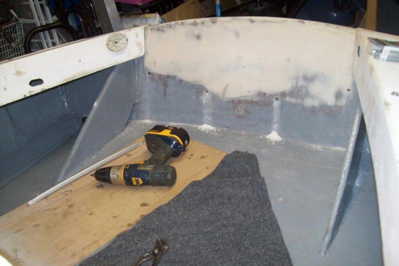

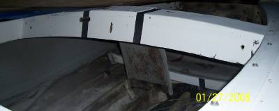

The side pods look to have beauty bark in them so a small opening towards the last foot will be made so the corners can be glassed ,then some foam will fill the voids and give me "Level Flotation" if it gets swamped.
This may be my Slough Racer as the bottom has some nasty gouging already,not a show pony by any means.

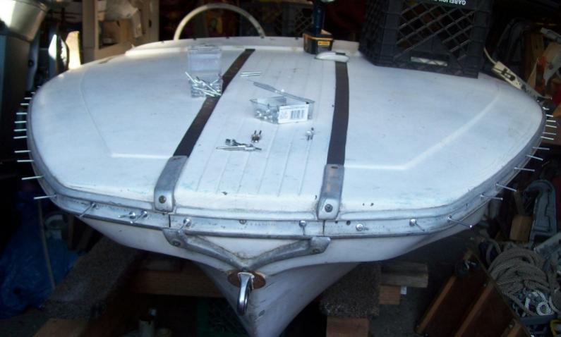

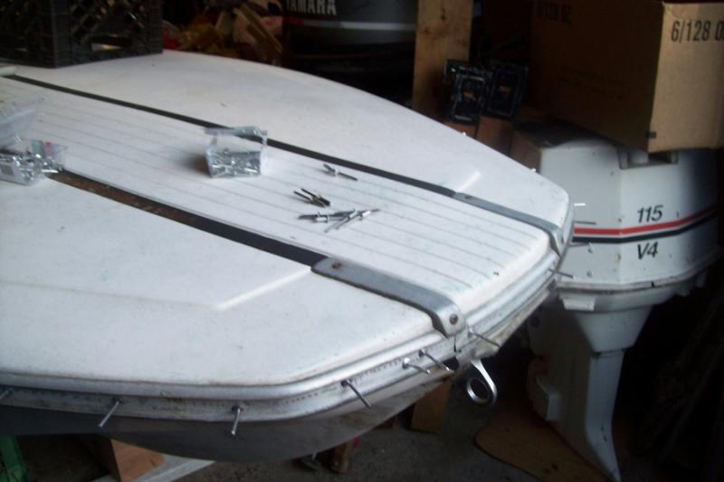

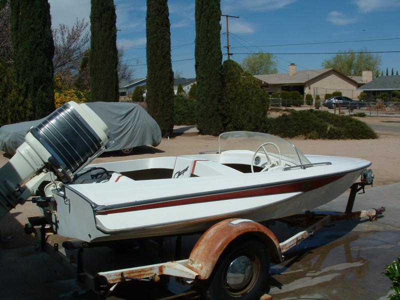

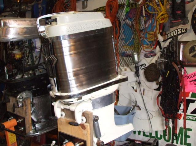

Is that a 700 FGS shorty?
Did you pull all those rivits by hand or do you have a pneumatic puller? I use a lot of them on the race car, and my hands feel it for a week afterward! You must of had a little helper for washering the ones under the deck? Glad to see you still plugging along in this cold. My unheated mancave activity has dropped off dramaticly as of late!
