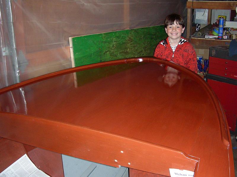

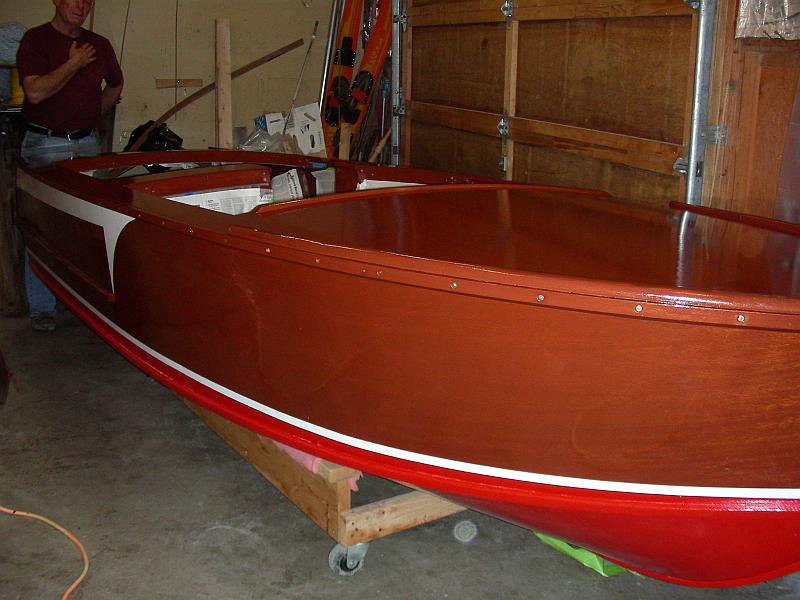

As most of you know, my Dad, son, and I have been working on our first full restoration of a wooden boat. It is a 1957 Tollycraft Rumpas. At only 14 feet long and powered by a 1962(?) Merc 400, it should be a rocket. Just a quick recap to bring everyone up date. When we got the boat, it had been COVERED in blue paint. My Dad spent months working in the evenings stripping and sanding to get it back to bare wood. The Tollys all had a fiberglass over plywood bottom which was in really good shape (also painted blue). After the bottom was sanded and faired, we applied four coats of primer and three coats of bottom paint. Then we flipped the boat back over to replace the decks. The original plywood had been sanded through in several spots, so the whole deck needed to come off. We also needed to get some scrap pieces of wood to try our hand with stain and varnish. In the mean time, the interior seats were completed in the warmth of my parents living room (sorry Mom!) since they are attached with screws that go under the new deck. The seats were finished and installed last week. Today, we got the new decks installed with 5200 and pin nails. Feeling more confident in the stain and varnish department, we are looking forward to some more update photos really soon! That is if I can get all this 5200 off my hands, tools, pants, and I think even my hair!
Seats installed and ready for the decks. We also stained the interior of the boat and bilge coated the bottom prior to installing. There are floor board (currently blue) that go over the stringers to cover the rest of the bilge.
Decks on and ready for some sanding, stain, and varnish.
