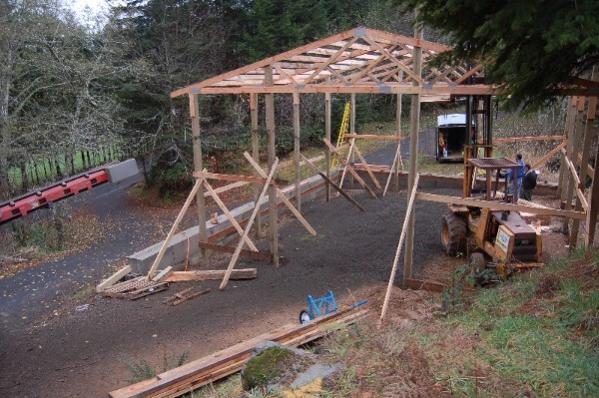

        I just put in a new shop this fall. 32 x 40. 14 ft walls. My contractor specialize in pole building. Big difference is a plywood roof with 2 ft overhang. This gives some insulation eliminates roof condinsation.

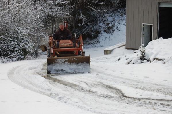

        Get as big as you can get or afford. I needed a retaining wall to get mine level and 105 yds of gravel. The pics are of the construction, my neighbor cleaning the driveway with my tractor, and my old storage.
        It was filled in two days and there is no room for my rv trailer. I need to sell my 19' wood boat with duck blind an decoys.

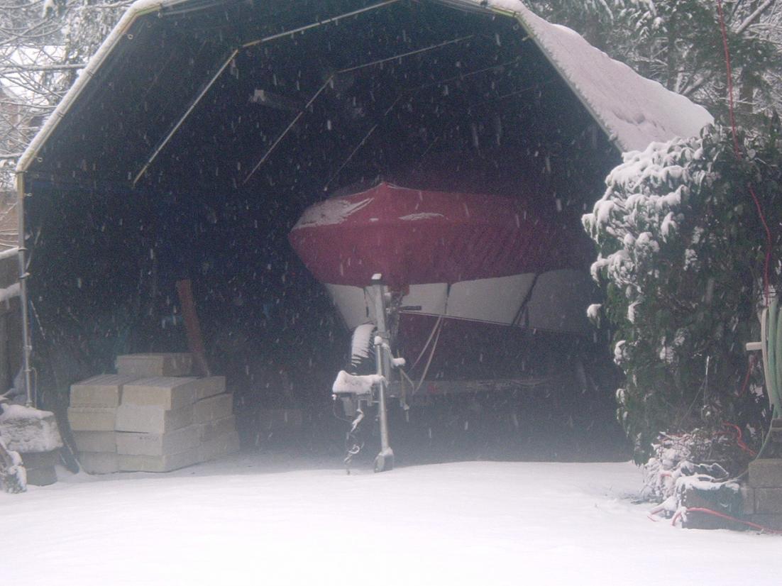

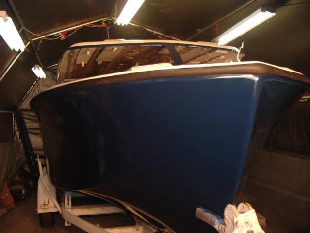

          Karl, I know what you are asking about as far as a pole building, but if you want to just upgrade from the Costco shelters style ,i have one that is 40' Long 10 high ( i did have one that was 12' high back in 1998 ) at the center. The Dorsett 21' Farallon is in there along with the Skagit 17'. I do have two ends caps as well. As far as snow goes i had about 2' on it before i went out out and knocked it off with a shop broom from the inside. It has shop light inside as well and by the way the Tarp goes to the ground. You can keep adding sections on as your needs change ...like more boats.Mine started out at 20' feet. The pipe is 1 5/8. Total cost with the lights and shelter about $1500.00 as time went on as far as adding sections. Best, Chuck
