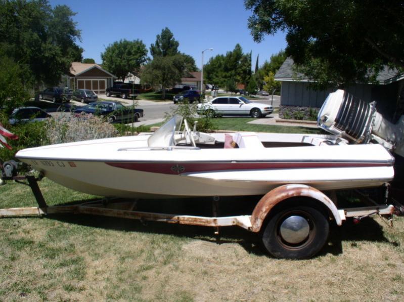

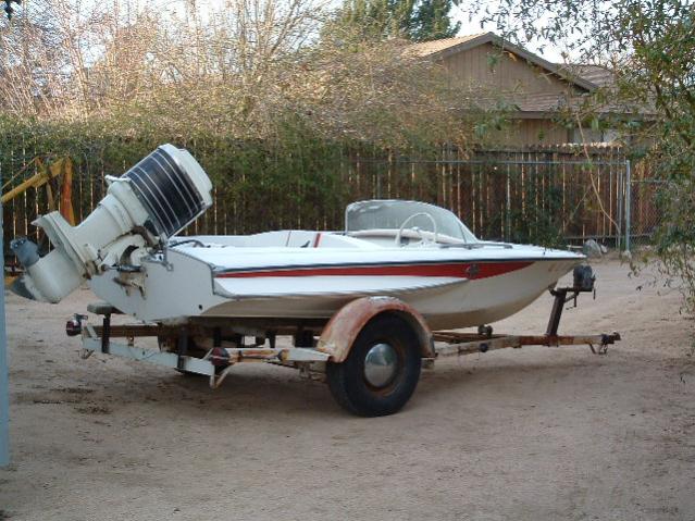

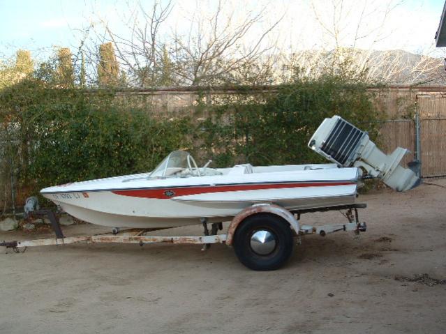

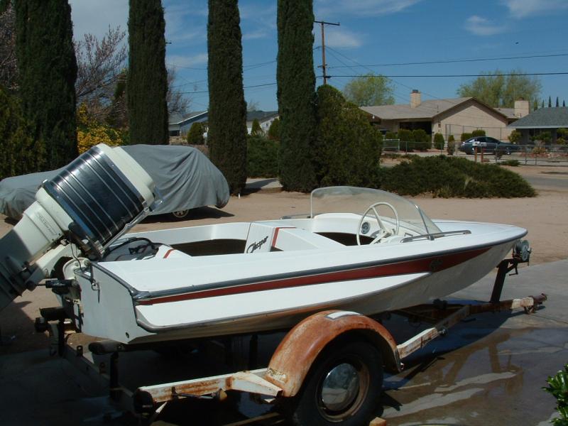

59 through 63 were center decks. 61's have a built in foot rest. They wernt built in 64 but 65 66 67 maby 68 were redesigned with a new top deck. The bow and stern are a bit diffrent and more interior space. Also 65 -67 maby 68 came with glass stringers which is a big deal today because no stringer replacement required with restoration. larson bought them out in 68 or 69 if im not mistaken.. I have a 61 that is in great shape that I want to do a full wood replacement this summer. It hasnt been on the water since 1980. I paid next to nothing for it in 06. It is my dream boat and the only one I need. I bought it for the style and the classic lines before I even knew it was a desired boat, I hadent heard of glasspar untill after I owned it, thats how I got sucked into this life I live in today called "boat world" Mike
ps the last pic is the pic the seller used in his ad that I lusted over untill I bought the thing>>>Mike<<<
Mike stole the color scheme I had in my head.
I have some Red 2 part to go on mt Black/White 1959 ,once my bow nose is back in order.
Dig in Mike,there isn`t much there it is so short and narrow.
Top shell off will make it a breeze then a 100 Xlong Alum rivets will get it back together.
