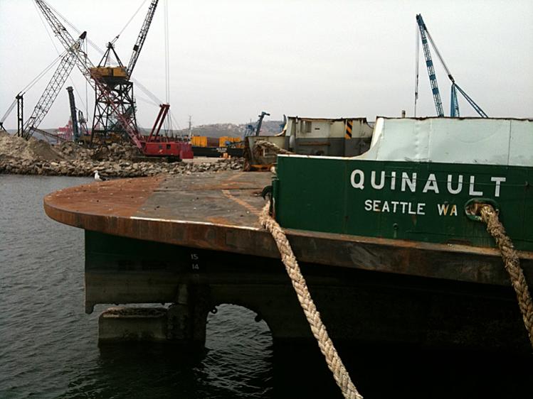

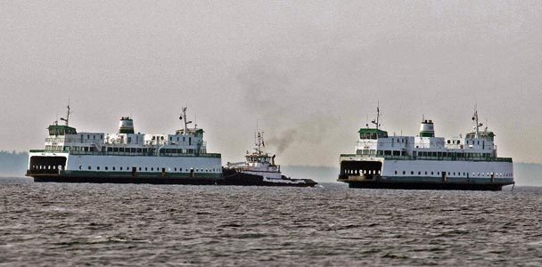

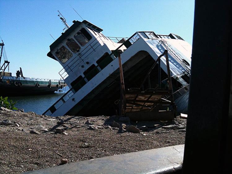

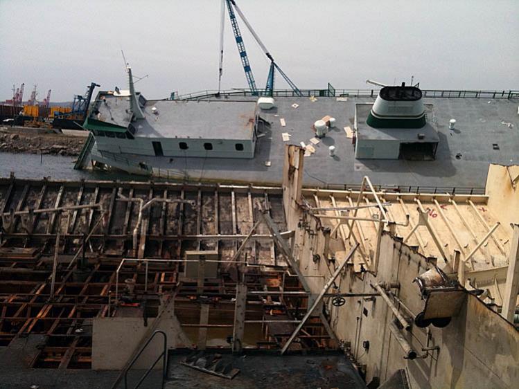

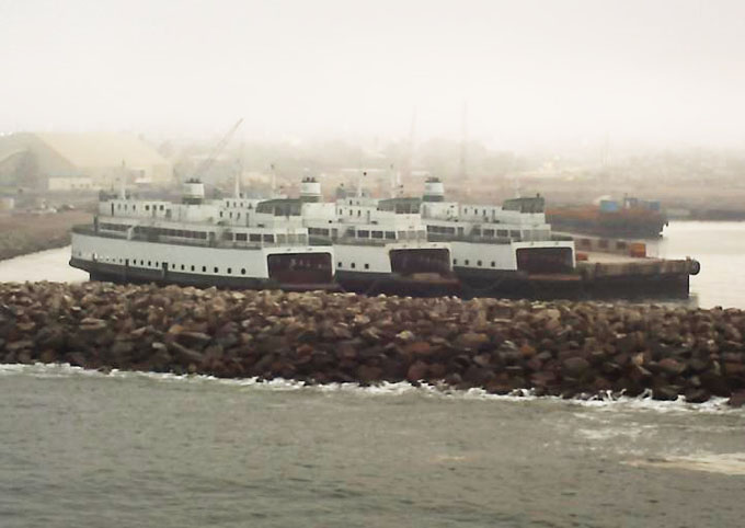

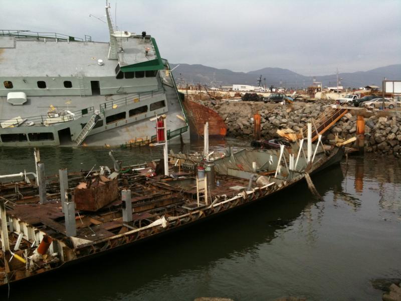

    Here's some pictures of the 4 Steel Electric Class Ferries being cut up in Mexico. Chuck

        Chuck, I see the quinault. What others are there? Hopefully I wont recognize the names. John
          John, The Klickitat and Quinault were on the Port Townsend-Keyport run. The Quinault was on the Vashon island route for 30 something years before the PT route in the summer only. The Illahee ( that the one that had sunk ) was on the San Juan inter island route for about the last 10 years and before that it was the Nisqually. The Klick was on the San Juan from about 1947-1981 before she was rebuilt in 1981.These four ferries serve just about every route in the Black Ball/WSF system since coming up from San Francisco with two other Steel Electric Willapa and Enetai and that where on the Bremerton route for all of the years they where here 1940-1968 ) then retired and went back to SFO in 1968. That's another story in itself. Chuck

                  These hulls are like Swiss cheese,the steel has become a shale -like substance that leeches rust out from every seam or repair.
                  Green and White paint can only hide it for so long....
                  The bottom probably can`t be saved and guarenteed to not leak or dribble at some point.
                  They sandblast and do Ultra sound testing while in Drydock and you`d be scared to ride on one if you saw the daylight thru holes as they find them.
                  Once you build a complex hull with holes and voids you can`t easily get to,it`s pretty much over wehn the hull reaches a certain point.
                  My first Alum SAFE hull actually was scrapped after needing many repairs to the well salted skin.
                  The Metal hulls,both Alum and Steel, try to trade places with the Seawater which contains even more minerals,Elements and stuff we don`t realize.
                  A repair needs to cover 3 times the area in question....once they all overlap,now what do you do?
                  The welds start to splatter and make popcorn.

                      Since this is what I do for a living I think I can answer some of this based on experience. Besides the the rust and the hull becoming thin there is another factor that is a big part of this. The hulls are constantly flexing, the steel then becomes brittle with age and cracks, spider web cracks. We all know if you bend a piece of steel back and forth enough it eventually will break in two. When you try and weld cracks in the hulls, you might seal that crack but from the heat the surrounding steel then develops cracks. It's not limited to the hull skin, every frame and stringer is also flexing and becoming brittle with age. They have a life span and eventually they become unsafe and must be replaced. You can rebuild, repower, replace parts and pieces in the course of the lifespan but there becomes a limit and judging by the age of these and my experience I'd say they were long overdue for replacement.
