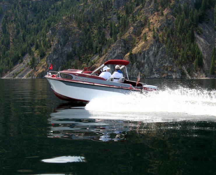

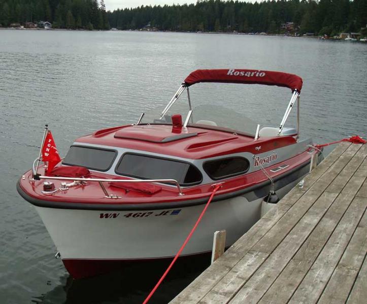

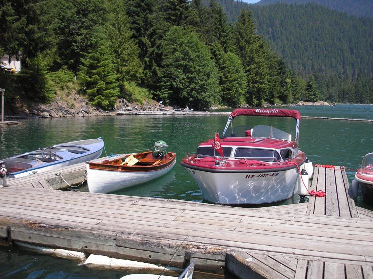

                  Rick, Nice pictures ! I have always felt Rosario was a good looking boat along with the Davis Craft.
