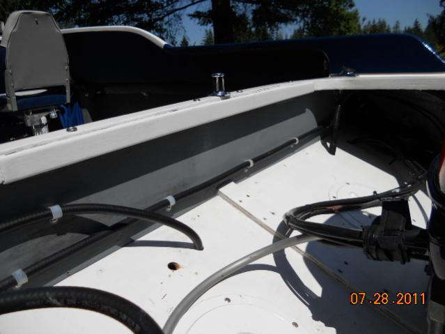

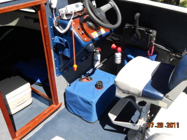

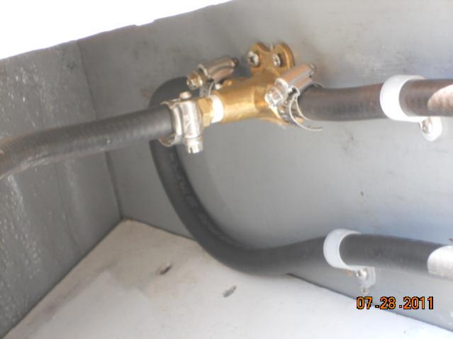

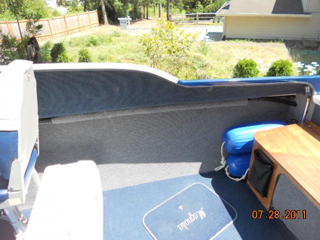

Rug that is....Just installed my 12 gal backup tank forward from the stern at the bench seat. After i decided it already has the battery and the main gas tank in the stern weight wise ,i went an got 18' 5/16 gas line ( works great ) and put it up front of the bulkhead strap down under the cover where i had tanks on a few other boats which made them ride better. Most of the time this tank will only be carrying 6-8 gal unless it's for a long run like South Sound or San Juan Island then put 12 gals into it to hold a total of 40 gals as the main tank hold 28 gal. On a few of the other boats i have had, i have put a 3" PVC pipe ( so the cables will not hang down ) with the controls , etc inside and then cover it with rug. This time it would have been to hard to go back ( that's the way i got it ) and start over so i wrap the rug around the controls ,etc and then overlap the rug to rug and glued it with 3M super 90 spray.Chuck
