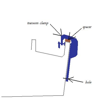

Hello guys, I've got a concern about the outboard on my boat. To keep the prop at the right placement, I have to use a 1 1/4" spacer on the top edge of my transom. That puts my transom clamps very close to the top of my transom. The motor (homelite 55) has bolt mounting holes in the lower part of the transom clamps. I really don't like the idea of putting holes in the tranasom. What to do?????
bolting outboard to transom??

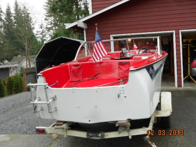

Put 3M 5200 Polyurethane Adhesive /Sealant ( ideal for underwater thru hull fittings) around the bolt hole and inside of the transom as well to keep any water from coming in. I have always put four bolts thru the transom. Look at the picture and you will see the holes in the transom. ChuckAttached Files1957 17' Skagit Express Cruiser
