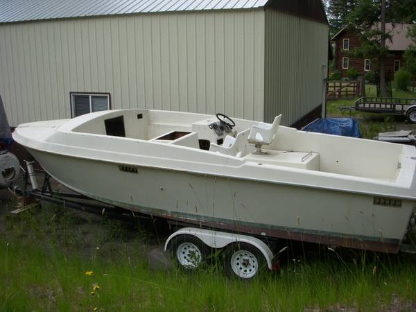

Just wondering if anyone had much info on the Lancers. I have found a 1968 19' Lancer with a 327 and 280 volvo outdrive. She needs the engine rebuilt but has good lines.

Well after a bit of decoding on the block it turns out I have something a bit more than I thought. It decoded as a 1966 L79 325hp 327 from a Chevelle. Ill probably tear it down and make sure the bores are good before it goes in the boat, make sure it's solid and see if the heads have hardened seats, new valve seals, etc. I'll have to see what cam is in it, don't want anything too radical. I can tell it's been gone through in the last 5-10 years but who knows how well it was done.
The hull is the exact same hull as the XK 19's so I figure she can take a bit more HP as this was a race boat hull designed by Jim Wynne. I'm hoping for a good 50-55 mph out of her but we will see.
