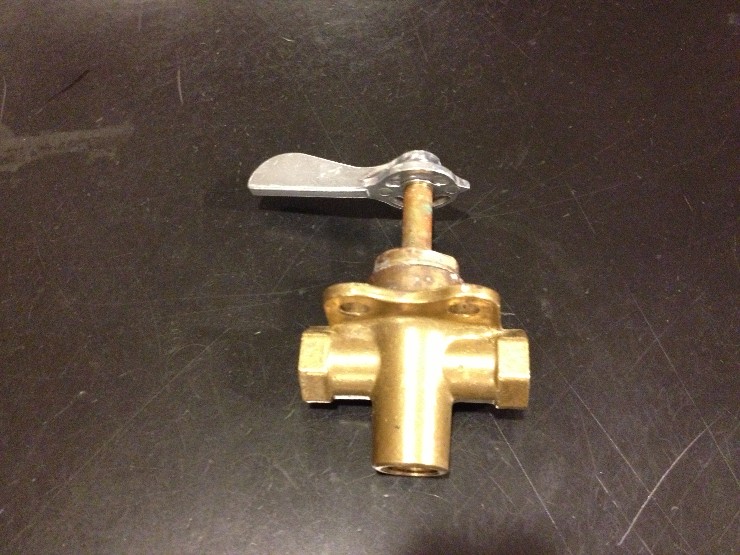

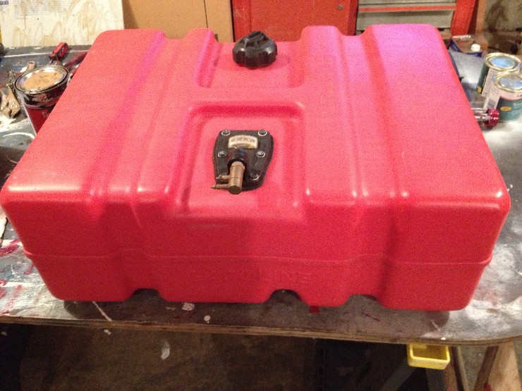

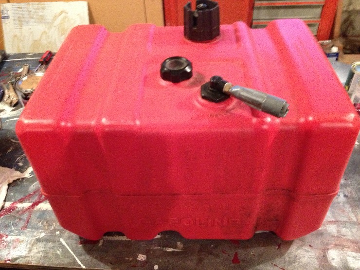

Kelly, I would put two above floor 12 gal ( tall or low ) Tempo "Style" 12 gal tanks with a 3 way fuel ( see picture ) switch with straps. There are all kind of combo's you could do, like one 12 low style under the back bench seat if you have one and throw a 6 gal one in as well ? I like the fuel switch as i don't like to run all of the gas out of the carbs on the high sea's and standing back there trying to switch a fuel hose over to the other tank and restarting the motor.Plus it is not a good feeling like needing gas when you are sitting out on the Sound with nothing ! Some might say they would rather stop at a Marina which is fine , but i don't like to pay their prices and some others might say they don't want to carry extra weight with them. In my Bainbridge Skagit it had two 12's up forward and 28 gal tank that lasted me the whole season with Sta-Bil additive in the tanks so i would buy gas in the winter when the prices where somewhat low. If you want to go with one 12 gal and would like to take a extra one on a long cruise, put in a three way switch ( that would hook up two tanks and the off position for both tanks ) for the 12 gal tank and just have a extra fuel hose hooked up to the fuel switch for when you would maybe a extra 6 gal ? In the Skagit i have now it has two custom made 2 year ago saddle 21 gal each at $400.00 ea and are very nice! The old fiberglass tanks had all of the sentiment crap from the old fiberglass tanks breaking down from the modern gases of today swimming around in them which is hard on the motor !The new one's were in it when i got the boat otherwise i would have gone with two 12' as you can pick up some up for around $50.00 ea. New they are up to to about $120.00 + ea ! I myself will still put in a 4 way fuel switch so i can have two tanks and have another gas line for a kicker motor or whatever.I almost ran out of gas back in 1995 in a perfect storm and told myself i would never be low on gas again ! I had only two 6 gals ones. There is a place in Bellingham ( Pacific Marine Exchange 360-738-8535 ) that might have some used one's. This is just my thinking. I'am sure that some of the other guys will have some idea's as well.Chuck1957 17' Skagit Express Cruiser

Even if you did not put in a 3 way fuel switch with your 2 - 6 gals tanks , with one 12 you don't have to switch the hose and fill it only once.1957 17' Skagit Express Cruiser
I don't have room for a 12 under my splashwell...the tub is too deep. The tank can be no taller than 8" max, if you guys know of a 12 gal tank that is long and skinny I'll take a look. Ideally I'd like the tank to be under the splashwell or maybe I'll fab a box under each seat to hold the two 6 gallon tanks...hmm, squirrels are turning in my head.

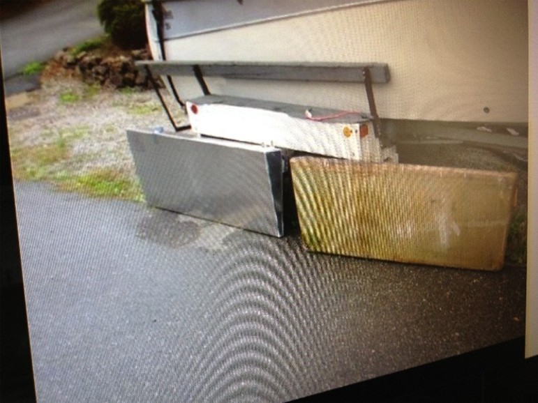

I bought a used 18 gallon aluminum fuel tank a few weeks ago but it didn't fit mostly because of the bar in the middle of the transom to the floor. Bummer too because it was a costly error on my part.
