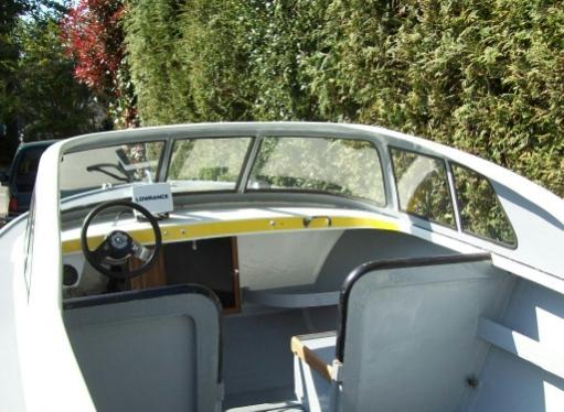

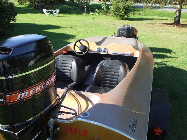

Barry,
I wasn`t born when most of this was evolving but the steering torque issue was my first thought as to why.
The Navigation aspect makes more sense.
I kept the left hand locale for the Tyee of Ken Cook and had to get a U-flex system so it could have the cable move the opposite direction at the motor as I used the shortest route to the motor.This meant the transom drag link is mounted reverse but we saved 6` feet in cable length.18` versus 24` made a big difference in price ,plus it should work better with less resistance.
Hopefully the new Yamaha won`t twist it too bad,a 4 blade prop may make it worse so we won`t go there.........
My big Yamaha 115 2 stroke (loaded with 4 blade SS wheel)would push my left hand gunnel way down if throttled up and trimmed in too far.
Trimmed motors should allow for less torque when dialed in right,the older motors didn`t see that option for a few more years.
TimMAttached Filesunk.year 10` Mahogeny "DragonFly"racer

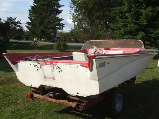

I've got 2 boats with port steering. 67 Carlson Contender and 60 powercat. The torque is really noticeable on the Carlson. I have to scootch to the middle when I'm solo! The cat is less but still there. I'm wondering if left turn only circle racing had anything to do with it? I'd also heard that when they did away with the Merc dockbusters (lefthand rotation) they went to starboard helms. More questions than answers!

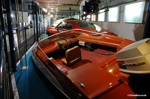

Hi Sparrow Hawk,here you go right in the center like on this james bond boat.Attached Files
