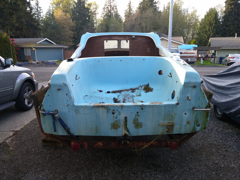

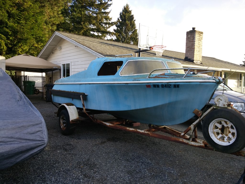

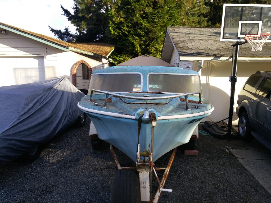

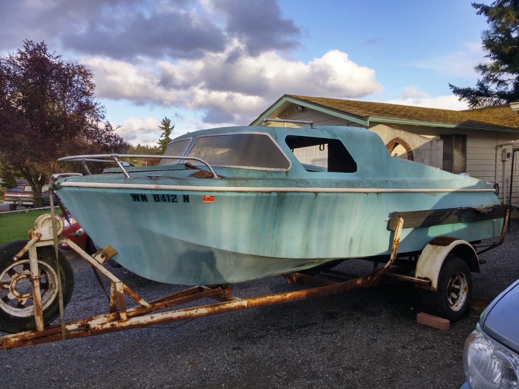

    My neighbors son came over and asked if I wanted an older boat for free that is the same color as my Lee-Craft. How could I resist, lets see a photo. They are looking for the title now Am I sick? I will drag it home this weekend possibly.

    I like them. Very cool sleek design.

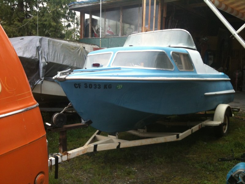

        One of my Keeper boats is just what you have there. I got it from Chuck Carey who bought it down in California were it was built and designed..
        If you look at the hull, you will see that the lowest portion of the keel is just under the cabin window.
        This boat was designed in the San Francisco Bay area by the same fellow that designed the Studebaker Avonti?
        It was designed for the Chop water in the Bay area and one of the smoothest riding boat built in my opinion. The only other boat that I can think of is the Glasspar Seafair Sedan like Steve Kiesel owns
        My Dorsett Catalina will be one of the last boats I restore and possibly the last keeper due to the ride.
        I have Skagits, a Bell Boy and the Uniflite and they all are like a barn door with a motor on them up at high speeds.
        The Dorsett Catalina trimmed up right to help keep that bow in the water will out preform almost all PNW built boats from the early 50's

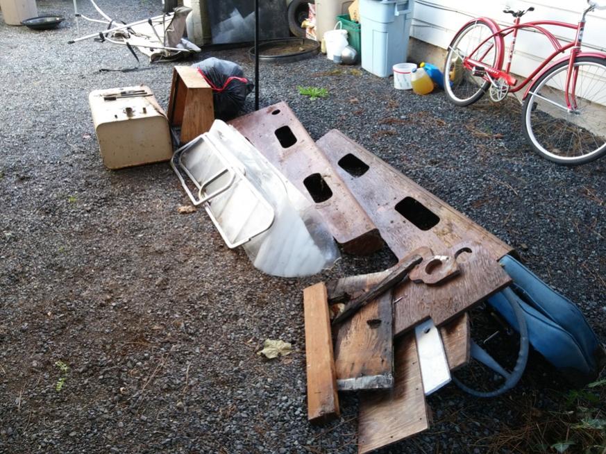

              I am thinking that the Lee-Craft will get bumped down a project but not forgotten.. I have to figure out stringers and bulkheads for it and a few other custom designs. The Dorsett comes with a lot of stuff I can use for patterns which will help my learning curve immensely! The fiberglass over all seems to be in good shape with a few areas that will require some attention. The stringers have been exposed and left to sit in standing water, but I think I can get them out in one piece for patterns. Transom at first glans seems to be solid but a more thorough investigation is coming as soon as get the boat cleaned out.

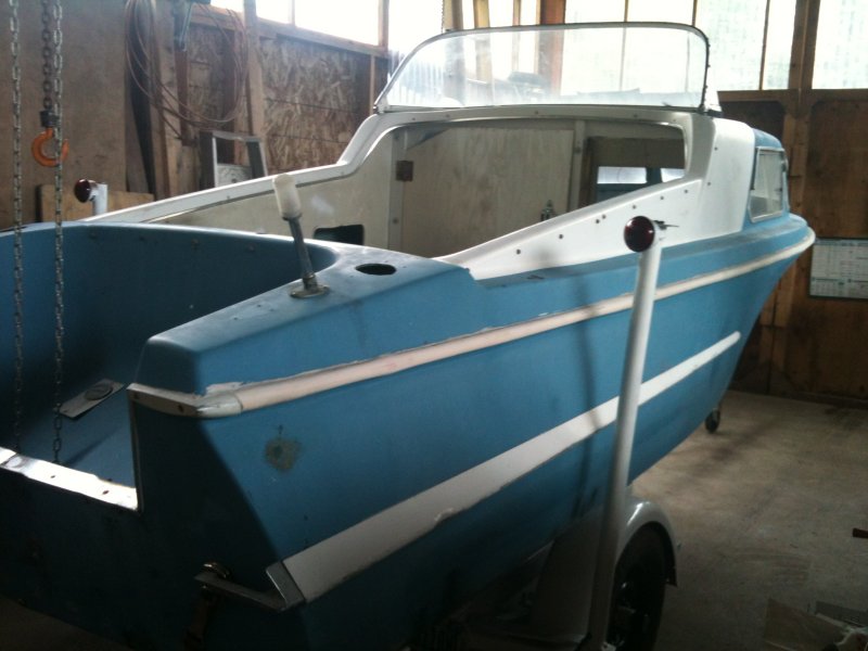

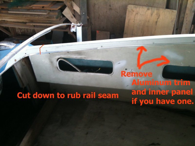

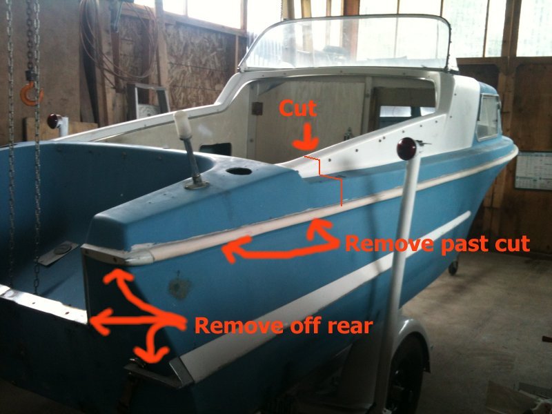

              I can walk you through every step of that project, With pictures.
              I can send you pictures of the type of tools you will need such as a cheap laser (20 bucks) that you can use to measure from.
              IF, the transom needs replaced and its a short shaft transom, might think about raising it for a standard motor. Mine is for a short shaft which will not do for me.
              I am not pulling the whole cabin top off so this is how I did one before. The trick is you need to be able to See and Access ever cut from the inside to glass her back. Once I got done with the one I did, you couldn't tell I did the cuts.

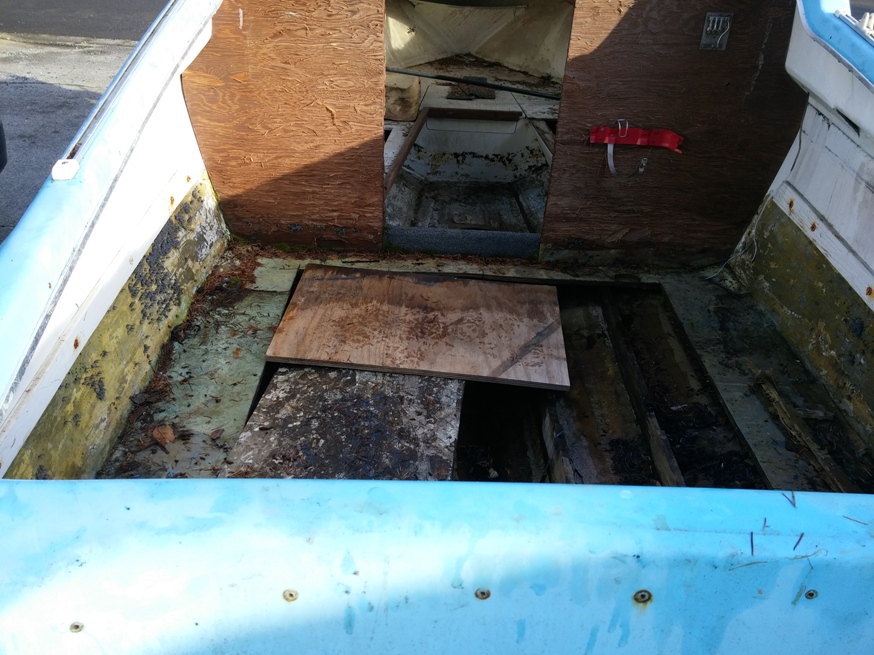

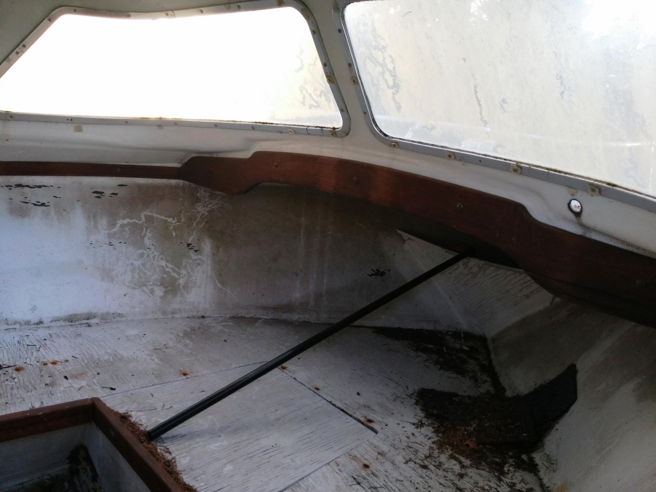

                I don't want to remove the top on this one too. Transom has some dead spots around a few holes as expected and a small dead spot about 2 inches in diameter. As a precaution...(see photo) I set this off in the cabin.

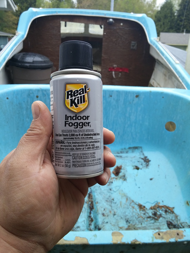

                  I need a couple of those for my boat and my shed!! Even though we use our boat several times a year I am always fighting spider infestation under the bow... ��. There is nothing as terrifying as having a big, fat, black spider with red triangle on its back fall on your bare leg while running across a lake at speed!!
