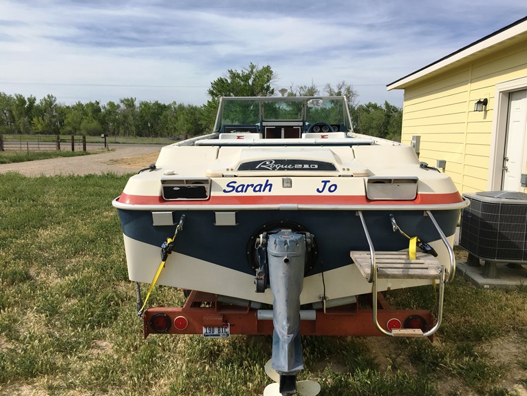

    Well Sarah Jo is finally done. All of the old wiring has been replaced with the NOS harnesses I found online.
    I registered it and the Evinrude trailer with Idaho DMV this morning, then went to Harbor Freight and bought a heat gun, plastic scrapers and Goof Off.
    One final stop at Idaho Watersports to get the new hull numbers and the name cut and then I went home. The hull got a good cleaning with Attwood Hull Cleaner, and then I attached the new Evinrude emblems I got from Andrew Gleason, the hull numbers and the name.
    One of these days I'll take the time to use rubbing compound and a good polish and wax.
    BTW, Brooke, the kids and I will be at the ACBS Payette Lakes boat show in McCall next month. We registered this morning and reserved our room. I don't know that our boat is in the same league as those wooden beauties, so we might bring it, but we won't be showing it.
    I'd like to add pics, but it appears that the mobile app doesn't allow it.

    Okay, on my desktop now. I'm looking out the window and the cloud ceiling is pretty low. The weather forecast gave a 20% chance of rain and 90° today; hopefully it doesn't rain and we can enjoy the day.
    Here are the pics.

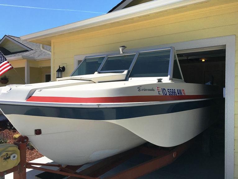

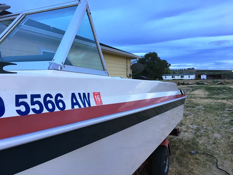

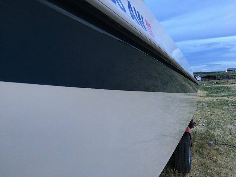

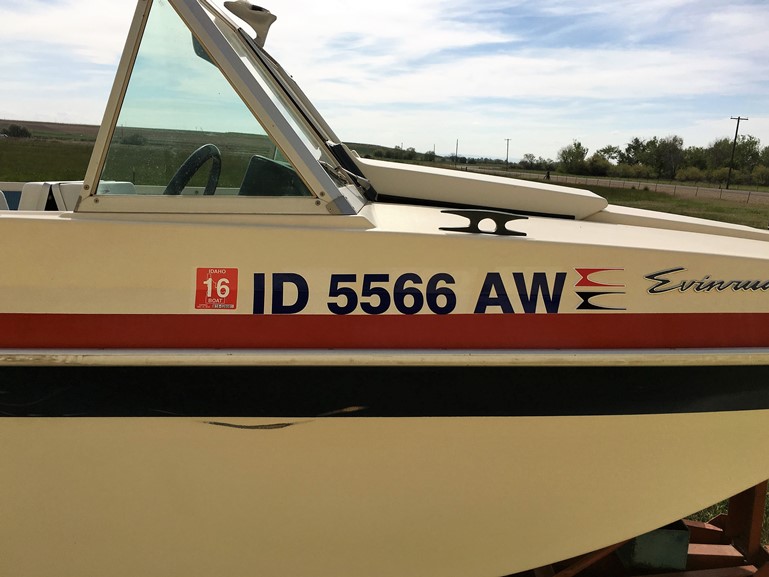

                  Here are pics of Sarah Jo, after I sanded the port side. I'm extremely happy with the results...even the outdrive turned out pretty well. My favorite pics are img0252 and img0253, because you can clearly see the reflection of the landscape in the fiberglass.
                  I have been swamped with appointments this week, so tomorrow is set aside for the starboard side wet sanding, polishing and waxing.
                  I also took the time to rebuild the Quadrajet, because it was spewing black smoke on startup....turns out the little schmuck from whom I got the boat attempted to rebuild it but didn't know what the hell he was doing; he bent both primary metering rods into a "U" shape, because he didn't take the time to properly seat them into the jets. I carefully bent them back slowly and rebuilt everything correctly....I also did the Carter YF on my Jeep CJ-5, while I was at it.

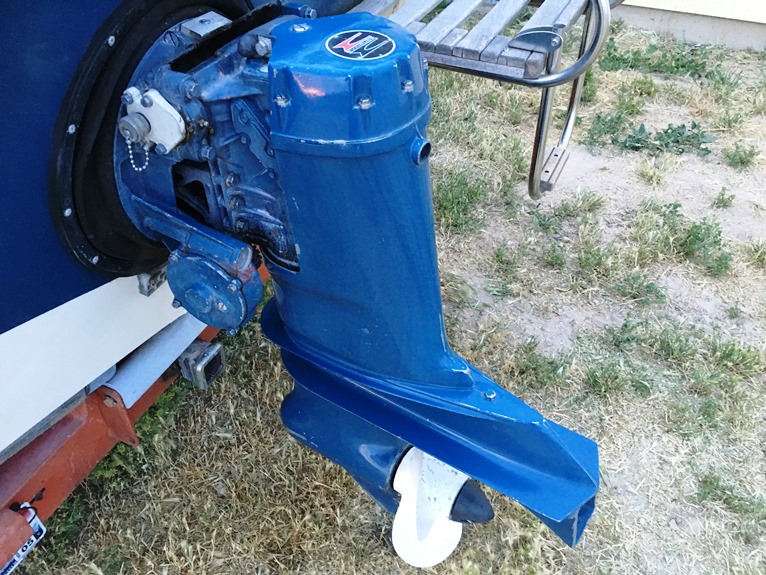

                        We took Sarah Jo out to Lucky Peak Lake on Saturday. She performed flawlessly...with five people on board and two coolers, I was able to get 34MPH @ 4300RPM, with a 14x16 prop.
                        When we got back to the marina, I was waiting for Brooke to get the truck and trailer, and my "Hot" light came on, so I immediately shut the engine off. Turns out the water pump finally gave up the ghost.
                        I ordered original OMC parts and will attempt this repair myself....as a certified rotary wing Airframe & Powerplant mechanic, how hard can it be, when you have the service manual, right?
