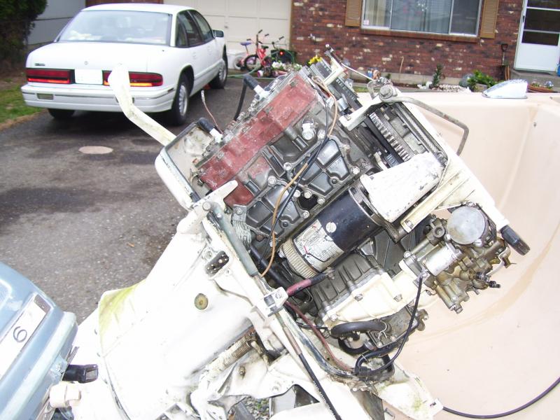

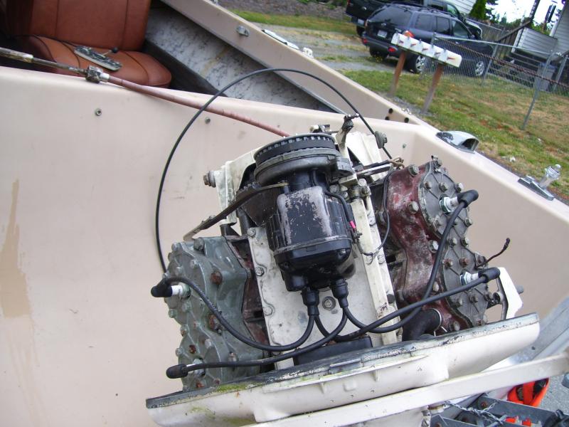

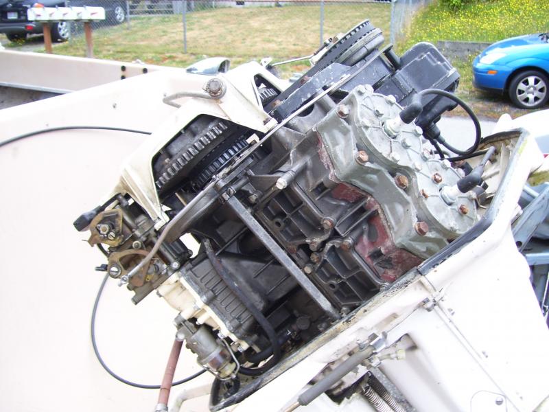

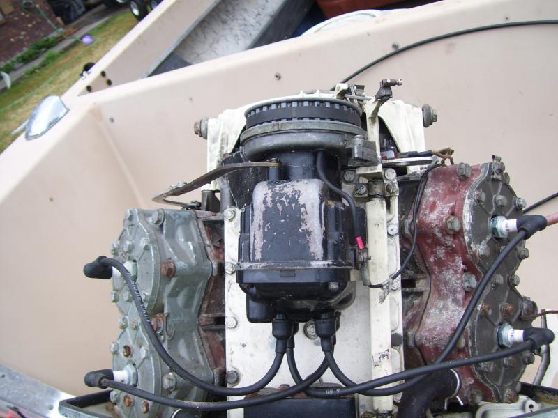

              Just thought I would let you know that I have a 1958 Johnson fat 50 that I just took off my Dorsett. I have the rectangular plug/harness that I was going to hang on to, but if you want to take the motor off my hands I will give you the harness also. Does yours have a magneto or is it battery ignition. This one is magneto and has no battery charging capabilities. I need to hang on to the switch box but you can either make your own or find one on ebay. Let me know if you have any intrest.
              Best of luck, Larry
              Larry Ellingson
                yeah man i'll take it how much you lookin for it?i believe mine is both not too sure just orderd a factory manuel to try and figure it out it's pull start and electric not sure if it has amagneto or not it does have wut looks like a generator that it part of the distributer if i'm callin it right.
                unknown year 10ft hydro
                  Just the cost of your gas to get from Evrett to Gig Harbor and back. Do you have a truck?
                  Larry Ellingson
                    i have a mini van i call it my mini truck lol. what day would be good for you i work graveyard mon -thur but off fri till mon how bout i make a trip out this weekend?
                      Can you give me a call? My number is listed in my profile.
                      Larry Ellingson

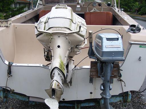

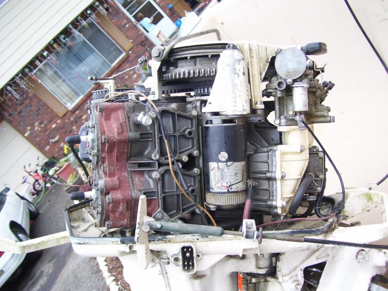

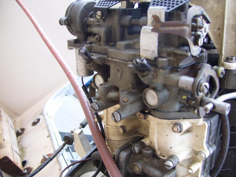

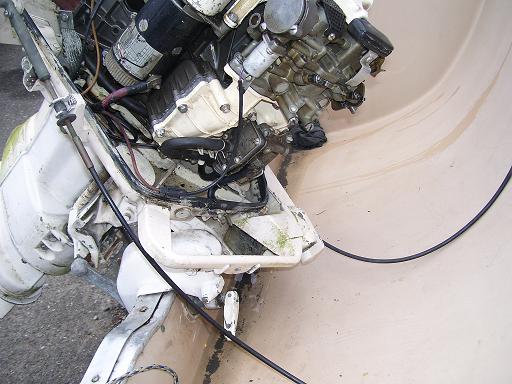

                        larry here is the pics of the motor

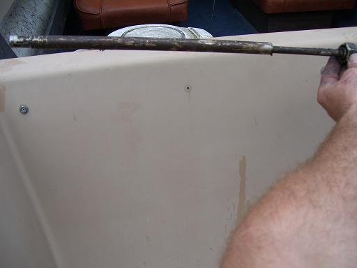

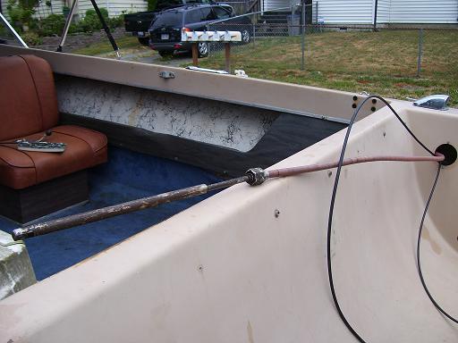

                          so i figured out the steering the setup behind the dash says mercury keikafer will that system work with my johnson if i fabricate a few pieces?
                            steering
                            Ain't nuthin' time and money can't cure. Seriously, the cable should thread onto the transom bracket tube that Bill R. sent you the link for. These pieces might also be available through West Marine or some of the larger marine dealers. I would try to find these pieces rather than fab them myself, it will save you a lot of grief. I will stop by the local shop over here for the motor piece, he is a friend of mine and might have the bracket laying around.
