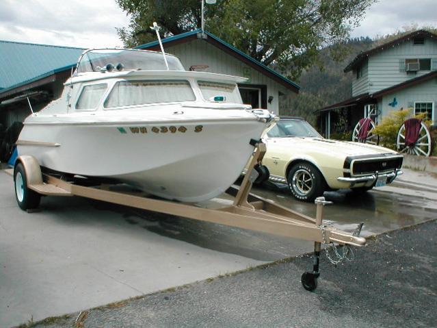

    There's one on my old Cat, wouldn't leave home without it!
      Cat scratch fever
      Nice ride(s) there Lon, thanks for the pic-the keelguard looks great, did you have any installation or adhesion issues beyond the obvious?
        No issues, mark the area to be covered, scotch pad lightly, apply activator, press on keel protector. It would have been nice if they had provided a little more activator, you get nervous when you see you have a couple feet left of protector and only a couple drops of activator..................

            Here's just one place to get an idea of what they are. These have ridges I went with the smooth look and I also didn't want it to "show" so I picked a color close to the color of hull........
