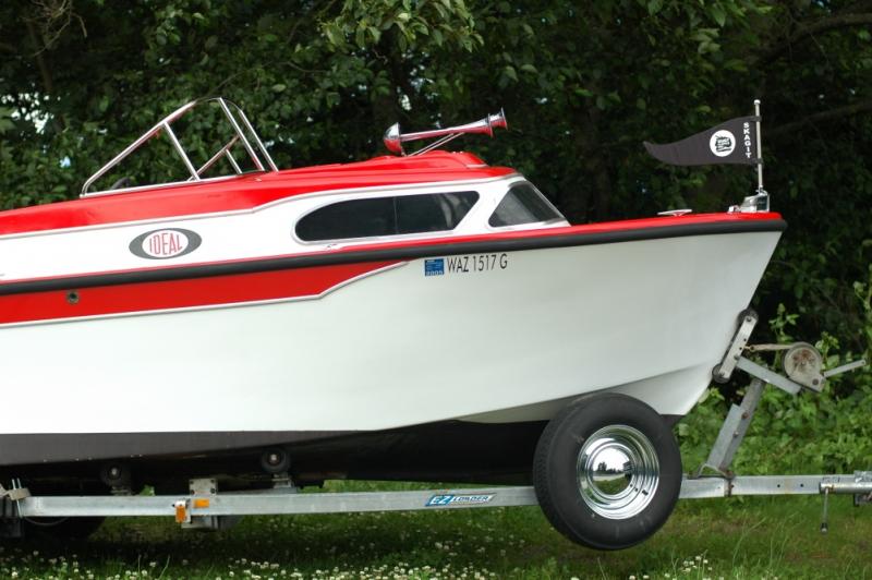

          Gunnel blobs will really help but lack of hull flair really makes it sink quicker as you see in this pic.Check out the boat with PFD....This is the best possble scenario for hull shape and placement of foam.Of cours it ain`t a real classic so inside she goes,and a little more care which trump all.
