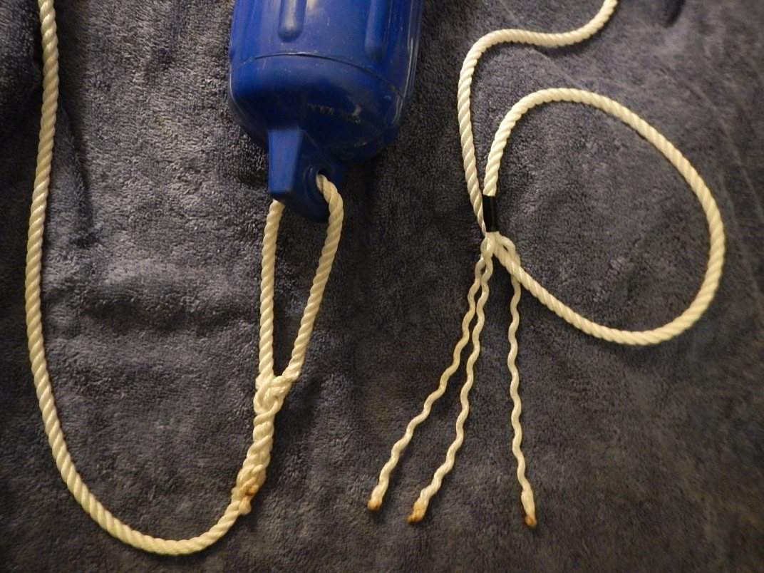

Here is an early example of one of my splices and while not pretty is more than adequate to hold onto the bumper. (Note splices tape on next one.) After taping I used butane lighter to melt rope ends. This by the way is what happens if you send two in the same path. It takes a little while to understand how to properly make the first three tucks.
