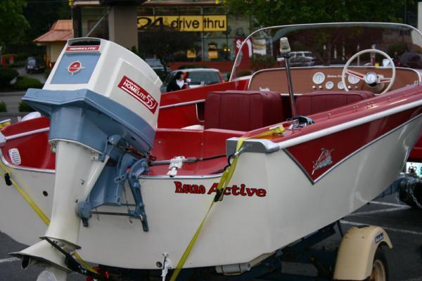

    When I did the cosmetic work on my Homelite I worked up CAD files for the graphics I needed and had Bend signs in Oregon do them for me. They did a great job and their prices are reasonable. (Please contact them for a quote, mine were done with a bunch of other stuff and I don't remember individual prices)
    They do a lot of work for folks restoring vintage stuff and understand the importance of getting it right. They have files ready to print for the following:
    1) Homelite 55 and Bearcat 55 hood side graphics for the "bumper sticker" hoods, available in plain and (the original) reflective.
    2) "Fifty-Five" graphic for the front of the hood

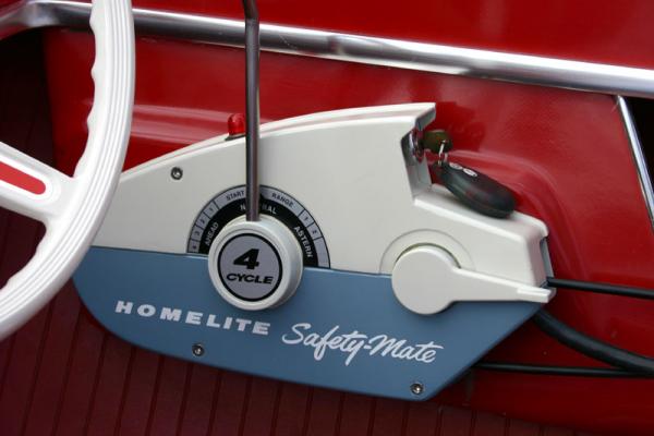

    3) "Homelite Safety-Mate" for the control
    4) The "Ahead & Astern" arc and "4 Cycle" graphics for the control
    These graphics were drawn line-by-line and are exact duplicates of the originals, not "pretty close fonts skewed in Photoshop".

      A couple of notes on the image Dick provided the link to:
      The Homelite Safety-Mate graphic is shown against a black background so it shows up, the actual graphic is white with no background.

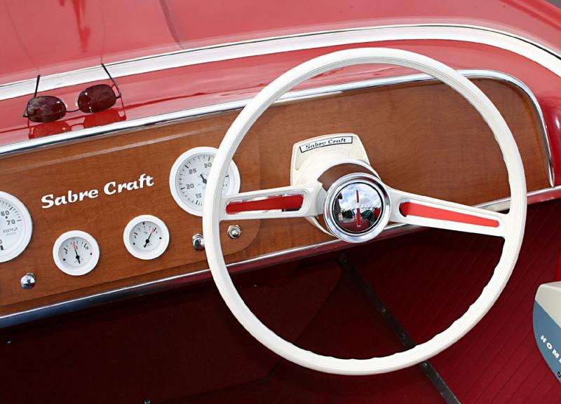

      The arched Sabrecraft graphic and the red/chrome spears fit a Mercury Ride-Guide wheel, lots of those wheels in use out there. If you have one you could have your boat make, name etc instead of "Sabrecraft" in the arc, or a different color in the wheel spears.
      Also, the hood side graphics are available with "Bearcat" instead of "Homelite", Mary has the files for those too. And if I remember correctly it was about another ten bucks to have the hood side graphics done on 3m reflective material, as the originals were.
      Tim
      Here's a few photos of how they look applied. After opening the photo of the wheel, click on it and it will open even larger so you can see more detail.

                      Hey Tim, how about the starting instructions for the control unit?
                      Also, could someone explain how the choke is supposed to work on the ignition switch. My control has an aftermarket automotive ignition switch; turn the key counter-clockwise for acc., turn the key clockwise to first position for acc./ignition, then continue to turn clockwise to start, and release back to acc./ignition.
                      I think the choke should be energized in the start position, is this wright?
                      • #12
                        No starting instructions
                        I didn't have them do the starting instructions, if you could find the right wording they should be able to make that up without any problem.
                        The Homelite choke control is a "push the key" type, you turn the key to the on position, push it in to activate the choke and turn it to start. If you identify the choke wire you can wire it to a momentary contact pushbutton switch.
